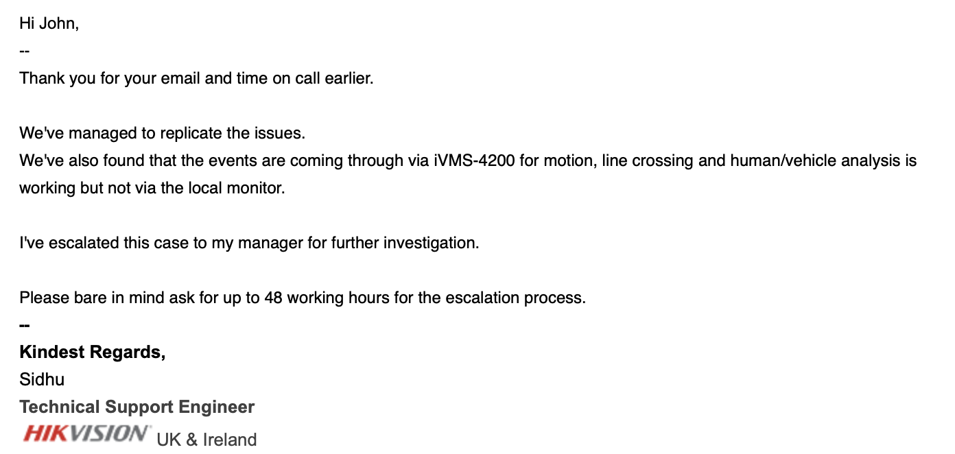

For the filtering on the HC app and Local monitor we have replicated this issue and passed the information to our HQ team.
However, the missing timeline, we weren't able to replicate in-house. However, we have passed this back to our HQ team to test also.
Many Thanks

Yes they're slow to resolve it. I reported the issues to UK support on Nov 22nd; UK Support confirmed the issues and said they'd pass to HQ on Nov 29th. We'll have to see whether version 5.04.050 that Kyle mentioned two days ago will resolve it; that is slated for release 'after Christmas'

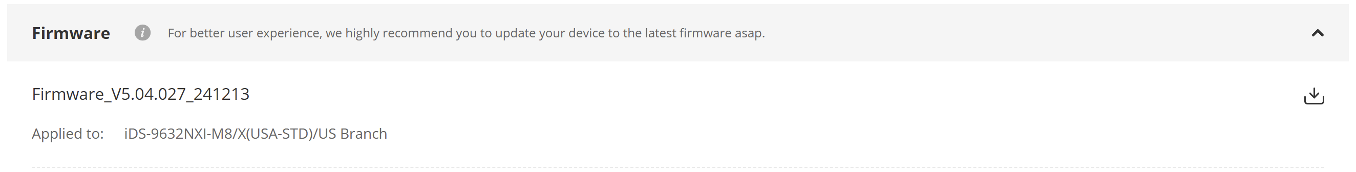

Hopefully soon after Christmas. Since it looks like the NXI version just got an update which I didn't see posted a few days ago.
iDS-9632NXI-M8/X

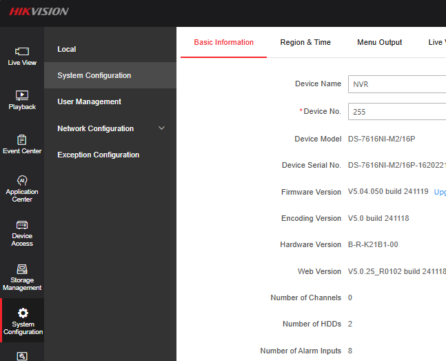

Well if you're brave enough @johnfitzy there's a version of 5.04.050_241119 designated as 'ARC' firmware here on the EU portal:
5.04.050_241119

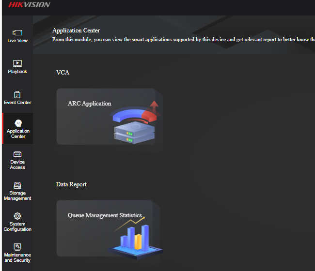

Is there a new thread on this FW? I see that it was released before Christmas and not after. The FW version number is the same that Kyle mentioned that should be released after Christmas. Is this the one Kyle was talking about or is it different because it's designated as ARC? What does ARC mean?

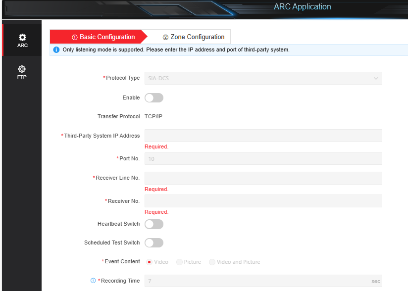

ARC in the UK is Alarm Receiving Centre (where a system is monitored by a control room). Unknown as to whether it'll be the same version. It's dated after the issues I reported to support but a little to soon to include fixes I'd have thought. It's not worth me trying it because I can't be bothered continually having to reprogram an initialised NVR if it doesn't work #tiresome

You figured wrong! My OCD got the best of me...
That ARC is the only difference I could find... although I didn't look too closely... mouse scroll direction on playback still reversed and still no timeline markers on playback far as I could tell... no harm done:
