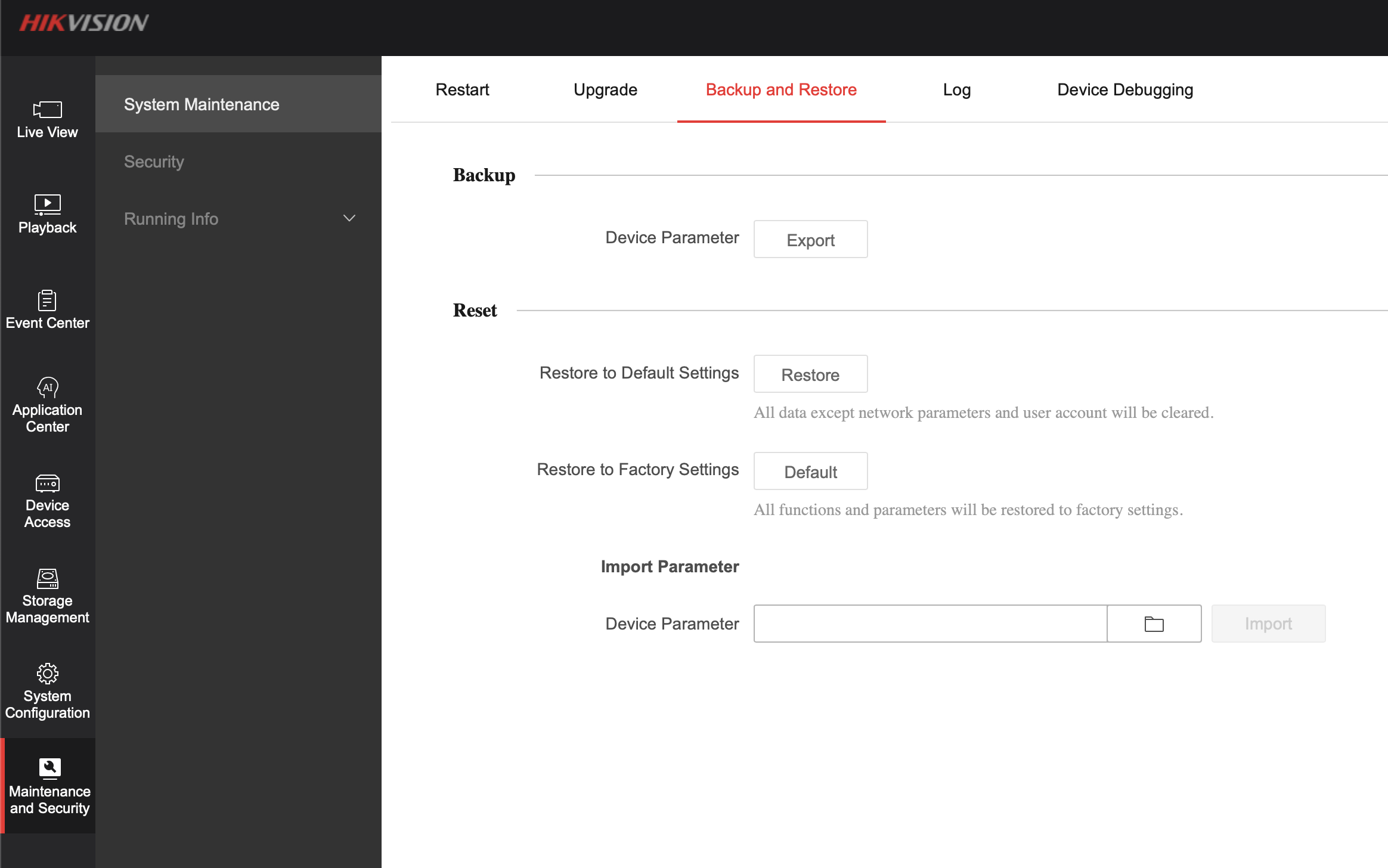

Since you are installing a new NVR I would factory default it after downgrading.

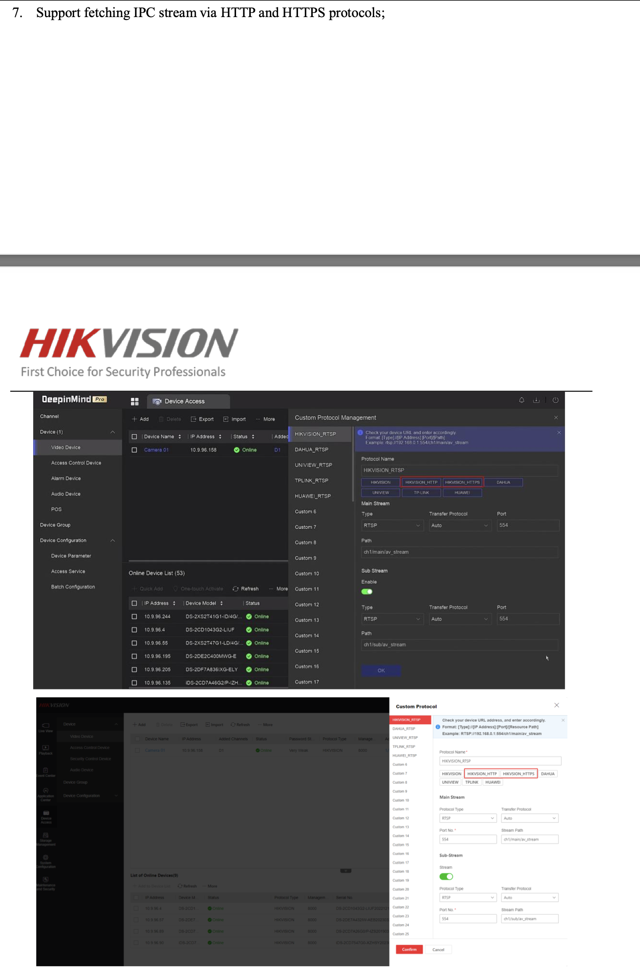

I wonder if feature 7 in the release notes have anything to do with human/vehicle markers not showing up in Hik-Connect playback for recordings after the FW update?

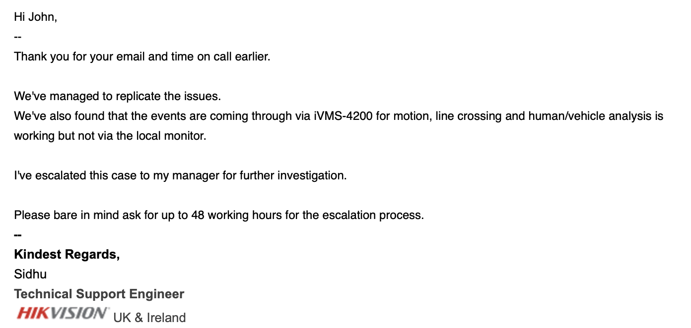

An update...
and another today....
Hi John
For the filtering on the HC app and Local monitor we have replicated this issue and passed the information to our HQ team.
However, the missing timeline, we weren't able to replicate in-house. However, we have passed this back to our HQ team to test also.
Many Thanks
