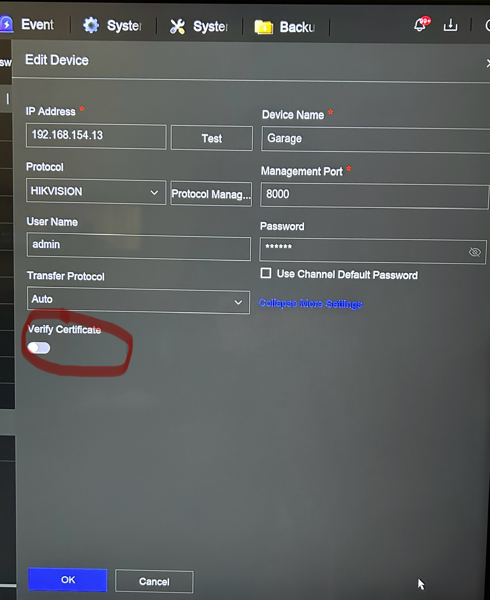

Under "Edit Device" on the NVR for the DB1C, I see there is a "Verify Certificate" button that is not checked?... tried checked/unchecked does not help... don't know if this was there in the V4.0 GUI.

Even though I had "Verify Certificate" unchecked...

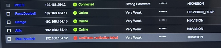

I have added the doorbells (hopefully temporarily) using the HIKVISION_RTSP protocol...
