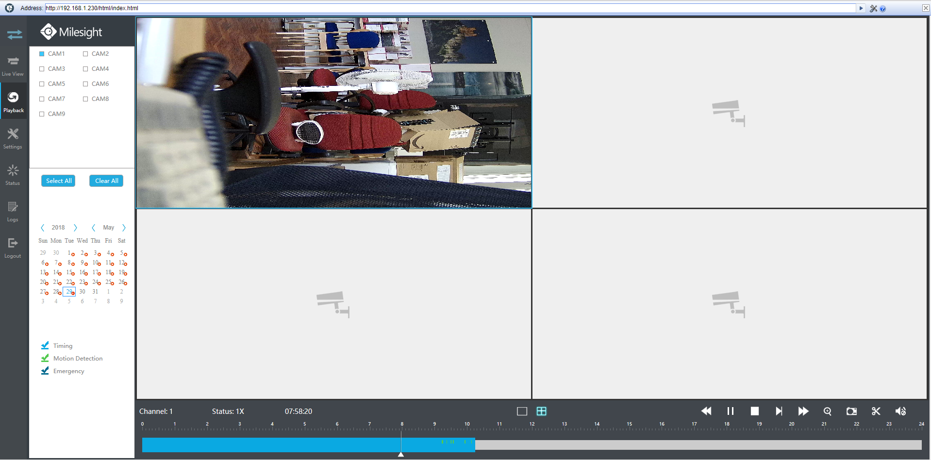

Sorry Nick, my bad, I responded to a few requests here yesterday on the bank holiday, and for some reason interpreted your model number as a HikVision consumer range product.
You should be able to access everything from Internet Explorer (not Edge), or you can use the IEtab extension to Google's Chrome browser if you prefer (I use this all the time).
