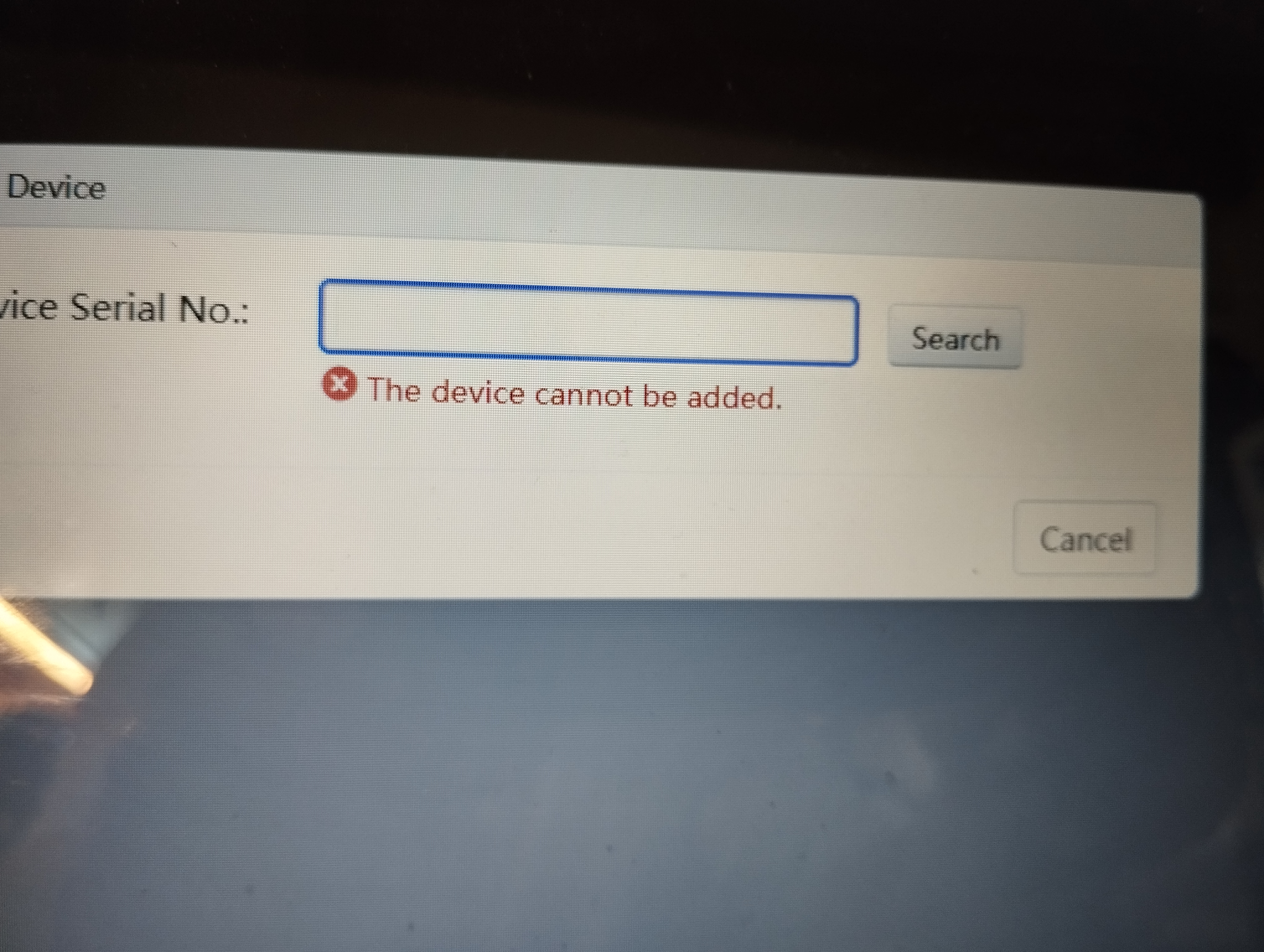

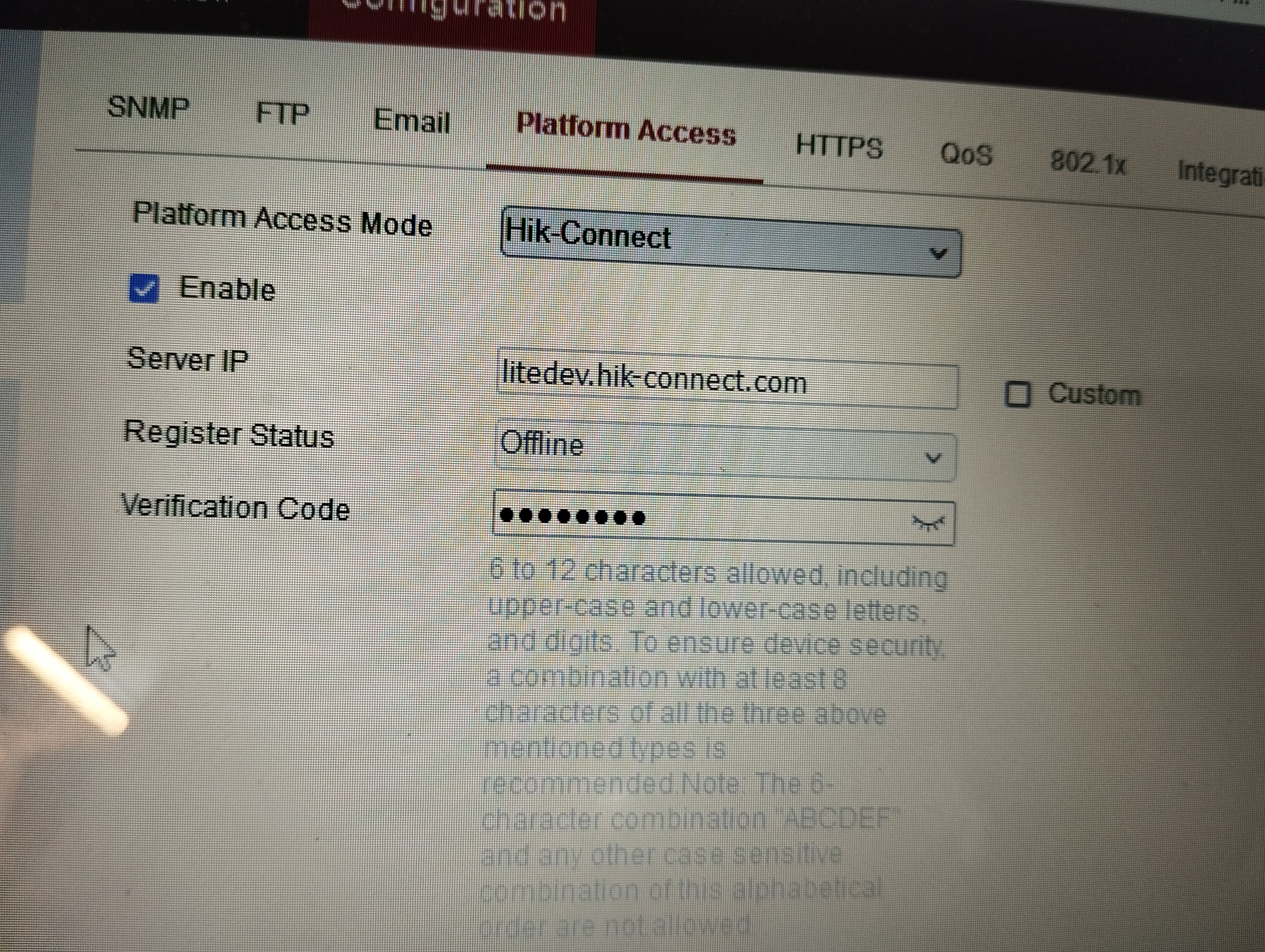

Replaced old camera with new camera working as standalone with SD card in, attempted to enable hikconnect via platform access, does not show online have also tried adding device to hikconnect.com, comes up with device cannot be added.

@Moley8
Go Network - Basic Settings - DNS Server and add a DNS. Usual is Google's 8.8.8.8 as Preferred and 8.8.4.4 as Alternate or you could add your Router's Gateway as Preferred(works for me and 192.168.1.1).
You might need to wait a few seconds to see your device as Online

woop woop, all sorted used the DNS settings as you suggested and all working great. What a simple solution which i would not have found without your help, thank you so much and very much appreciated. Gonna now put the old camera on rear of house. Thanks again.
