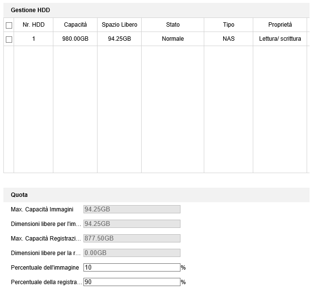

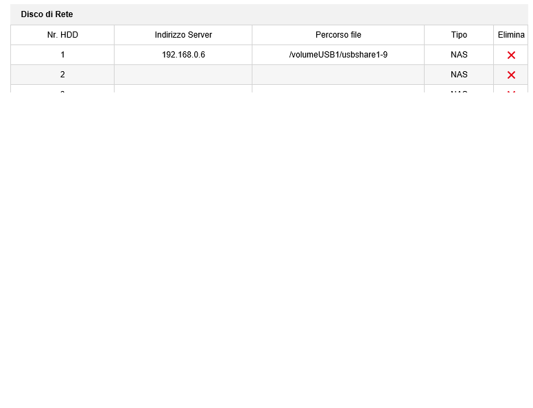

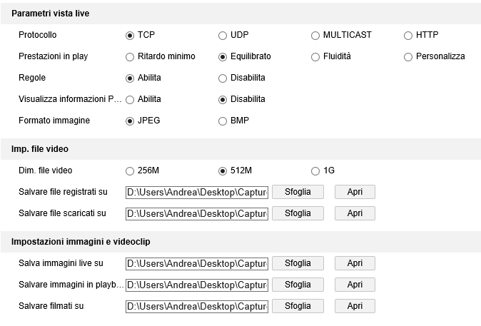

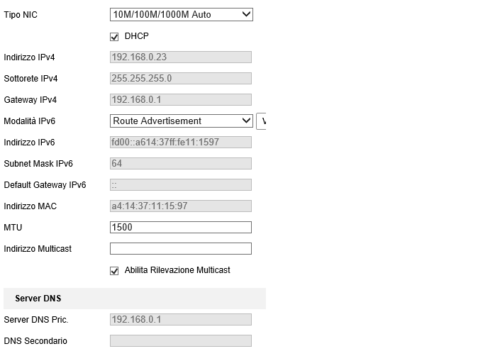

Let me add a few more details:
- Also the Captures and Clipping function do not work: that is: during playback I cannot capture any screenshot or any video recording footage
- In Live View mode, I cannot start any local recording or capture any screenshot
Attached some config.
What should I check?
Please, help me!!!

Are you saying that when you run Edge / IE as an administrator you cannot download to a folder / file within the C: Drive of the browsing PC?
Exactly.
Furthermore I can neither record locally from Live view, nor capture a screenshot.

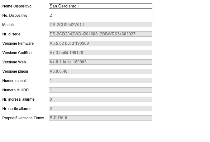

I have done the following on a spare device (but the problem appears to all 5 devices that are connected):
1. Downgrade firmware of spare device from 5.5.82 to 5.0.0: no change
2. Soft reset of spare device: no change
3. Hard reset of spare device: no change
4. Installed Palemoon: live view does not work
And:
1. When Device IP address is not in IE trusted site, the "camera" icon in liveview is grey, when Device IP address is in IE trusted sites, the "Camera" icon in liveview is black and I can select it. But when I press it, a folder with day's date is created in the defined destination, but no recording inside. This happens with spare device firmware 5.0.0. In other devices with firmware 5.5.82 a message "Recording faield" appears.
2. "Capture" icon is always balck, I can select it but no screenshot is taken
3. Installed iVMS, as a spare option: I can see live view, I can record locally, but footage previosuly recorded on NAS are not visible, so no download
I really thank you for interest in my case and support: we had some vandalism on our house walls and would like to go to the police with the footage, but no way. I do not know what to do...
