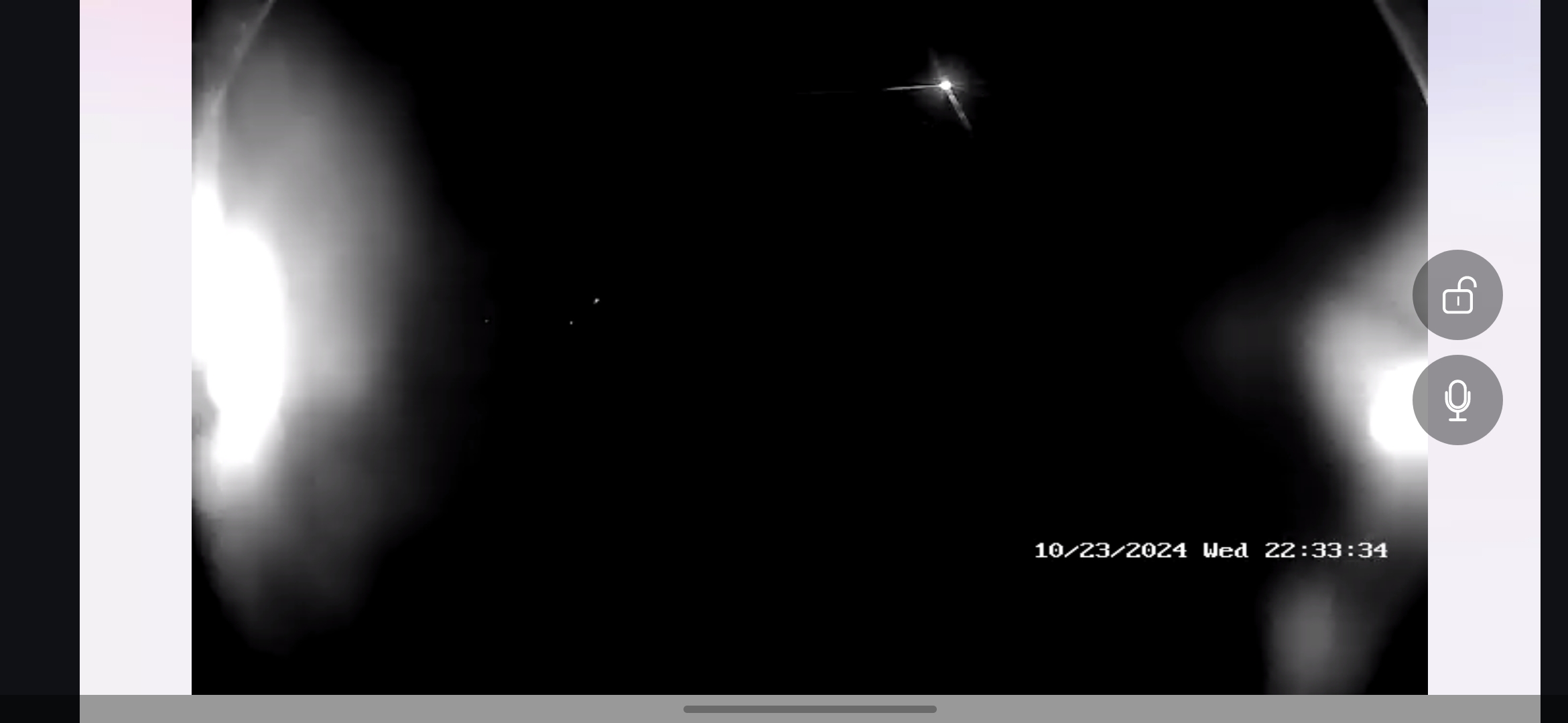

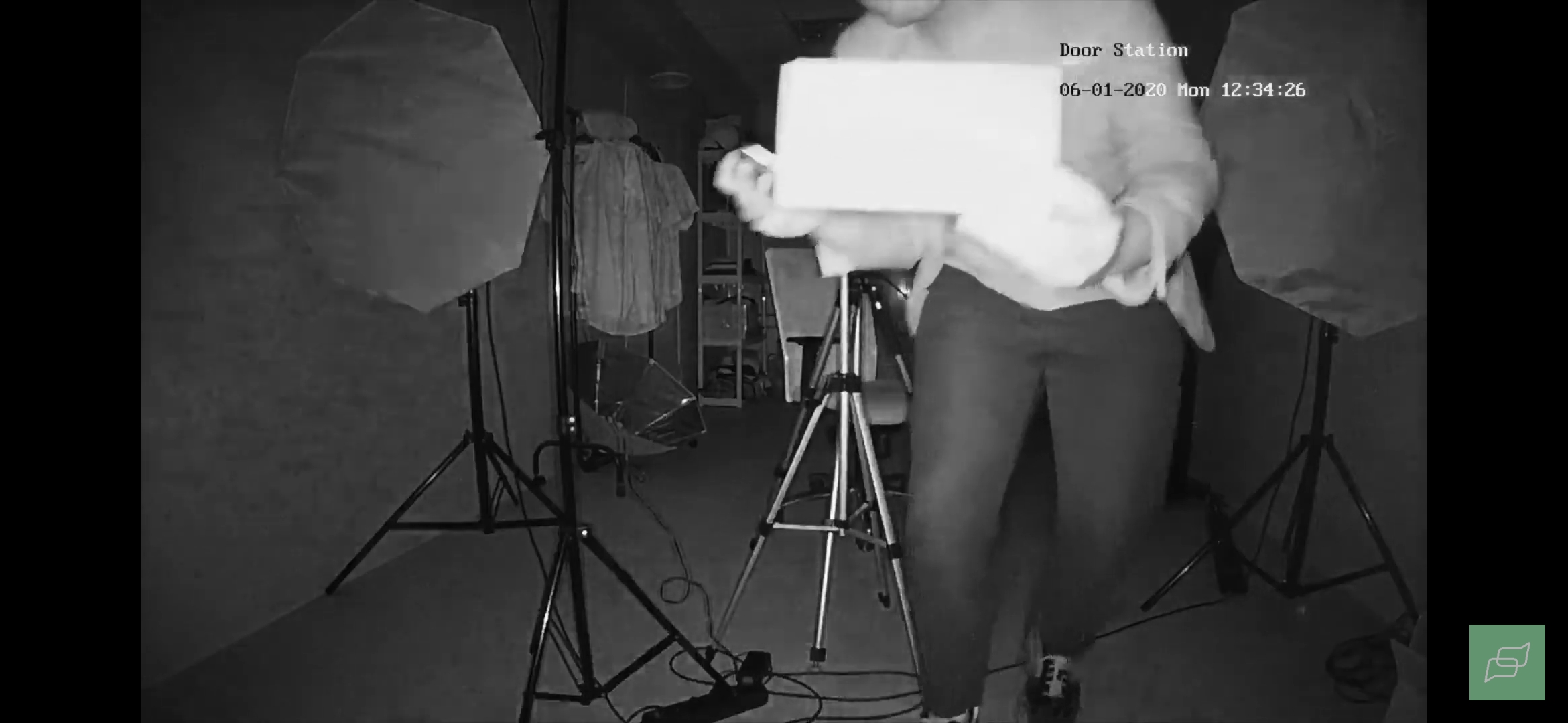

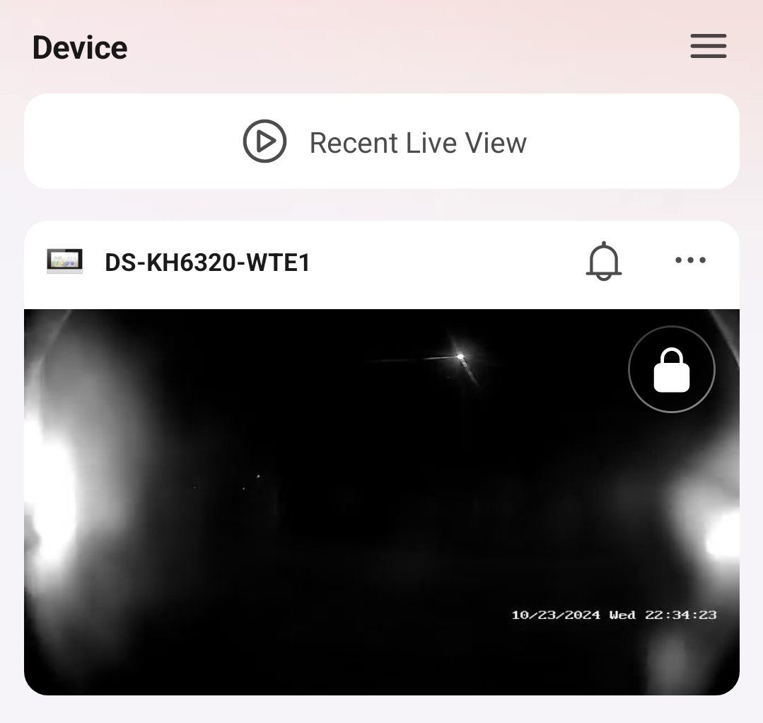

  2. The night vision quality is quite poor, despite having a street light nearby. I also notice two lights (IR?) in the video feed. When someone moves closer to the camera, they become visible, but overall visibility isn't great. What settings can I adjust to improve the night vision? I saw a YouTube video where the setup even illuminated the room!

Thanks. I will try to arrange wifi coverage for that area or connect the POE switch to the internal LAN. The image for nightvision has cleared up (dont ask - I didnt remove the protective film). So all is clear now.
