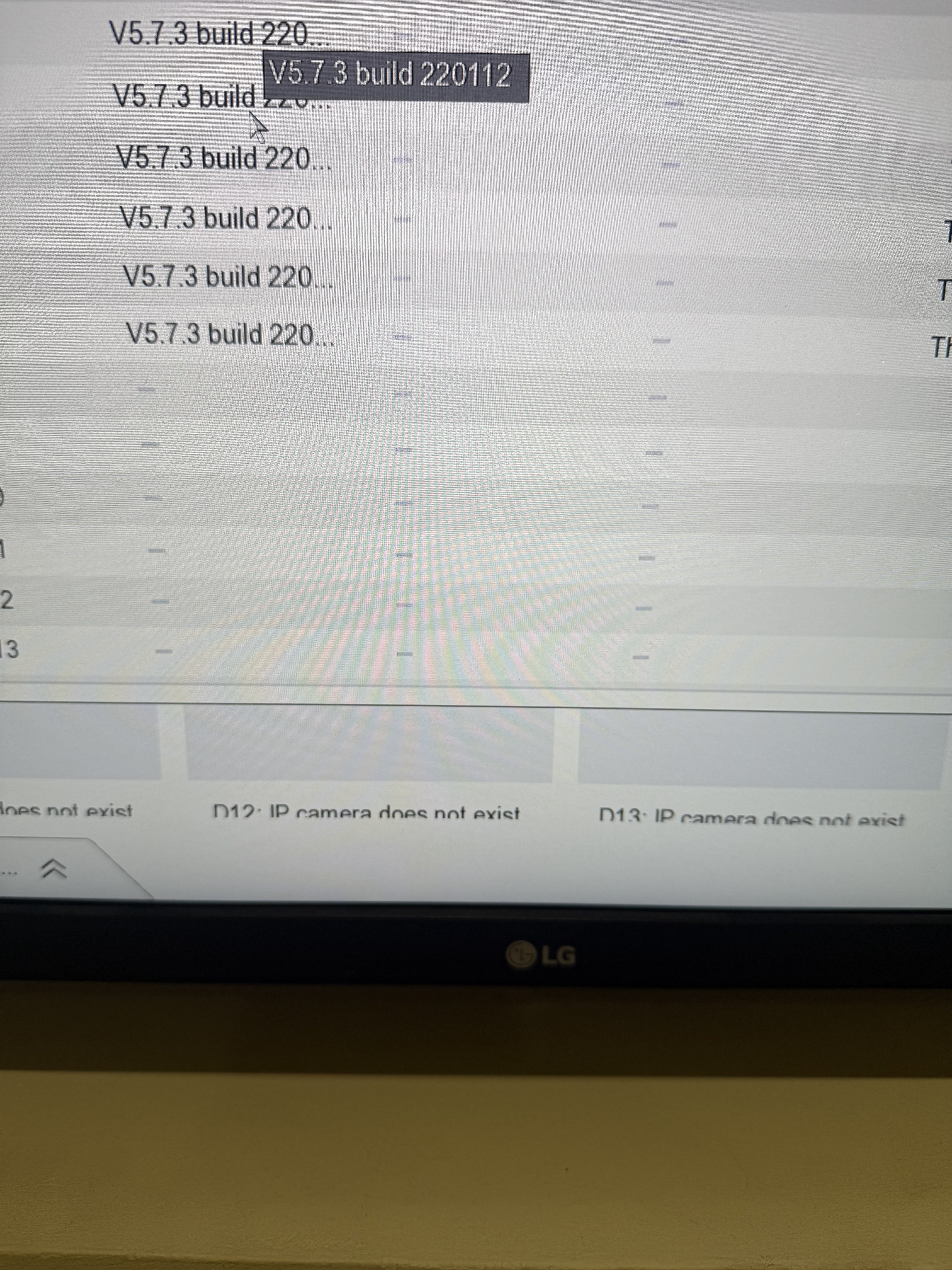

Hi guys. I ordered this system off use ip in November 2022. And haven’t updated anything manually.
It seems very slow at the min at catching movement and my hikconnect app is slow like takes ages to load only as of a few weeks ago.
Pic attached of the models of devices. I did go on the nvr and check for updates but it says it’s up to date. I have automatic updates on….. Assume there maybe other ways to update it via usb?

Hi @Kilojade
Your NVR firmware is several versions behind.
One of those newer versions is the major V5 firmware, which significantly changes the NVR's user interface. Below are firmware versions we would recommend updating to in steps (e.g., one update at a time - do NOT update straight to the latest version).
V4.63.006
V5.03.000
V5.04.020 (find under Resources > Firmware)
For the cameras, the latest firmware is V5.7.19_241207 which you can update straight to.
Unfortunately both of those latest firmwares have fairly major issues.
NVR 5.04.020. No motion detection indicators in playback timeline. No motion detector indicators in Hik-Connect (filter returns no results). There are other issues but those are two that will make it difficult to search and find events.
G5 Camera 5.7.19. Dual VCA doesn't work and so if you need to retrospectively perform a motion, intrusion, or line crossing search to find something that didn't trigger a preconfigured rule, the NVR will return no results.
With the above in mind I wouldn't recommend updating the NVR beyond 5.03.010 and the cameras beyond 5.7.15 to avoid the issues.
Currently Hikvision releasing new firmware that resolves all issues is about as likely as peace on earth in 2025.
