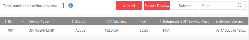

Between me posting my message and your reply I did indeed hook it up to a monitor via HDMI and it is actually booting up (no brick thankfully).
I can also see it using SADP, so this is a good sign but it is just not visible on my network at the reserved IP address it normally has.
SADP shows DHCP is still active on the device but the IP address is showing as 192.0.0.64 (it should be within 192.168.0.xx if the router was assigning it an IP)
The other odd thing is whenever I am wanting to change anything using SADP it is asking me for the admin password (which has not changed since I set it years ago), however it says it is wrong. So it appears it has taken the firmware update ok but something is perhaps messed up with the config, I'm not real sure.
