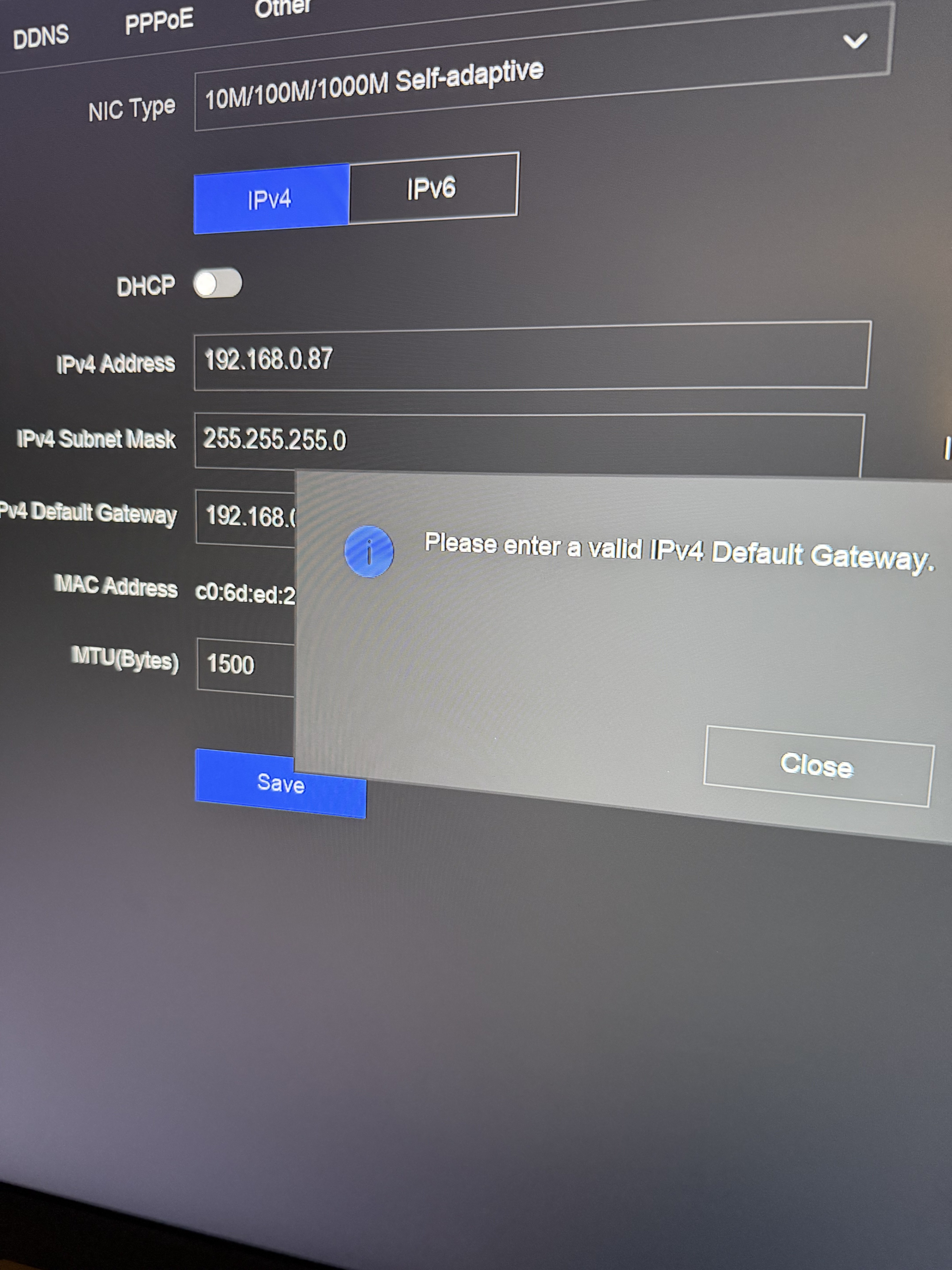

Just tried that new on the ipv4 section in pic. It didn’t make any difference so as I tried to change it back it wasn’t happening kept coming up with that message but after a few try’s it worked

Just tried that new address u said on the ipv4 section in pic. It didn’t make any difference so as I tried to change it back it wasn’t happening kept coming up with that message but after a few try’s it worked

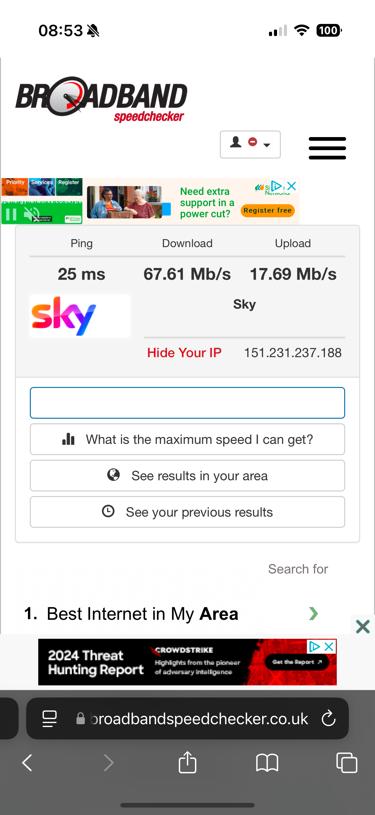

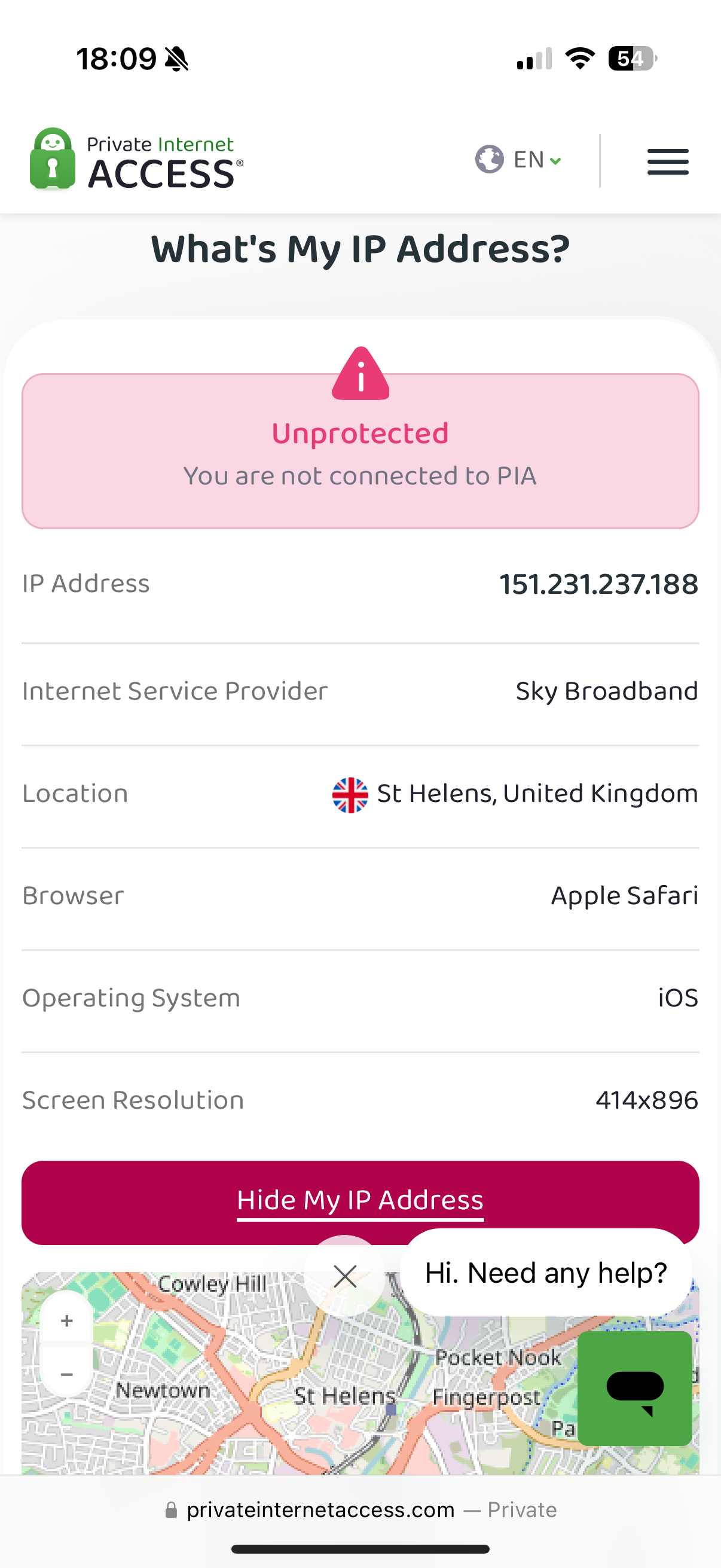

If I google what’s my ip address it’s come up that iam in a area called st Helen’s that’s 20 miles away and ip is different
Changing the IP address (IPv4 Address) to 192.168.0.250 would not bring up an error message asking you to key in a valid gateway. The gateway is 192.168.0.1, so the only way that message came up is if you typed an IP address in that started other than 192.168.0. You just needed to change '87' to '250' and save, nothing else.
That's irrelevant, it's showing your external IP address from Sky - nothing to do with your internal network.
