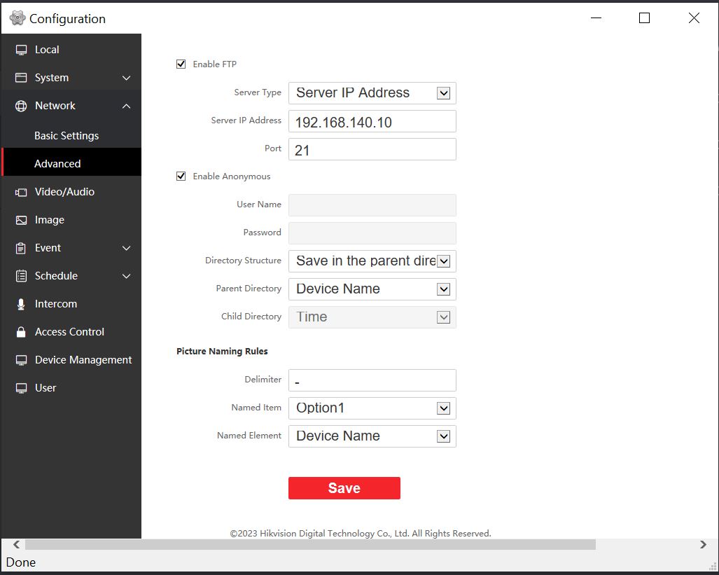

@NoFate, thanks for your very kind offer of checking out FTP. I've attached a copy of my FTP config on the camera. If you can confirm this works, and you have NTP working as expected, that would reassure me it's not an issue with the firmware version.

Just tested FTP, enabled it, enabled motion event, but indeed , it doesnt do anything, doesnt send image on ftp when motion is detected ; or not even when call is detected...
I dont see any connection coming in, so not sure why that feature does :-)
My guess, since 8003 needs an indoor, and images are saved on indoor, it needs to be enabled there, alltough i dont see any ftp settings there

So....I kept working on the FTP issue to QNAP because I don't like to be beaten and have it working (sort-of). Wanted to come back here to share the experience for anyone else who has the same issue. The spoiler though is that FTP only seems to upload pictures when triggered by a door event (Door Open from Indoor Station, Door Open from Keypad) and motion detection events are not uploaded. If anyone has a different experience I'd be very interested as my other Hik camera will definitely upload events using FTP.
Looks like the 8003 wants to create the directory it is going to write to on the QNAP (I had created this manually). If you ask it to write to a directory (unless that directory is root for FTP as defined on the QNAP) it gives a login failed error, no matter what access privileges it is granted. A quick summary of settings:
- 8003 is pretty vanilla with a username and password defined, rather than anonymous login. Directory Structure>Save in Parent Directory; Parent Directory>Device Name
- Key parts of QNAP config are: FTP support>FTP (Standard); Unicode Support>No. Root directory for FTP is specified under the Advanced tab. If you;re not using Anonymous login make sure User IDs used for cameras are granted privileges for th Root!
