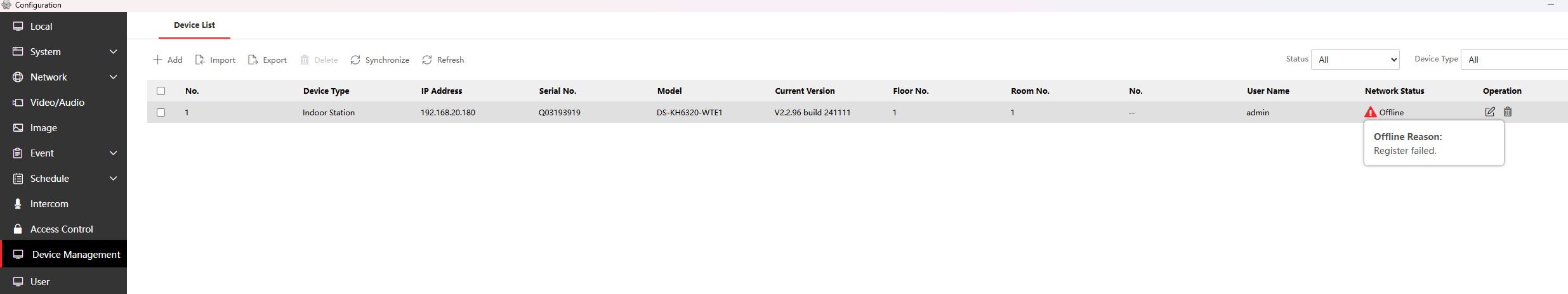

In the door station config via iVMS, it shows "Register failed", but I don't get any more detail about the problem.

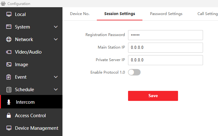

In door station setting, I've done Intercom -> Session Settings -> Registration password as well as doing it via the "Device Management" -> Add:

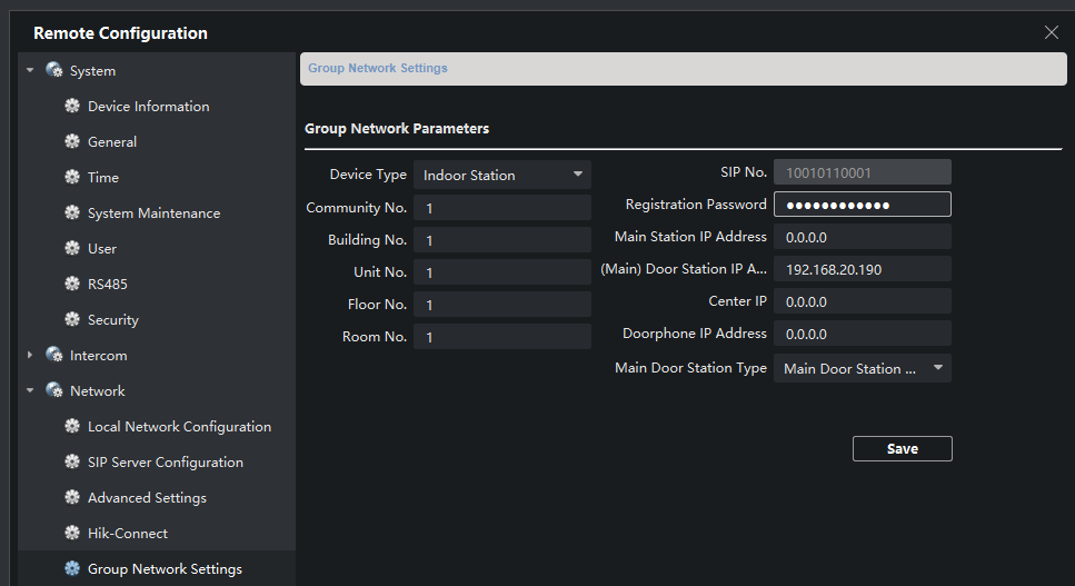

In the indoor station settings, I've set the Network -> Group Network Settings -> Registration password & Door station IP:

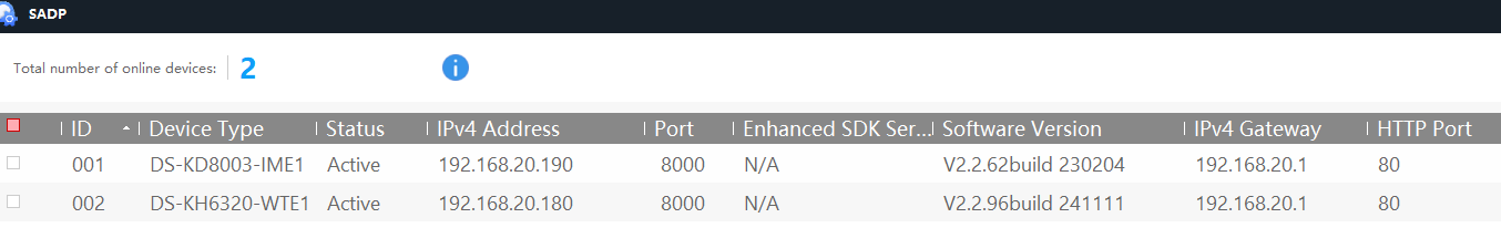

In SADP:

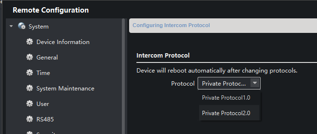

Should it be protocol 1.0 or 2.0 for both?
Door Station
Indoor Station
(I have tried "Enable Protocol 1.0" = On, and Private Protocol 1.0 on both but still no joy in getting them to link)

Short way is delete indoor from device management inside door station
Change ip address of doorstation inside indoor station settings to something else. Press save then bring back to real IP so it readds itself.
