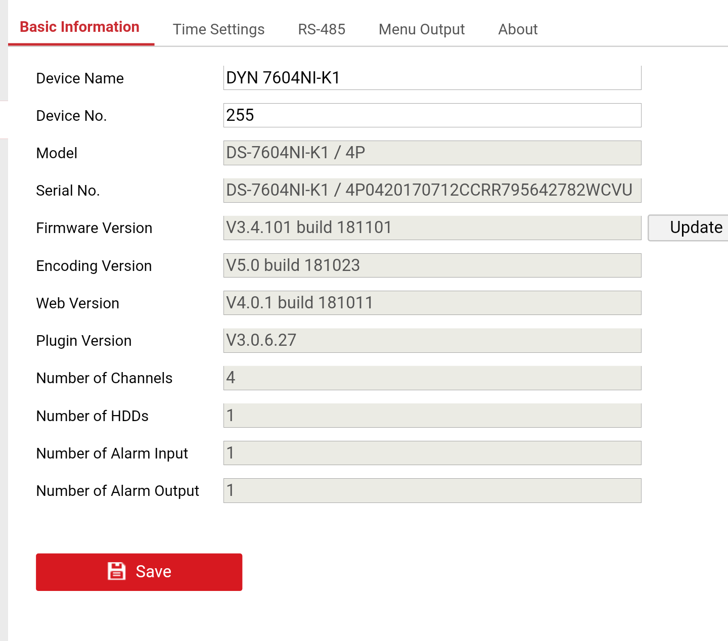

I don't think you have logged-in to Config on your camera.
That firmware version is too low to be the firmware release of a G1-series camera e.g. your 2555.
If you look at the Model field, third on the list, what does that show please?
Hey Phil, I've attached the screenshot of the setting. I hope this helps.
I am logging in 192.168.1.xxx
you could be correct. How do I login to the actual camera ?

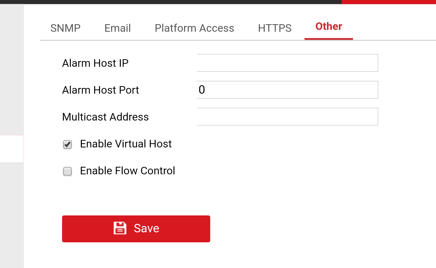

Enable Virtual Host on your NVR.
With Virtual Host enabled, when you check Camera Management in the Configuration area you will see blue hyperlinks at the right side alongside each of your cameras in the table.
Clicking those links will open a new browser tab for each camera.
That new tab will allow you to log directly into the camera, to access its settings, and make Configuration changes to the camera.

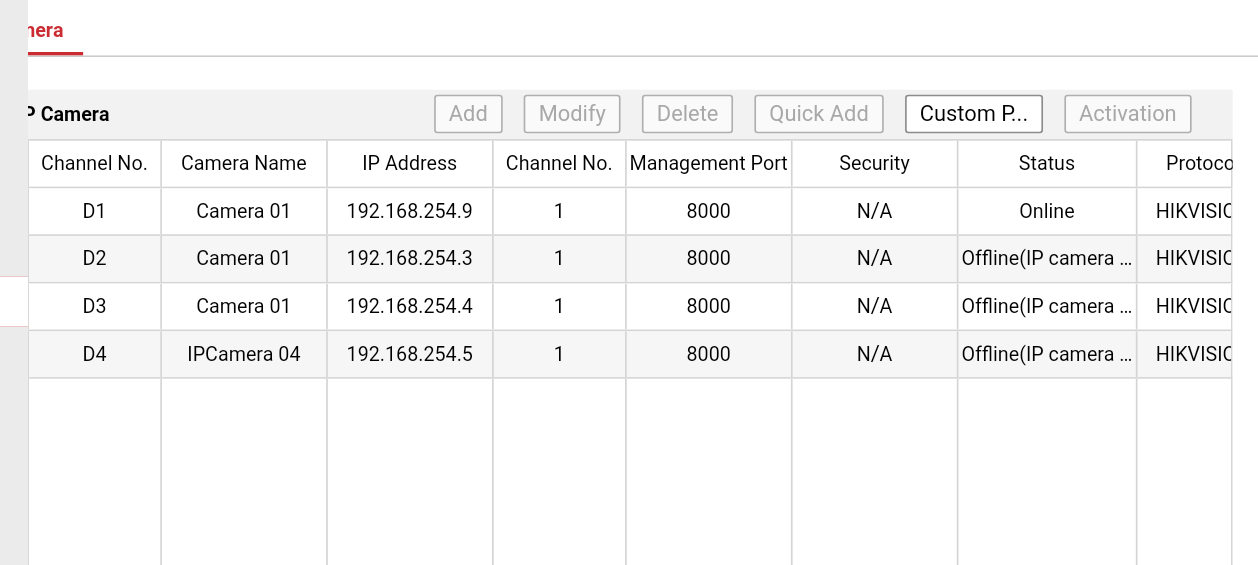

However when I enable the host I m unable to get the blue link on the camera management...
