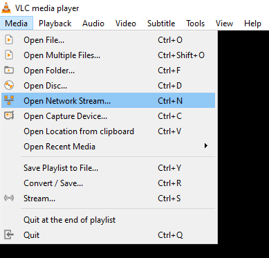

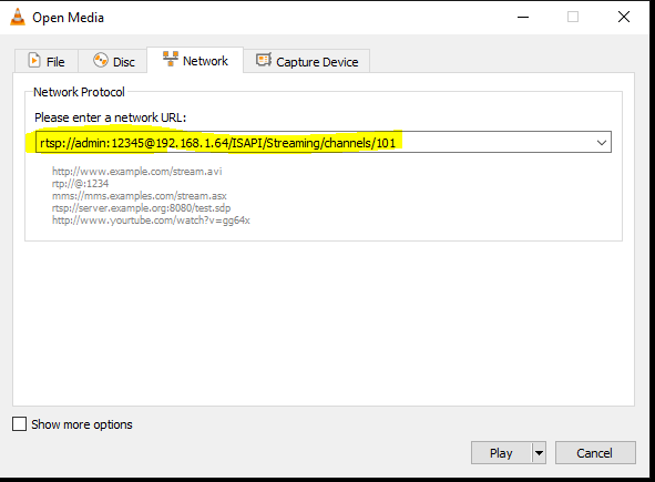

VLC needs to be pointed at the RTSP stream. You'll need to enable ONVIF on the NVR. Enable the settings in the NVR's webGUI under Configuration>Network>Advanced Settings>Integration Protocol. For testing, create a user with the same credentials as the admin account.
From VLC:
Try the following URL's (amend the password and IP to your NVR's settings):
rtsp://admin:yourPassword@192.168.1.64/ISAPI/Streaming/channels/101
rtsp://admin:yourPassword@192.168.1.64/Streaming/Channels/1
One of the above should work if you set it up correctly.
101, 102, 103 etc will switches between the cameras.
