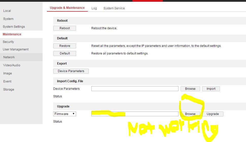

Just had an windows update incl update of IE to version 11.
Experienced that the webcomponent now is not working when accessing NVR or Cams from the browser (IE). Just showing 'No plug in found'. but is not asking for download as usual.
I'm also not able to select any path to the firmware upload (see enclosed screendump). Anyone else experiencing this with IE 11 ?
(Just to verify, I have used and old laptop with an older version of IE and didn't experience same issue - and updated the firmware on my cams from there, so not an Hikvisison (NVR or CAM) issue but more an issue related to my windows/Internet Explorer)

Hi Soren,
i have no issues here...IE11 and newest 5.4.4 firmware. IE asked me to install the new webcomponents plugin.
Just got it working as before the update. Added the ip address of the NVR and Cams as 'Local Intranet sites' into the Internet options. And turned compatibility view on for the ip address as well. Now it works ;-)
