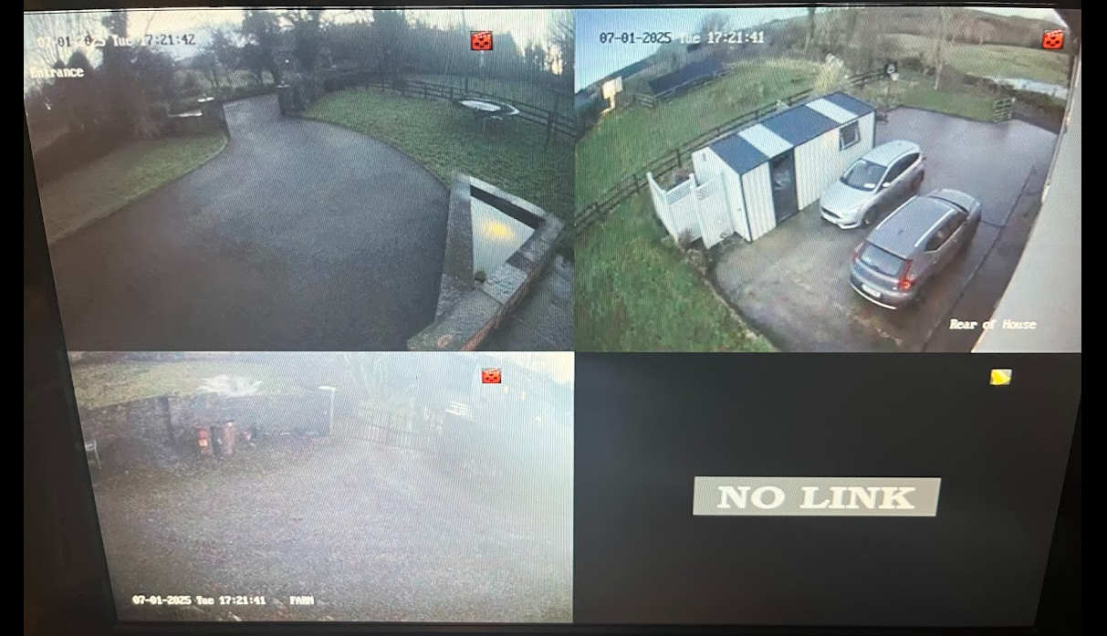

I can see the camera's from the TV which is hardwired to the camera's however I cannot see anything on the app, it just says devices offline.

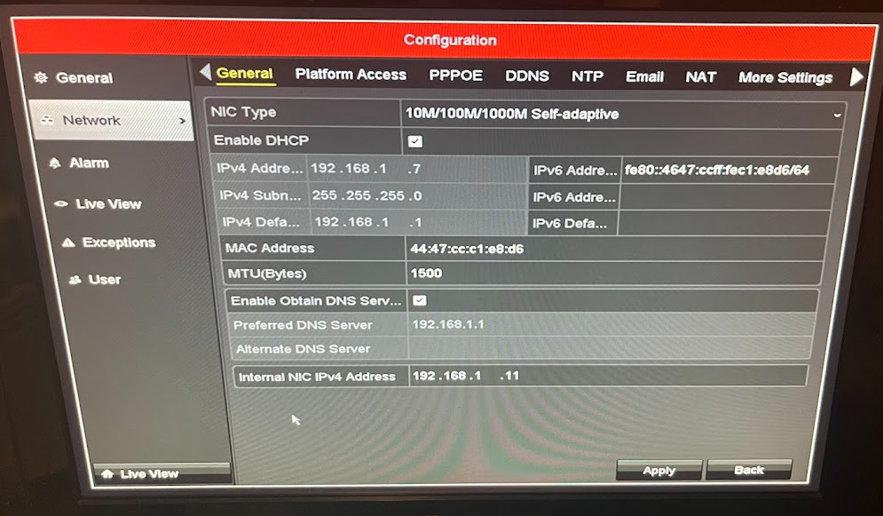

I have taken screenshots of what the TV is showing, the network settings
and the app if that helps ?
I think it's the IP address is the issue ?

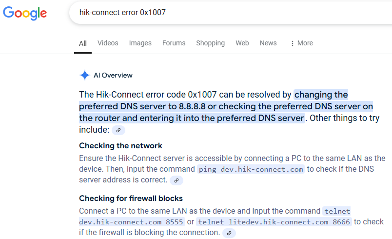

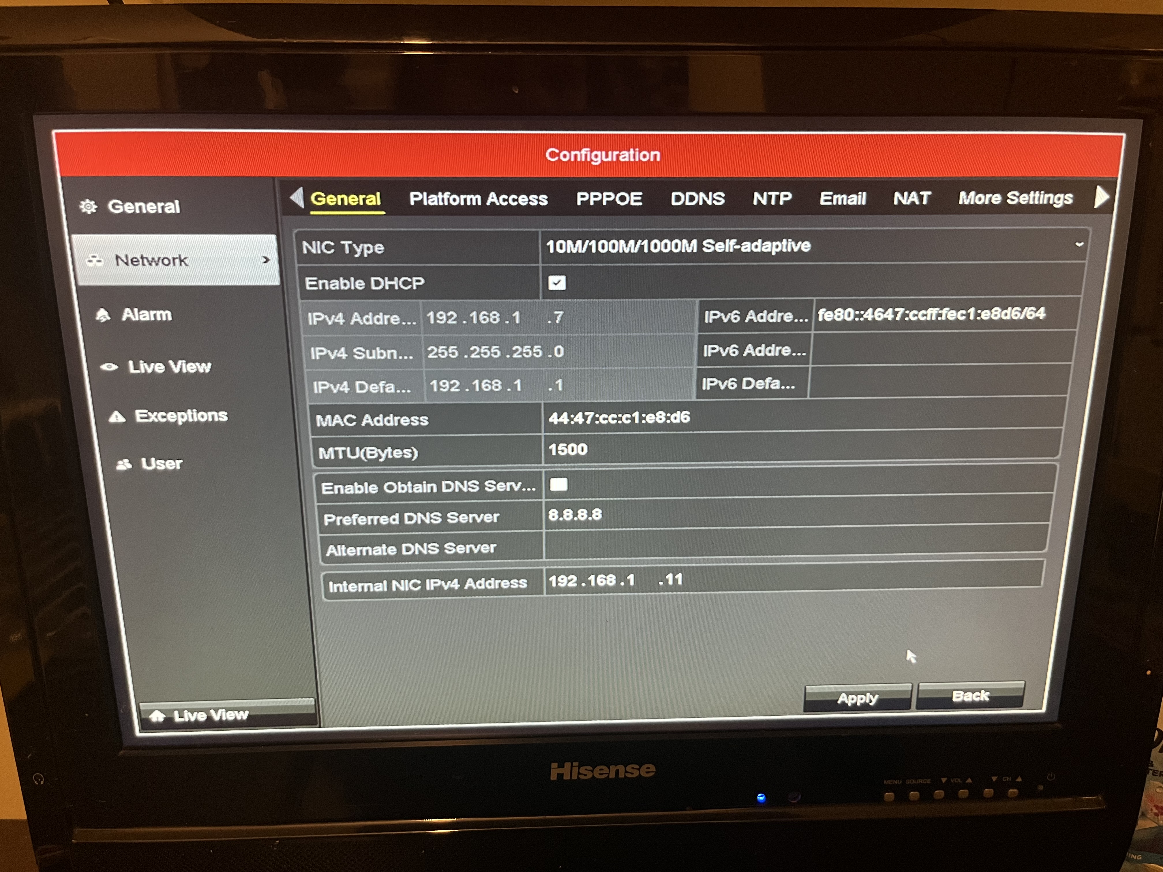

Then, try changing your preferred DNS server to 8.8.8.8
EDIT: You will need to uncheck "Enable obtain DNS serv..." before you can manually edit the DNS server to 8.8.8.8
OK, that doesn't always work...did the error code (that was 0x1007 on the Hik-connect setting page) change?

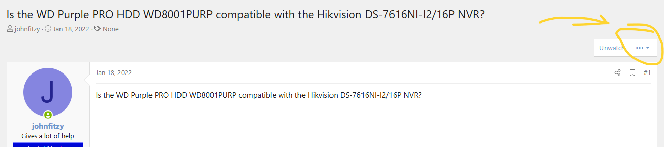

no you should be able to delete it... i was probably wrong to say click on it... the picture is like 1 character of text.... click just to the right of it you should see the cursor blinking there and then backspace it
remember you have to hit the edit button at the bottom of that post first
No there is no cursor or edit option
easier maybe to just delete this whole thread and start over .. hit the "..." at the top /right of the thread and delete thread... start a new thread and we'll go from there
That looks messed up. Someone has already changed the internal NIC IPv4 address to 192.168.1.11 from its default of 192.168.254.1. I'm surprised you've even got images on the monitor if the cameras are plugged into the NVR, but hey ho I wouldn't change it back now as you'll have worse troubles....

Hi @lisak1972
We have removed the app screenshot from your original post.
We had to change the edit button so that it is deactivated a few minutes after a post is made because we were seeing an increase in spam users who were posting genuine-looking posts that got past our spam filters and then were editing the posts at a later date to insert dangerous links/content.
In the future, just tag me or one of the other admin users in the thread and point us to what you want edited so we can change it for you.

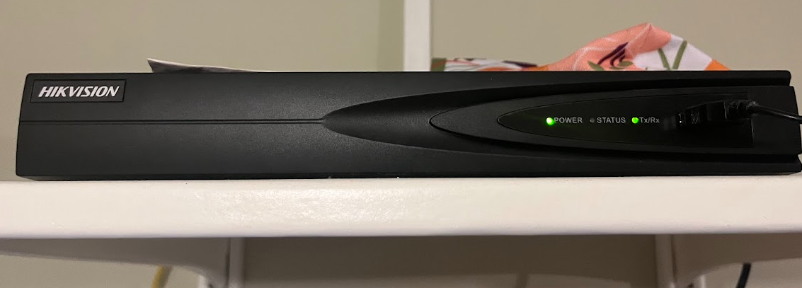

My setup is as follows:
There is a small black box in the attic that all the camera's are plugged into, this has a red and green power light.
That box is connected to another box that has the power, ethernet port and the TV screen attached. They all have power and lights on. I can see the 3 camera's on the TV screen.
As @JB1970 states, the internal NIC IPv4 address 192.168.1.11 is odd but if it was working before, we won't mess with that.
That sounds like a PoE switch.
That's the NVR, for sure.
