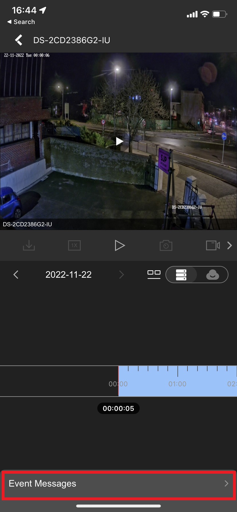

If you open playback, there is an "Event Messages" button at the bottom that brings all of the event clips up:

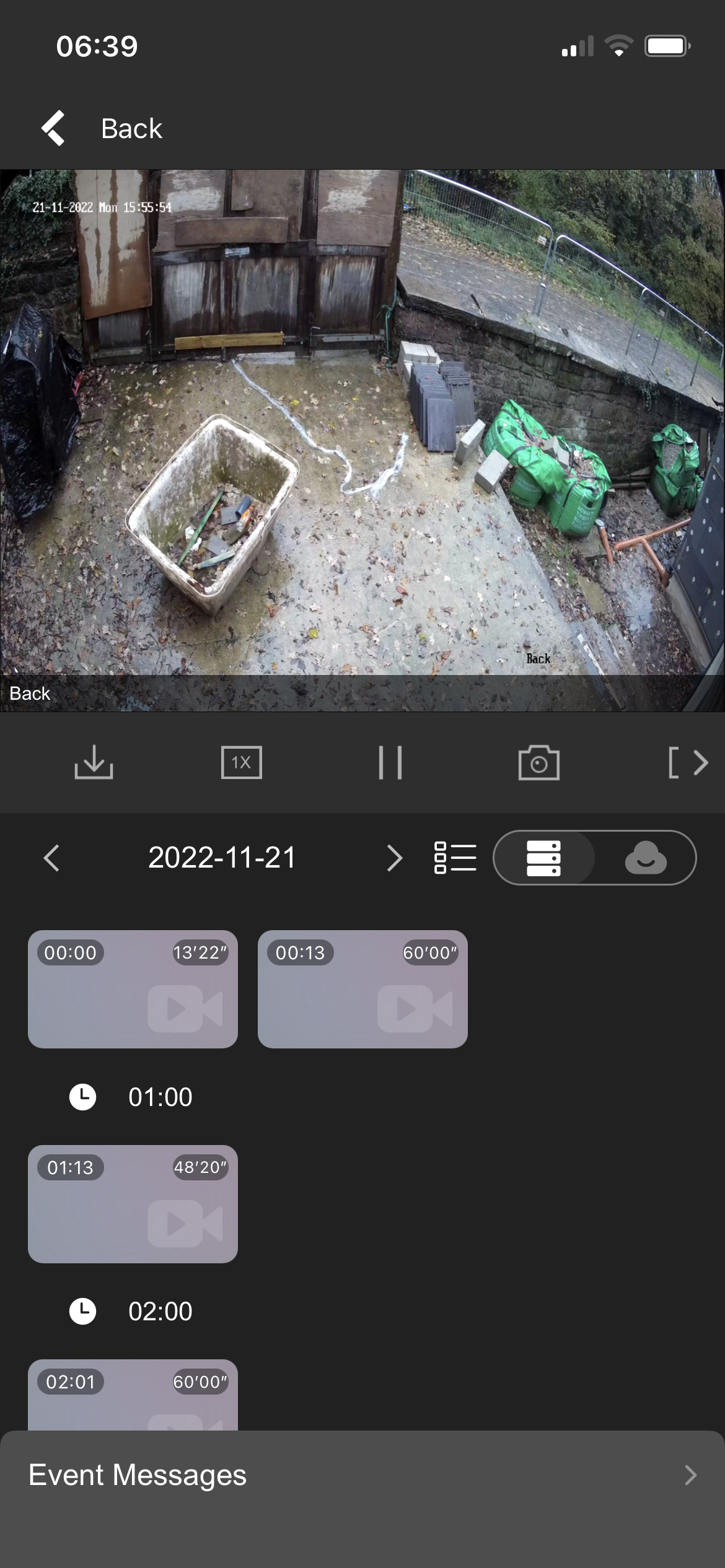

Hi, it’s a iPhone. And hik connect app I deleted it and re downloaded so I assume it’s up to date?
But yes have since realised they removed that feature for me it was a good feature. I can see the time frames on mine but it doesn’t make sense I think I need to set it up properly. It records some events but not all and I think the events recoded are on for like a hour? Attached pic. Doesn’t look right to me. Like if I walked in the garden I can’t find that event. It’s within a hour of the clip somewhere
Those long clips in your screenshot aren't the event clips - if you touch "event messages" below those then you'll see them.
You will need to make sure that you've ticked "notify surveillance center" in the linkage method settings for the relevant event to see these as well.
