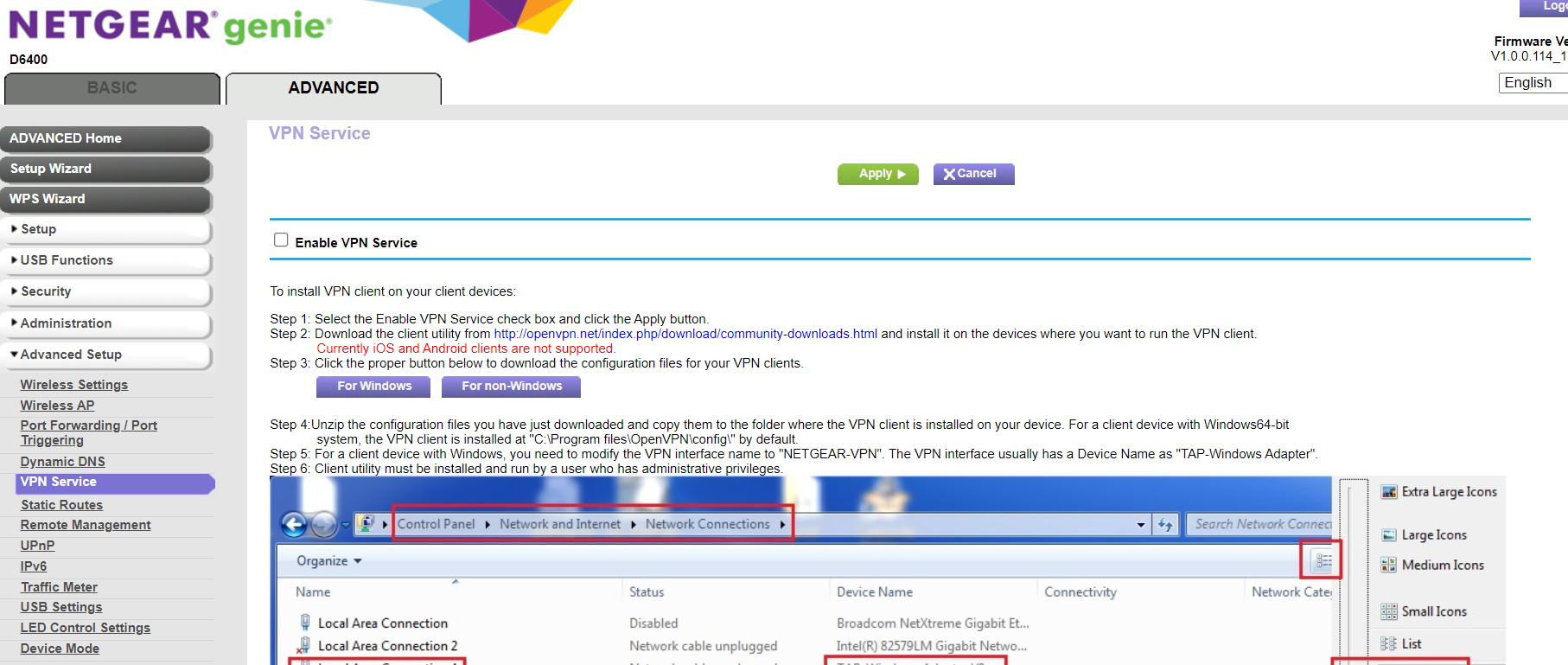

My current Netgear D6400 router does have VPN capabilities but I don't know how this will effect the other devices connected to it.
Actually just read there that andriod and iphone not yet supported
