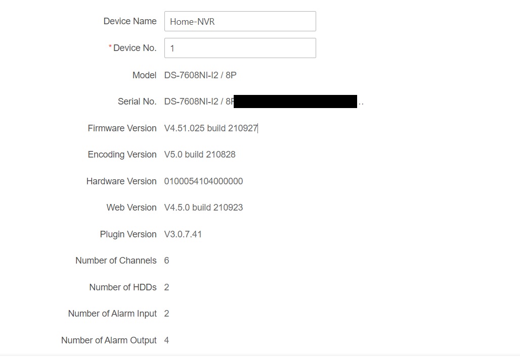

my nvr details
NVR DS-7608-I2/8P
Firmware V4.5.000 Build 210125

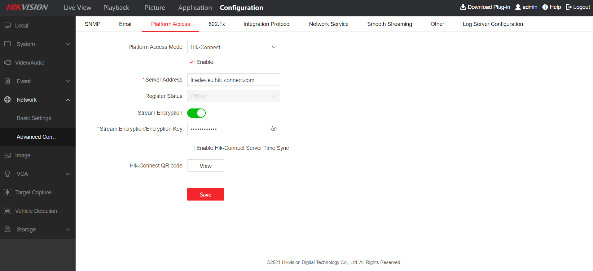

I've enabled the Hik connect platform and am online connected to server litedev.eu.hik-connect.com.

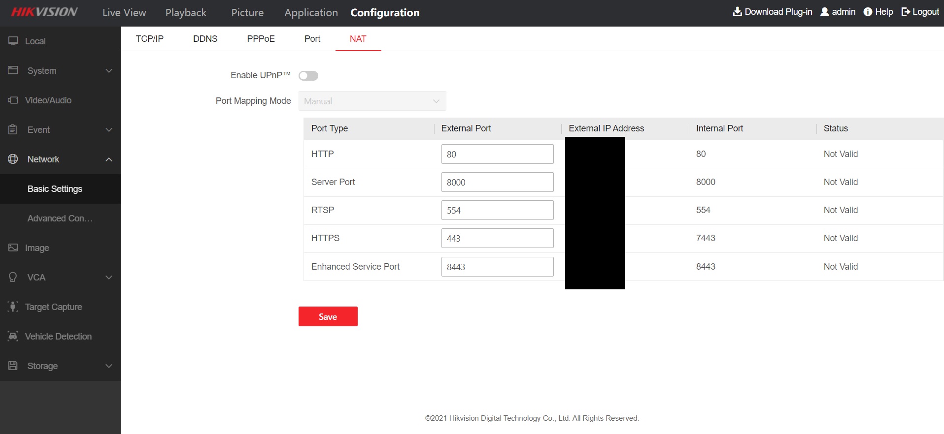

no related port forwarding rules on the router.

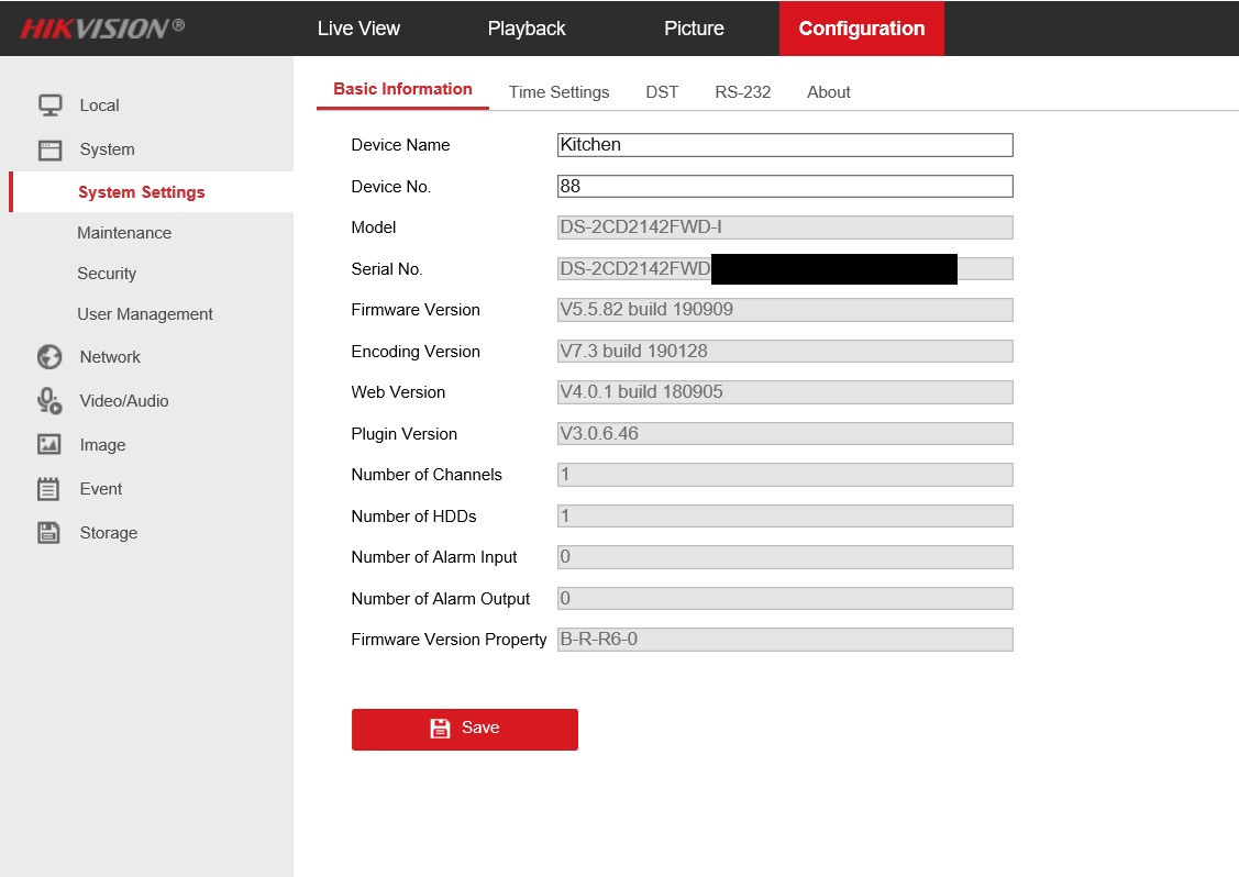

I am on V5.5.82 build 190909 wonder if it might work if i went back to same as yours? do there whole firmware versions i.e. V4.5.000 mean they are stable?

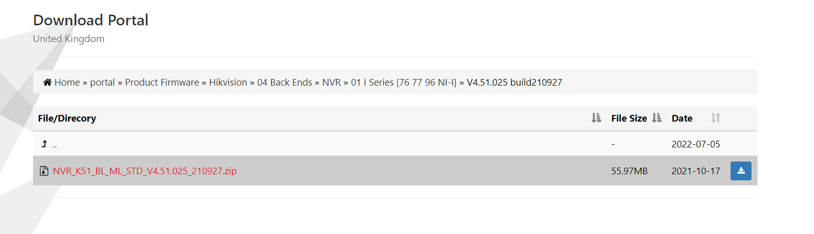

I think there is a discrepancy on our firmware versions, I believe the build number is in the format yymmdd. I cannot find your version on the NVR 76 I series EU or UK portals. Can you double check for me? Also what is your NVR model number? I thought it was the same as mine...
I think there is a discrepancy on our firmware versions, I believe the build number is in the format yymmdd. I cannot find your version on the NVR 76 I series EU or UK portals. Can you double check for me? Also what is your NVR model number? I thought it was the same as mineTaken f...
Taken directly from the NVR Model DS-7608NI-I2 / 8P

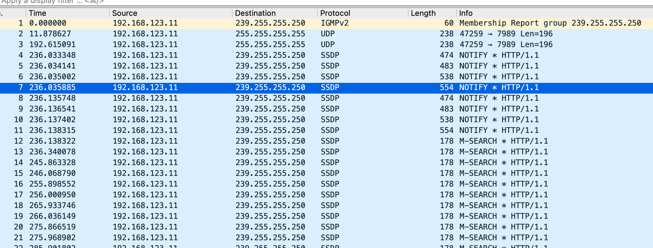

When online and linked, Wireshark shows the output below, the SSDP protocol updates the connection between NVR and Hik account.
When NVR hikconnect is offline and I enable hikconnect (no device on account), NVR goes online but I see nothing on Wireshark. I'm a Wireshark novice.
