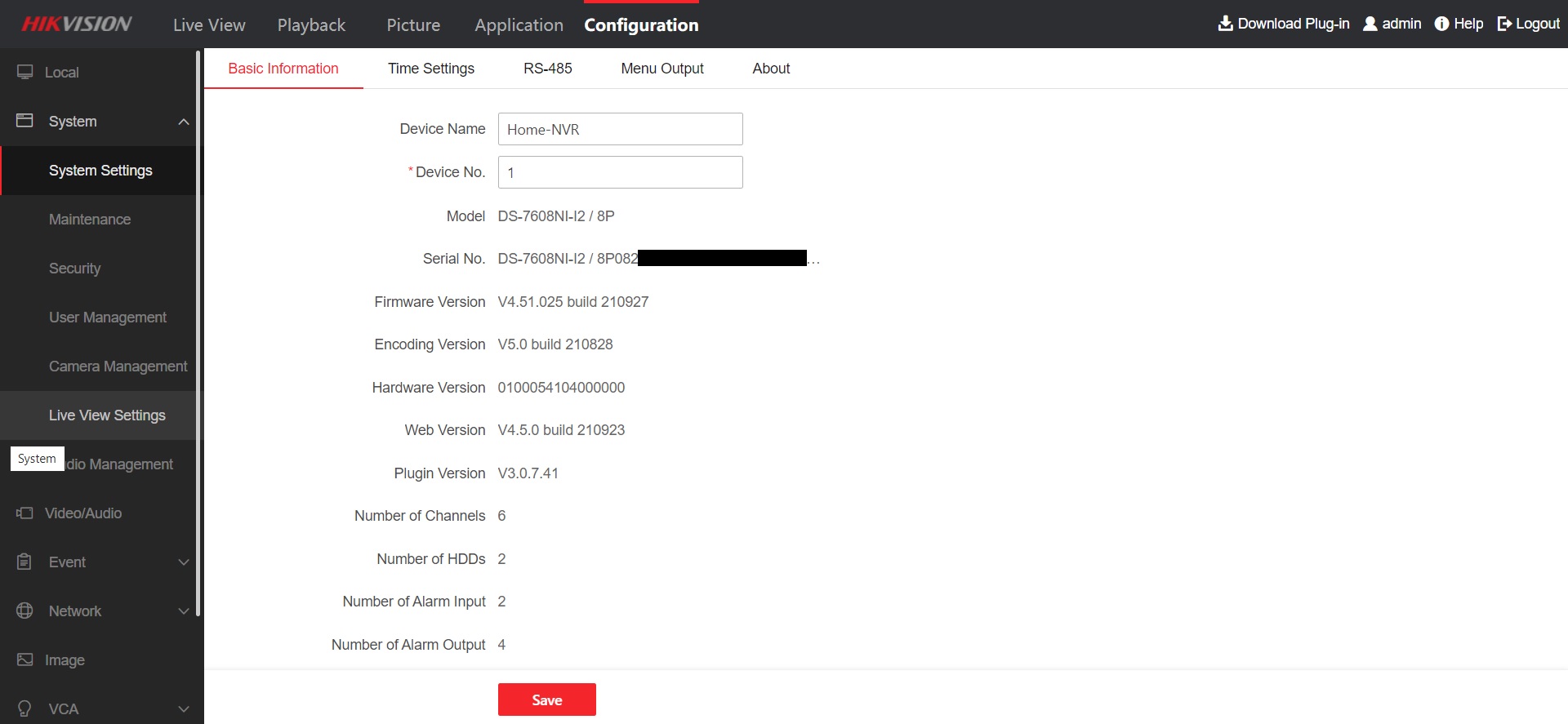

Reverted the NVR firmware back to its original version (V4.51.025 build 210927) hoping this might fix things back to how I originally had them, but unfortunately it hasn't. The cameras and NVR now appear to be back to stable and working as they should be but no connection to HIK Connect.

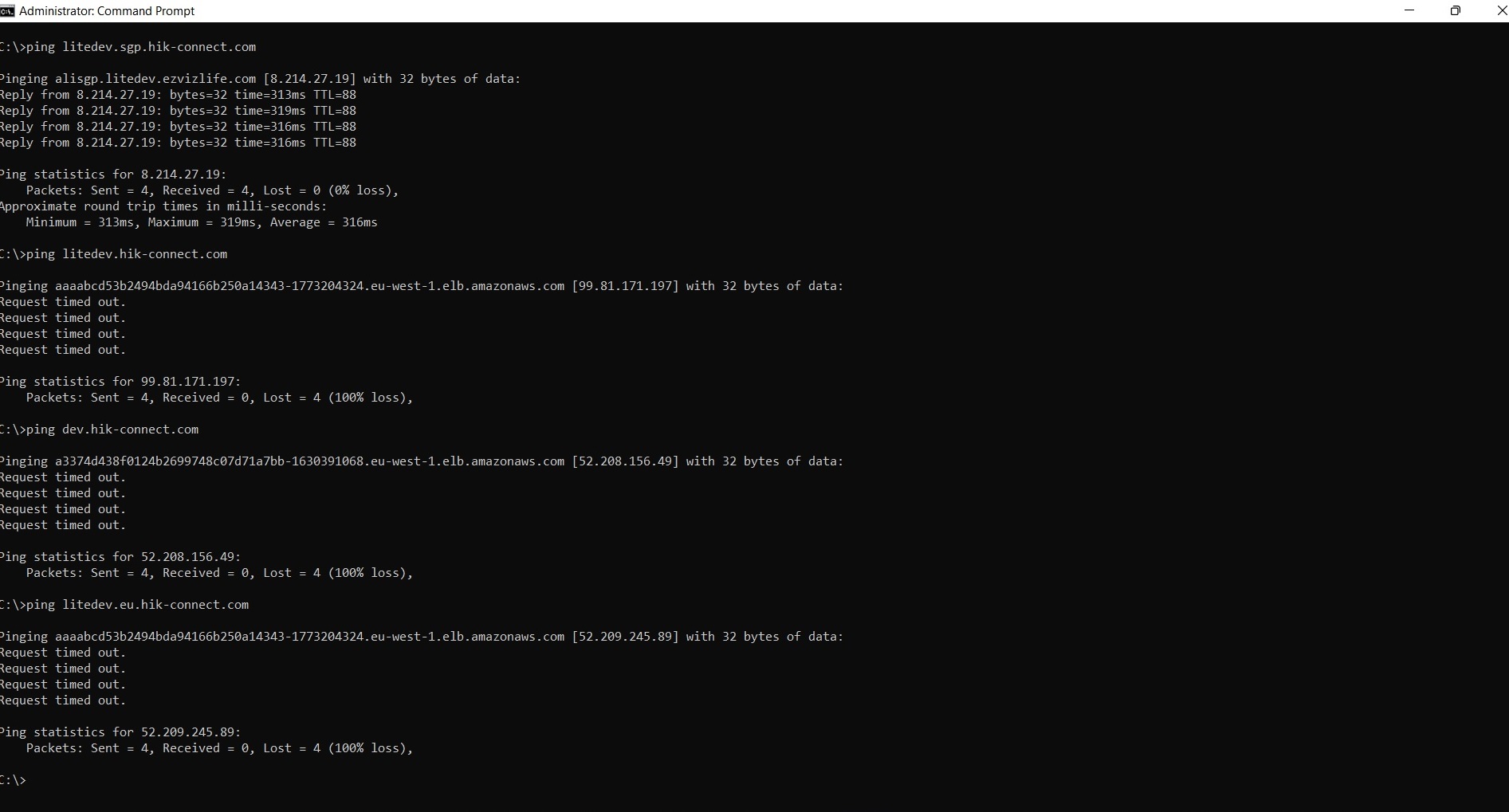

Pinging the Hik connect servers I get no response the only one I do is "litedev.sgp.hik-connect.com"

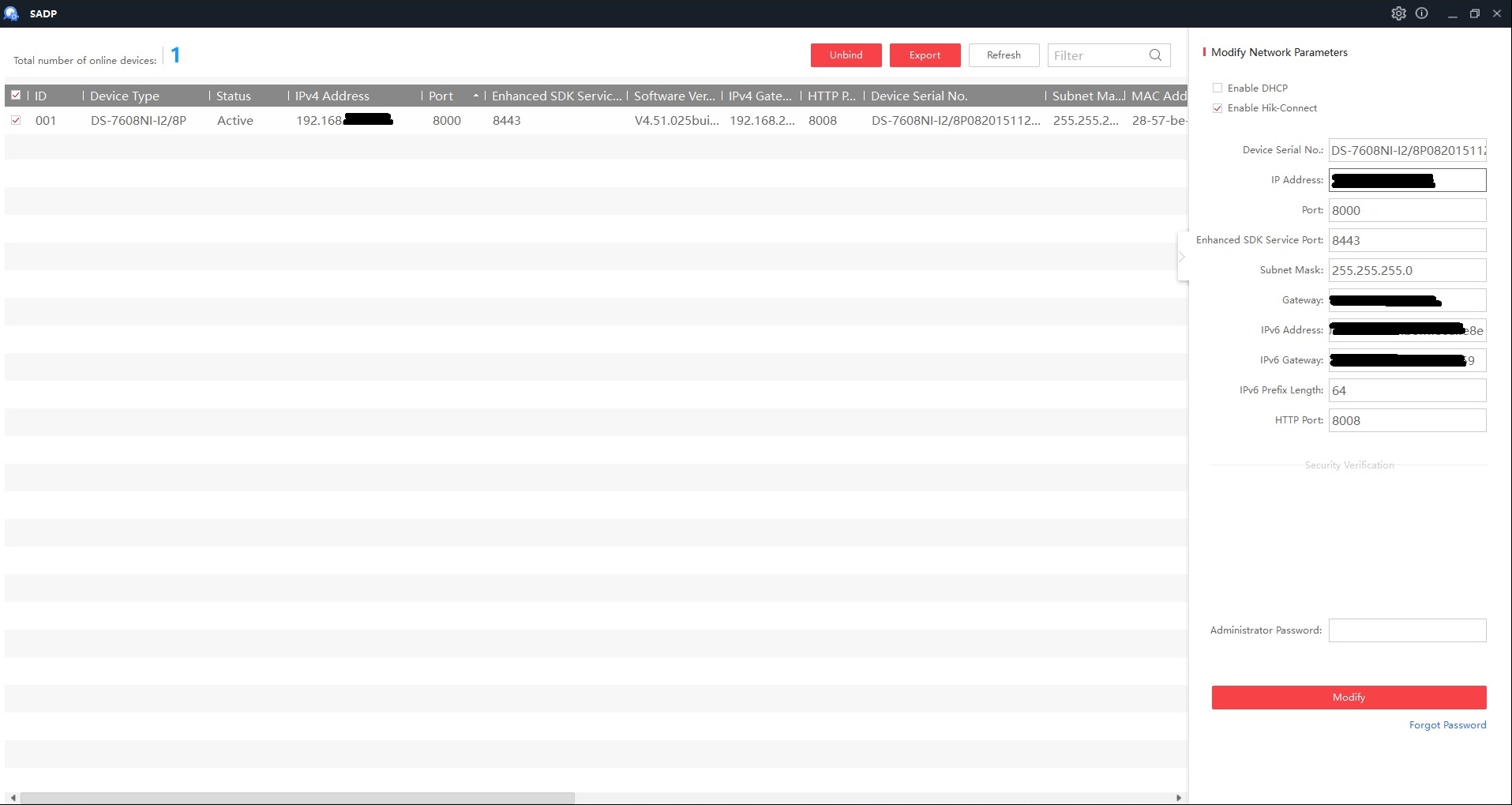

Using the SADP tool shows the NVR as online and HIK connect is enabled!

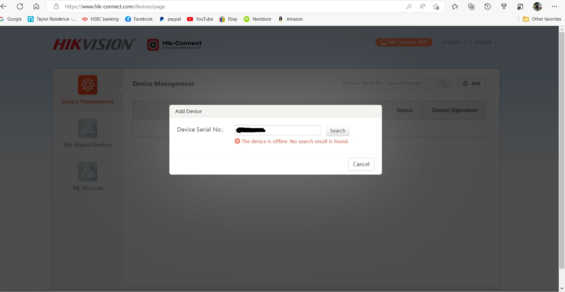

Web login for the NVR HIK connect always shows as offline regardless of server address entered, if I am correct from what i have read and from previous experience this will say online, then i should be able to use the phone app to add the NVR.​

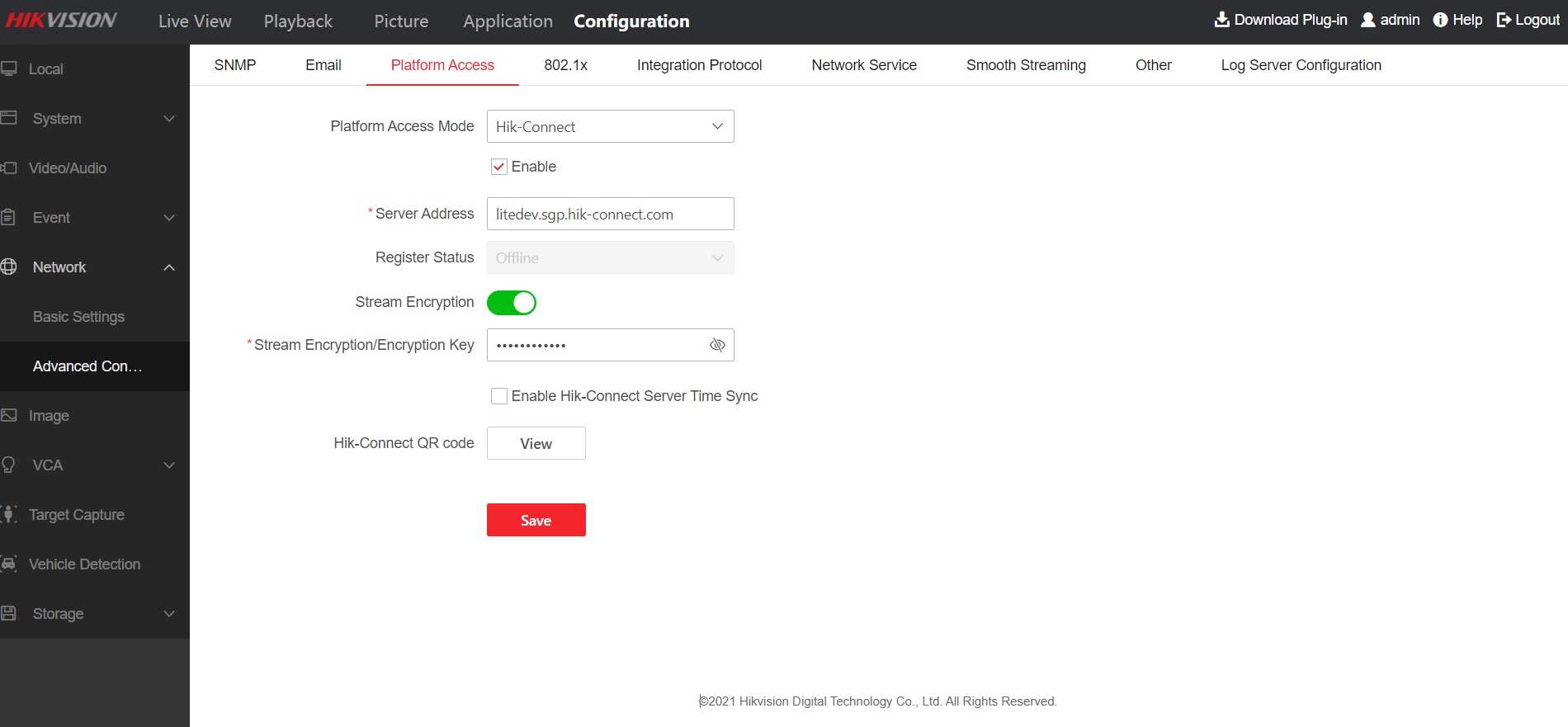

Do i have to setup and enable platform access also on my IP camera configuration page or not or only on the NVR?

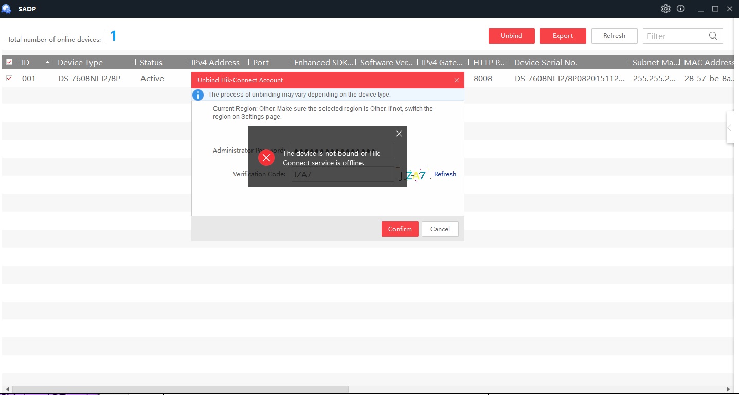

Hi David i had already tried this in SADP and it says this:

@p5taylor,
looking at your ping tests some are resolving to amazon web services servers, what dns does your NVR use?
I used to use 8.8.8.8 and 8.8.4.4, there is also cloudflare 1.1.1.1, 1.0.0.1
Originally before the firmware update I used 8.8.8.8 and 8.8.4.4 with no probs i have also tried my router gateway as primary and 8.8.8.8 since after reading off the net with no joy, desperate times calls for desperate measures lol.

Hi David, I did already have the DNS server on all the cameras set to primary 1.1.1.1 and secondary 8.8.8.8 for what it is worth as I don't think it would make any difference, I think I read a long time back that the IP cameras connected to the NVR are unable to have access to the LAN/WAN. Its the same as do i need the access platform mode ticked in the cameras? i have tried both but with no joy also.

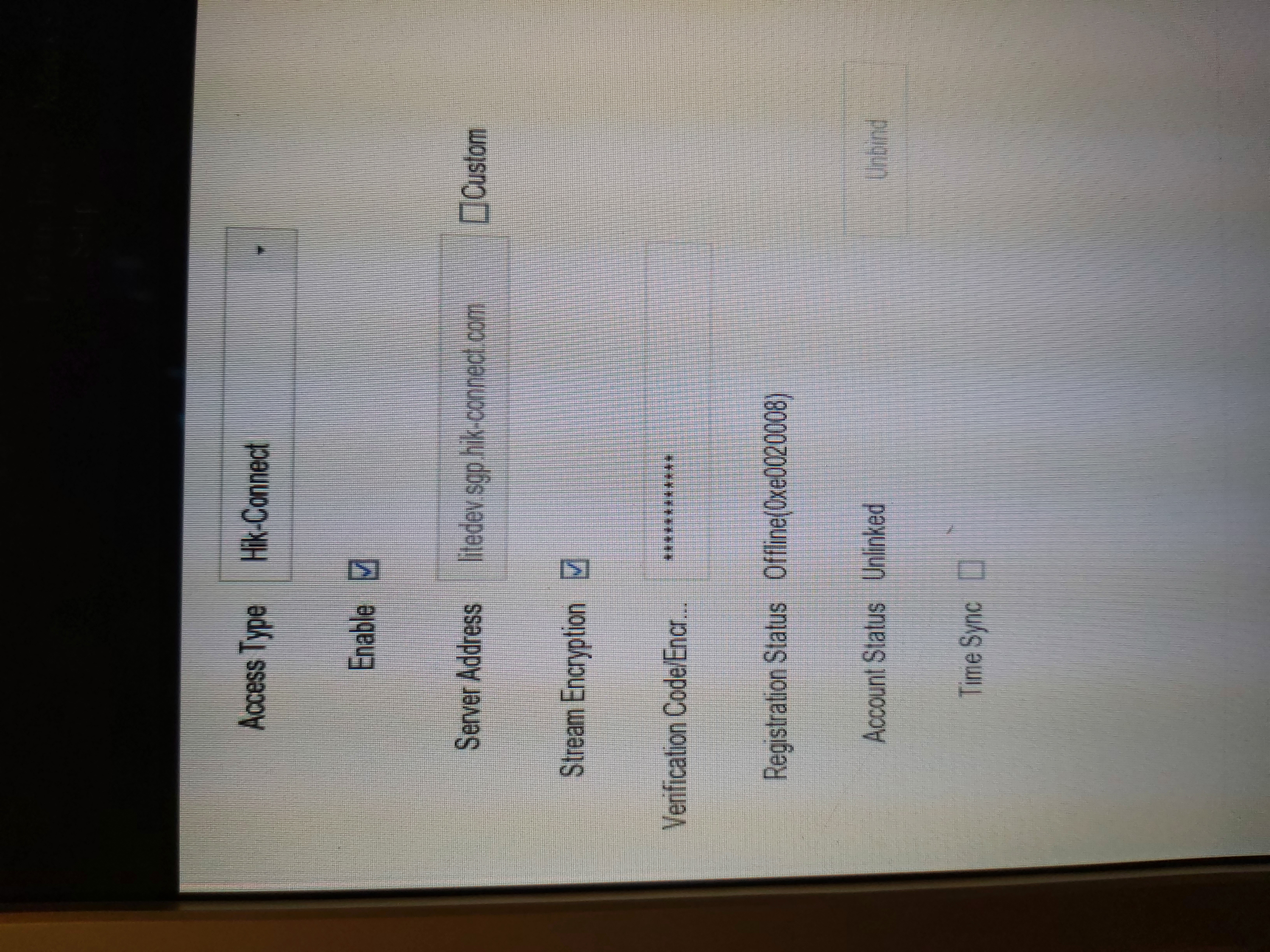

Been connected using monitor and keyboard/mouse directly into the NVR tonight, everything looked pretty much in order in there, i still think my IP has been blocked to start with i did wonder if it was my IP provider but convinced now it is HIK Connect.

The NVR subnet is not completely isolated from your LAN, it sounds as though you already have the NVR virtual host activated.
Yes I do have virtual host on, interestingly while in the NVR last night I took a screenshot of the platform access page and I do have the same error code as the other poster had of 0xe0020008, now who do I contact to get this released.
