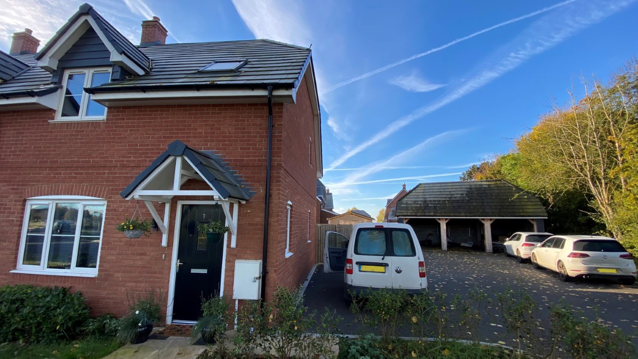

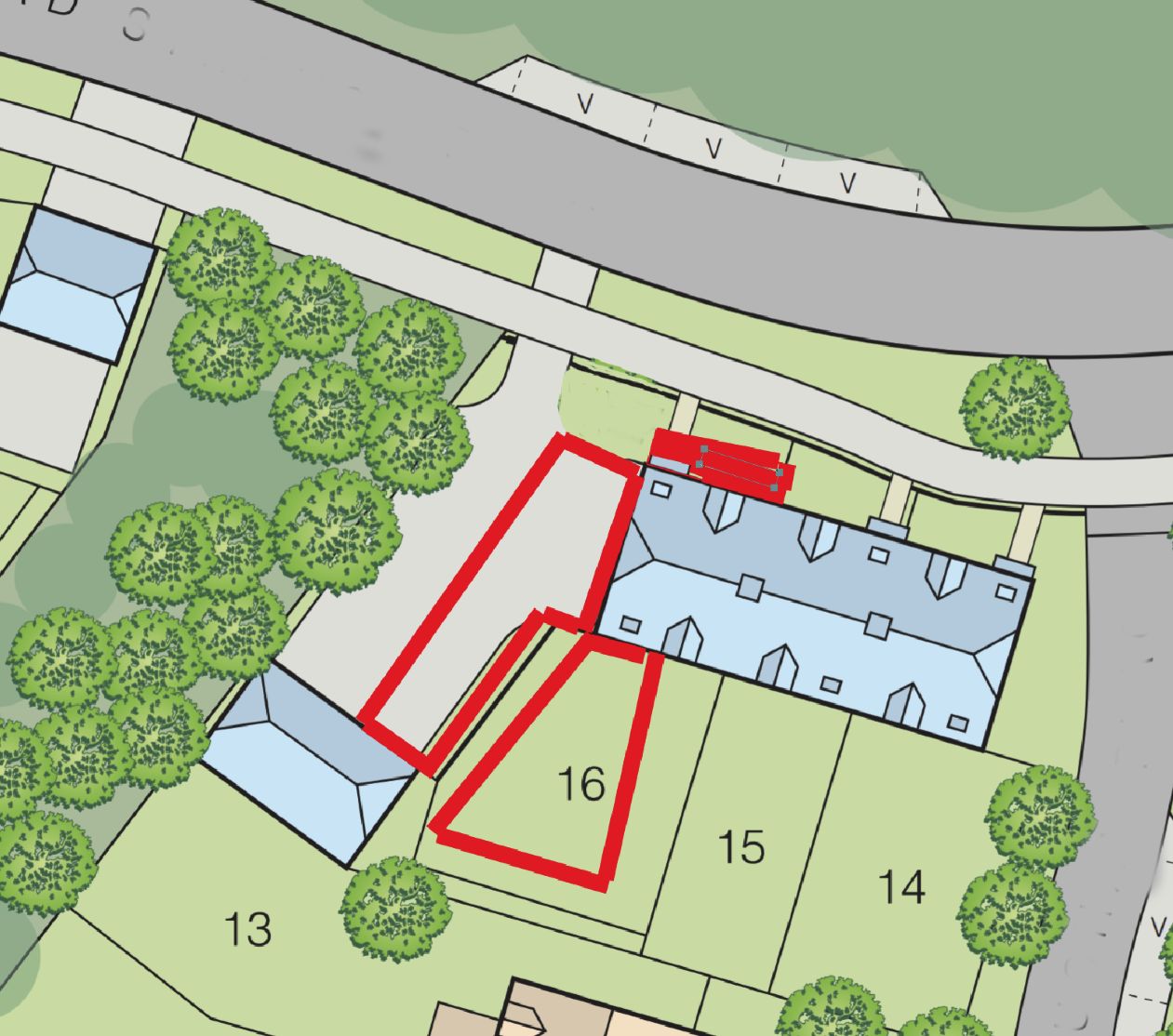

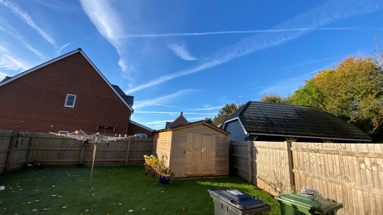

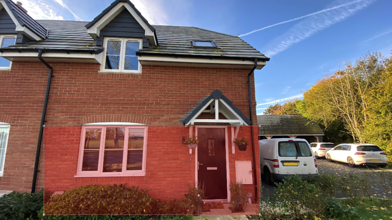

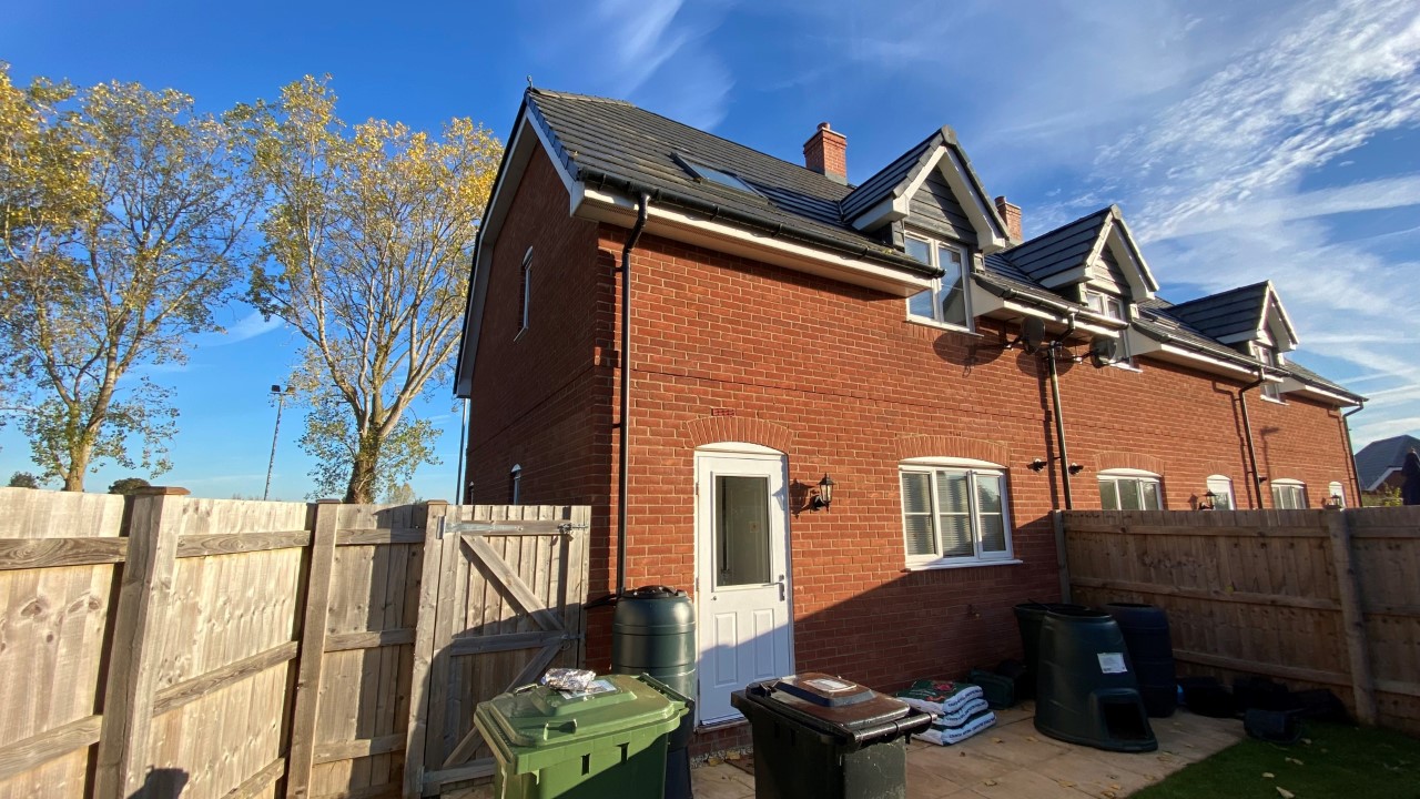

Hello.
I have the following installed in February 2022.
1. A Hikvision DS-7608NI-I2-8P 4K 8 channel NVR with inbuilt POE - Upto 12MP (4TB HD)
2. 3 x Hikvision ColorVu & Live Guard DS2CD2347G2-LSU/SL IP Turret Camera.
There is wiring unused by my front door.
Qu. 1. Is there a doorbell camera that works with my DS-7608NI-I2-8P 4K 8 channel NVR POE to take advantage of the already installed wiring?
If not, I will add another camera, as I have some very questionable neighbours and would like a camera pointing in a different direction out the front of the house.
Qu. 2. The cameras are good, I like the setup it works very well. The firmware has not been updated on the cameras or PVR. Should I do this?
Qu. 3. Should I upgrade the cameras with better resolution? Its 'OK'. But number plates are a bit off at night.
Qu. 4. possibly a more panoramic camera to replace the front?
Thank you all.
