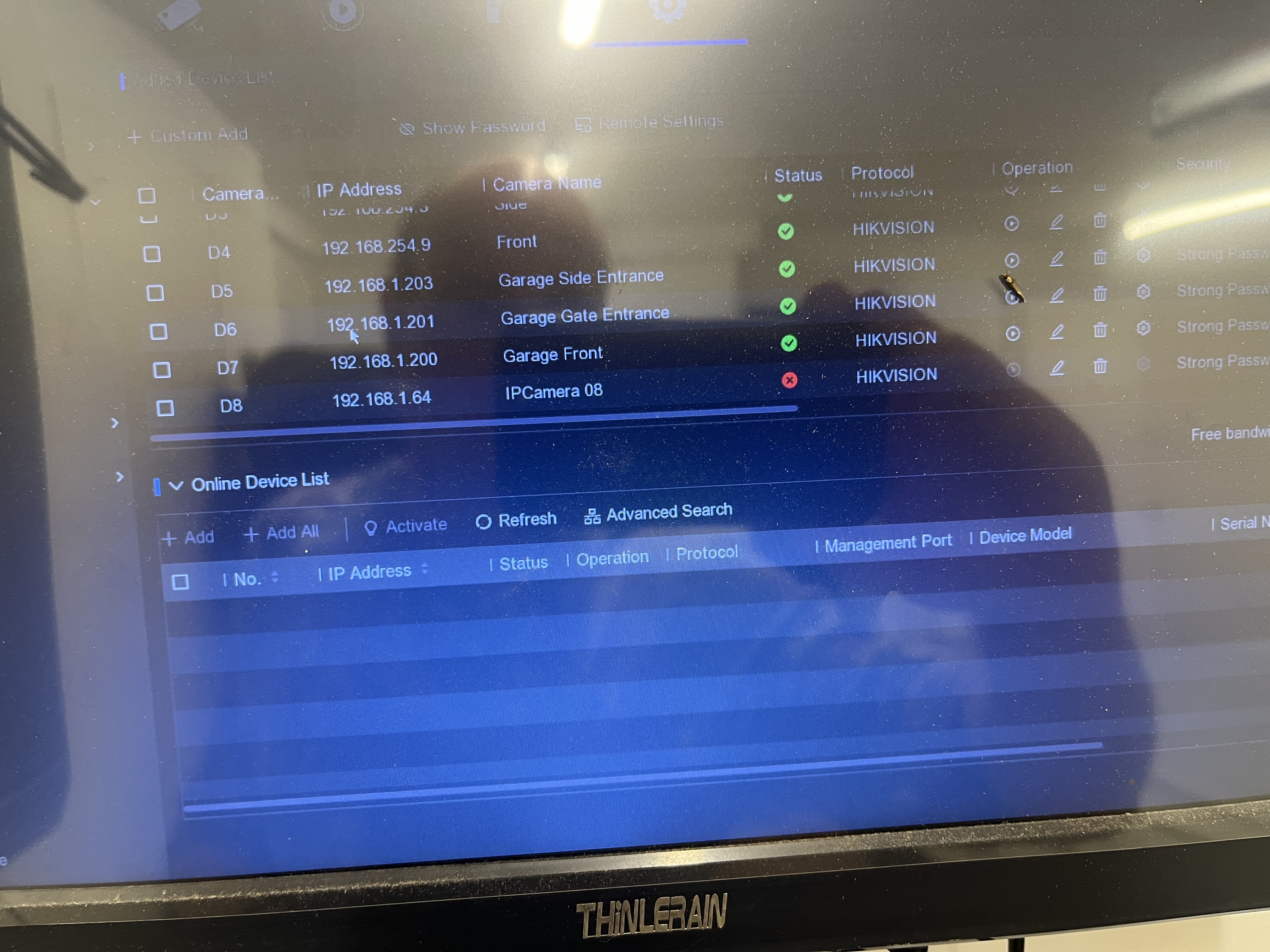

Are you able to confirm the exact model number of the PoE switch? We need to check the specs of the switch because it will have a PoE budget and having 8 cameras connected might be exceeding the maximum PoE output of this switch.
Also, can you please log in to the NVR, go to Configuration > System > Camera Management > PoE Channel, and share a screenshot of that menu?
Hi Dan
Here is the POE switch which is just a standard 8 port switch - as far as I can tell by switching the cables around all the ports work and the switch has capacity
On the NVR my menu is slightly different but is this what you need?

Hi no it doesn’t if I take all the other cams out this one still is dead ie no lights on thr switch port. This is odd as when I plug the cam into the back of the NVR I can activate it and I can see it on Sadp as well as being able to access it via a web browser using the IP address. However when I connect it to the switch I get nothing.
Out of ideas so going to have to call my installer I think who set this up. So much for plug and play!

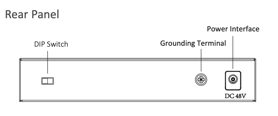

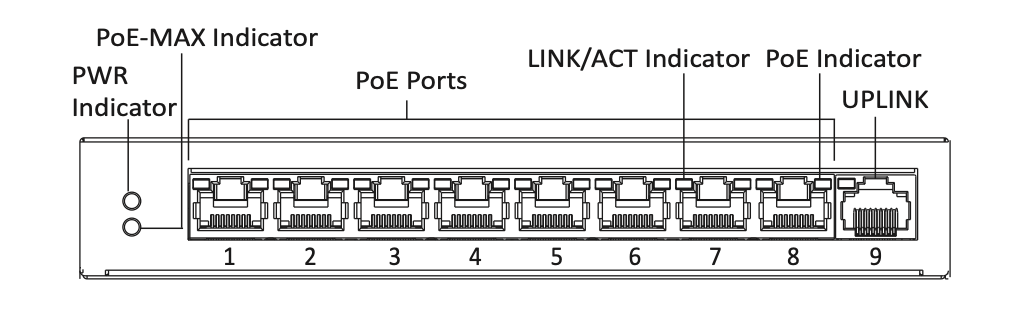

Just to check - your PoE-MAX light isn't coming on when you connect this camera? (It shouldn't - but just seeing whether the PoE switch is getting something wrong)
And is the rear dip switch off for long range?
I don't think either of these things should be an issue - but trying to rule everything out.
I know the Hilook switch doesn't have any option to upgrade firmware. Is there anyone you know with another PoE switch you could plug the camera into just to see what it does?

Thanks for reply. No the POE max is not on and dip switch. I have tried the camera with a POE injector and also nothing. Could it be a password issue? The NVR was set up by an installer. I have added the camera using my password which I have an another user but I don’t have the admin password.
