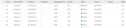

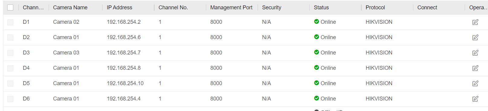

Please see screen shot in attachment

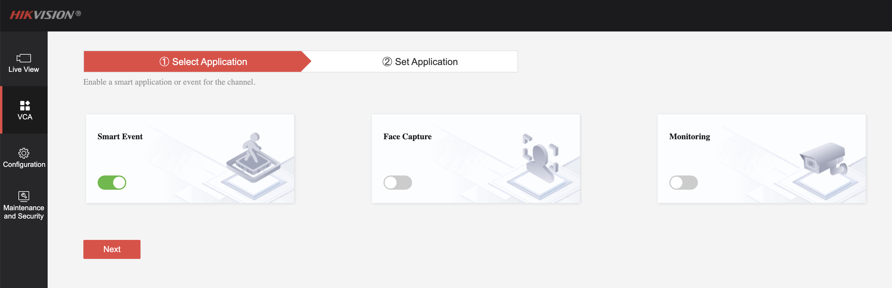

To use Face Capture, you need to log in to each camera and switch them from Smart Event to Face Capture (see the below screenshot from the camera settings).
To log in to directly connected cameras you will need to enable Virtual Host in the NVR which creates virtual links to login to each camera.

Enabling Face Capture will disable Smart Events, that's why there are separate options in the above screenshot. If you click the slider to enable Face Capture it will untick/disable Smart Event.
