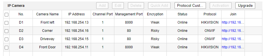

Two cameras (D1 & D4) are still hikvision original, haven't replaced them yet.
D2 & D3 are the problem ones

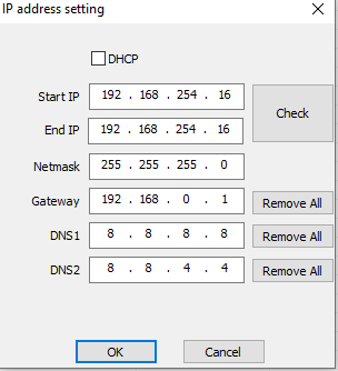

This is D2 camera network settings (using ajdevtools, SADP doesnt seem to work for these hik-oem cameras)
I tried changing the camera's IP in just camera management and then both camera management and cameras network settings. Same results as before.
Can confirm it would be same subnet address as previous cameras as I dont understand them and figured I'd just copy what worked previously for the camera's settings
okay, the possible problem might be the gateway address.
I can see from the above screenshot that the camera is still set to the local network gateway address (192.168.0.1) and this needs to be set to the NVR gateway address.
You can confirm the NVRs gateway by going to the NVR network menu where there should be an IP address labelled as something like "Internal network card IPv4 address" and it will probably be 192.168.254.1

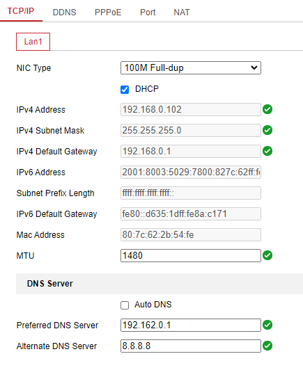

Upon checking NVR network settings, its set to DHCP (I read somewhere DHCP may not be the best?) and gateway is 192.168.0.1, matching the cameras gateway

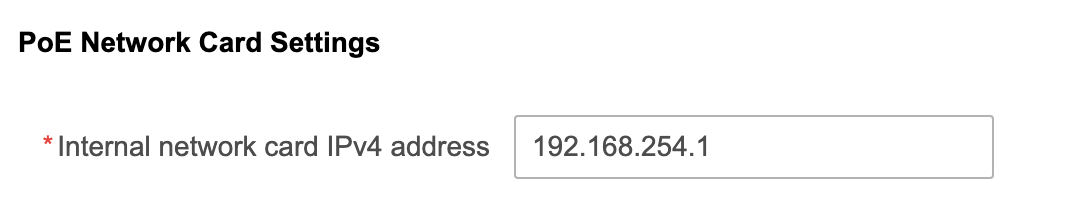

Yes, that is the correct local network gateway for when you are adding cameras from the local network, but if you are plugging the cameras into the PoE ports on the NVR they need to be set to the NVRs subnet gateway. It should look something like the below screenshot and should be found under the DNS server settings:
If you don't see this information then please just try setting the camera's gateway to 192.168.254.1 and try connecting the camera to the PoE ports again.
