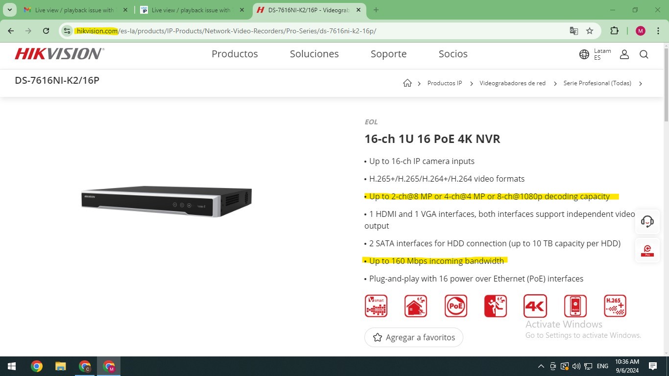

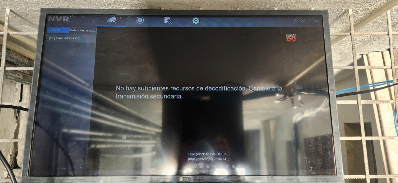

I bought an NVR and 16 ip cameras for my office (specs and config below). I don't have any problems using live view or playback through my cell phone (hik connect) or through the web browser, with either main stream or sub-stream settings(specs and config below). When I try to live view 4 cameras on the tv (2*2 grid) with main stream settings I get the message "not enough resource for decoding. Try switching to sub-stream". With sub-stream settings the 4 cameras work fine.

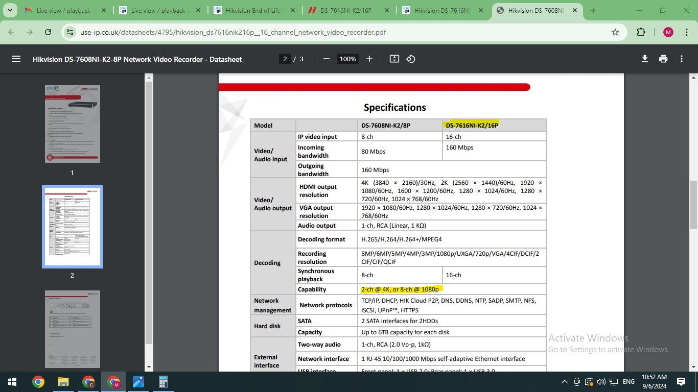

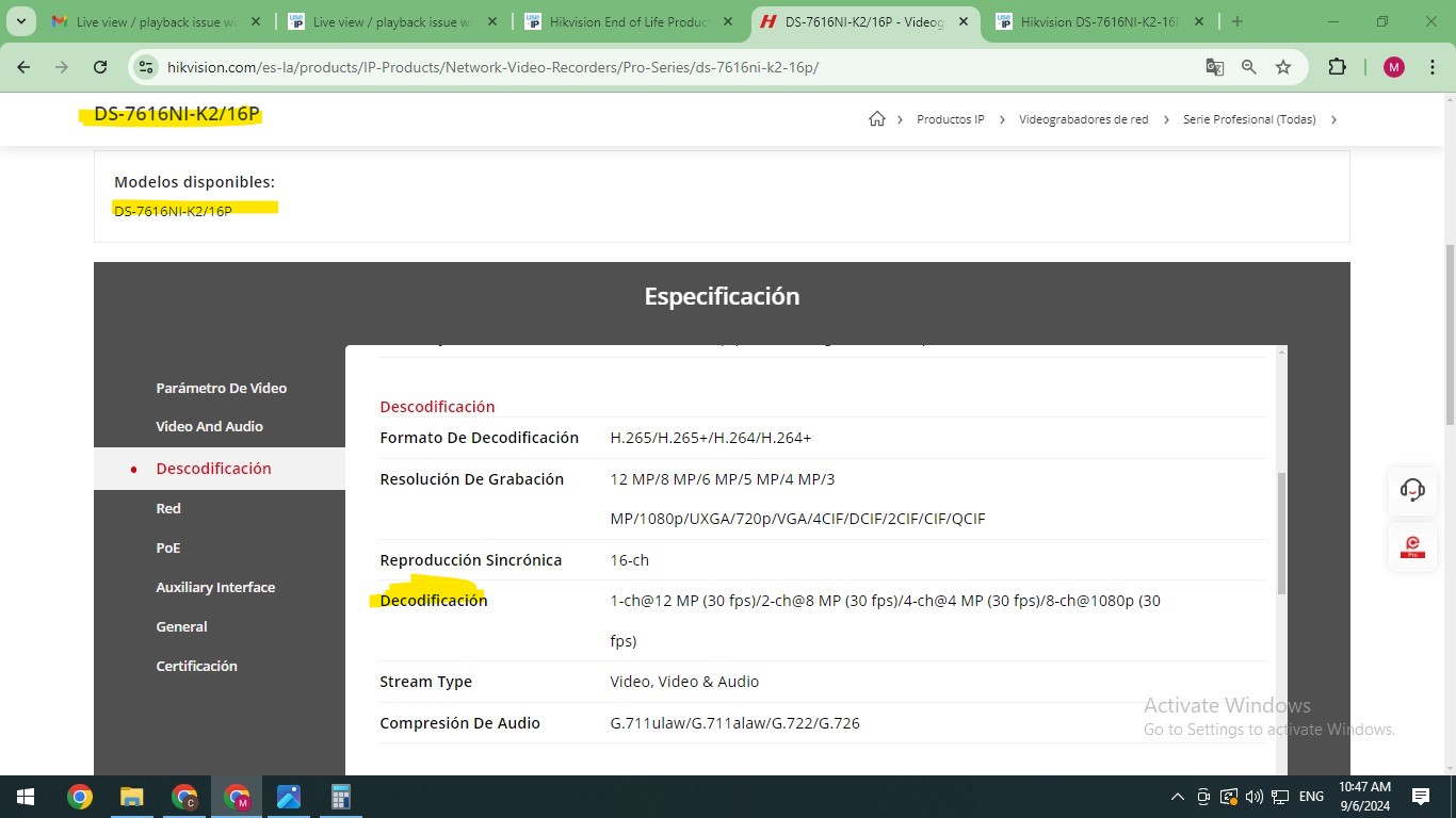

The NVR specs says 1-ch@12 MP (30 fps)/2-ch@8 MP (30 fps)/4-ch@4 MP (30 fps)/8-ch@1080p (30 fps) so I shouldn't have any decoding issues. I cannot live view or playback even 1-ch@4MP 20fps.
If I switch the main stream settings of all the cameras to 1080p I can live view only 1 camera on the 2x2 grid.
If I switch the main stream settings of all the cameras to 720p i can live view all the 16 cameras on the 4x4 grid.
If I reboot the NVR I do get live view from 2 the cameras on main stream and the other two display the message "not enough resource for decoding. Try switching to sub stream", and if I log in the system the two working cameras get the same error.

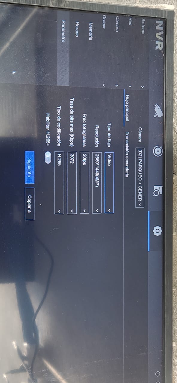

CONFIG MAIN STREAM
2560*1440
full frame (20fps)
4096 kbps
h.265
CONFIG SUB-STREAM
1280*720P
20fps
800kbps
h.265

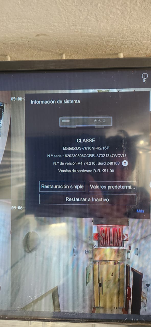

Hi @Mavyppoh
Can you please share a screenshot of the NVR's Basic Information menu and also the datasheet where you found that decoding information?
Hello @Dan
Thanks for you help. As I can tell from the specs I should be able to live view at least four cameras at 2560 x 1440p @30fps, or at least 3.
At 1440p 0 cameras are display on the screen.

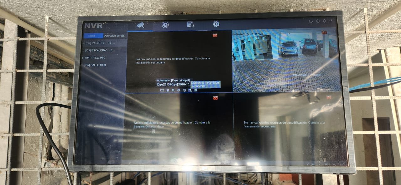

At 1080p only 1, which is crazy and makes no sense at all.

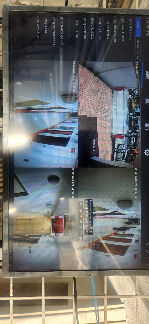

At 720 I can watch 4, did not try more than four with main stream settings but I can live view all 16 at sub-stream settings (720p 20fps 800kbps h265).

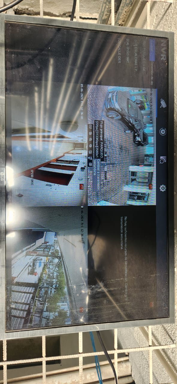

No the crazy part. I disconnected 12 cameras from the rack and left only 4 working. I get image from 3 cameras at main stream 2560 x 1440p 20fps. I plug in the missing cameras and the live view continues. If I touch anything on the screen the image goes back to the error.

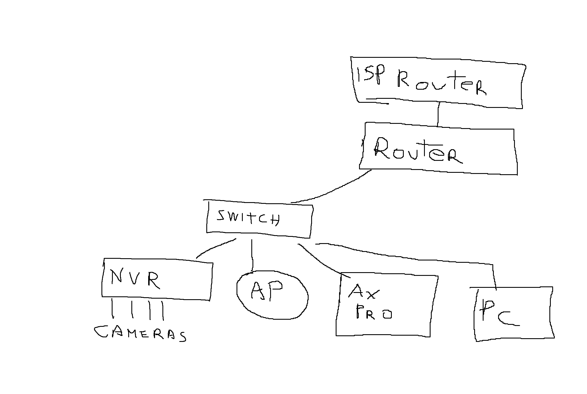

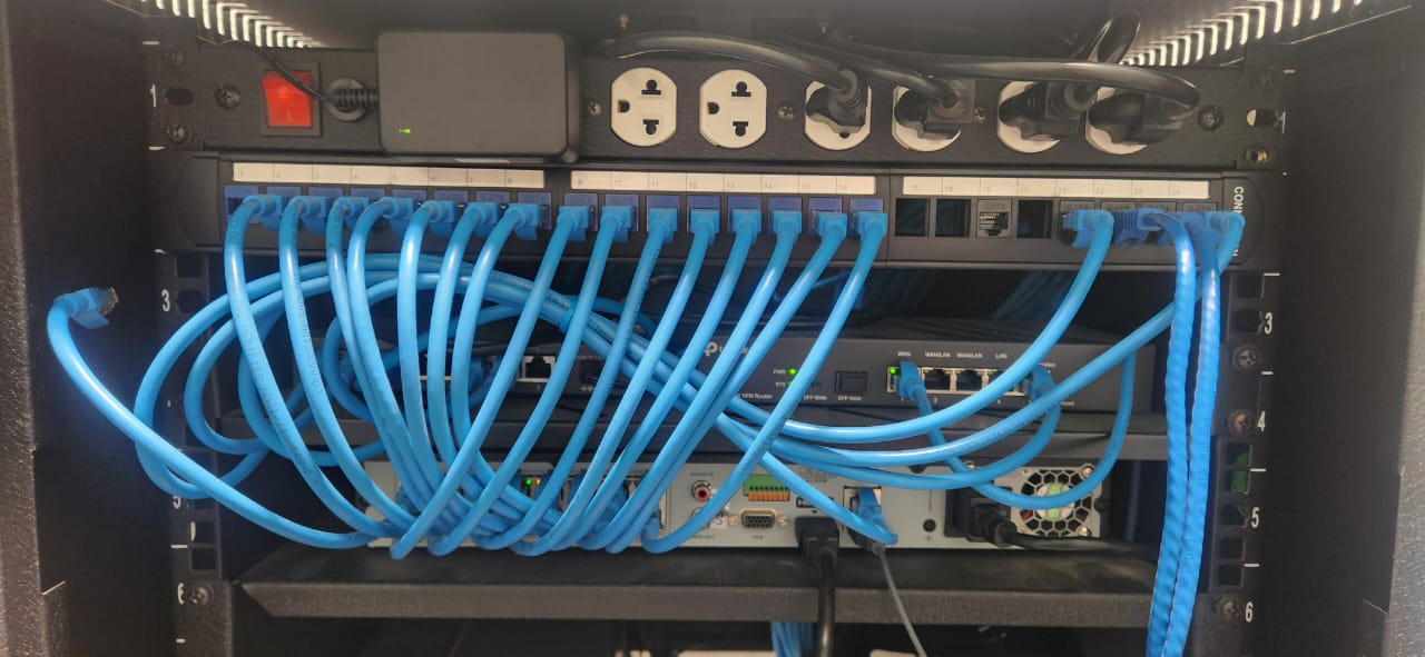

You mention your cameras being connected to a rack, are all the cameras for this NVR connected to a separate PoE switch?
Can you please explain your system/network layout? (e.g. draw us a rough sketch of how your cameras, NVR, switch, router, and any other network hardware are connected)
Thanks @Mavyppoh
Hi @Dan
Thanks for your time and knowledge.
Yes, my system is in a rack (photo attached) but all the cameras are connected to the NVR since it has 16 PoE ports.

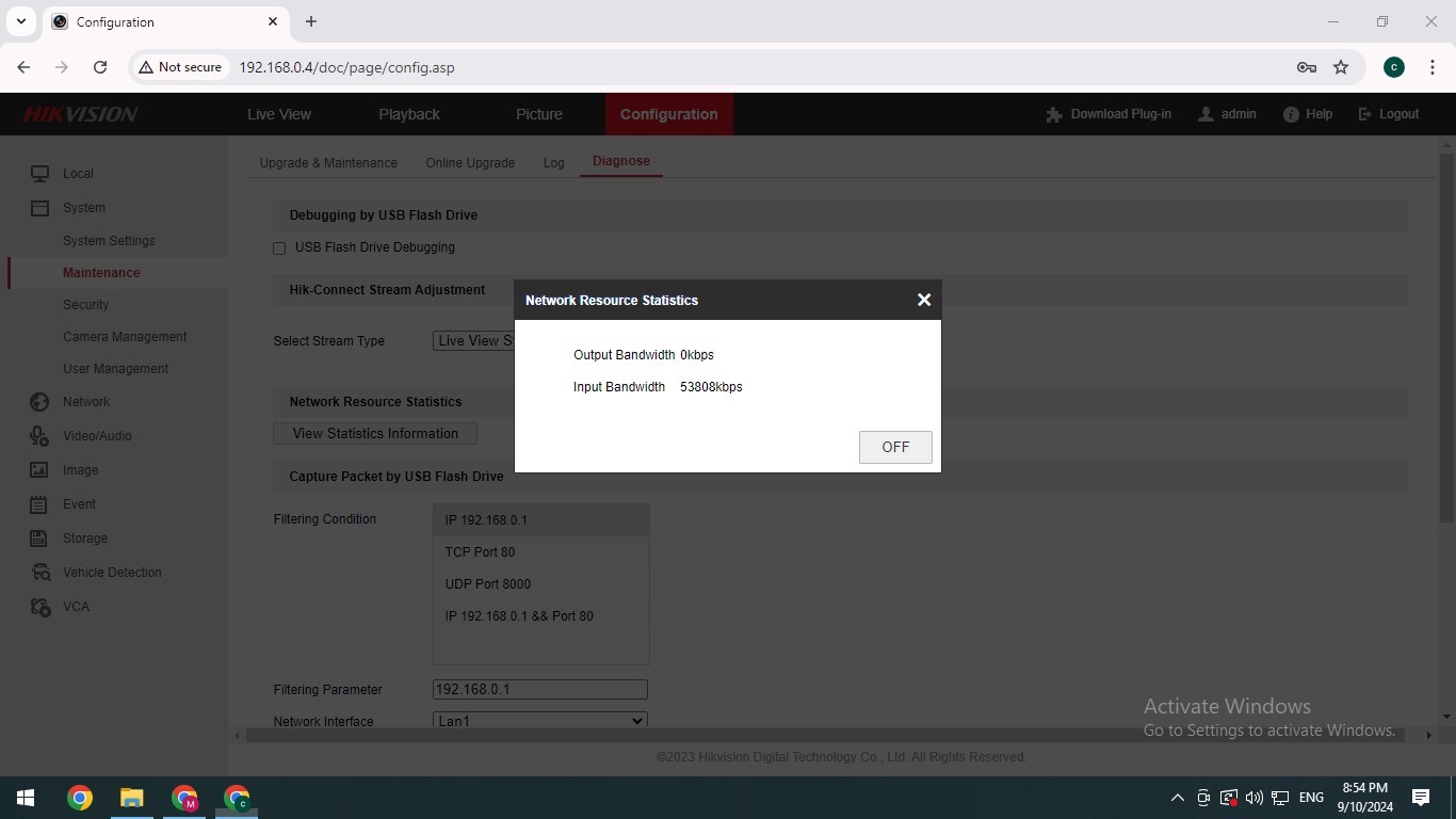

@Dan
I thought it was the Incoming bandwith but right now it's at 53808 kpbs out of 160000 kbps.
Might the NVR be damage?
