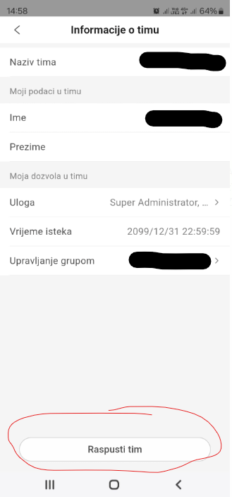

I don't have the disband option inside the info. Only team name, first-last name, role, expiry time and group management
My app is not on english, but once you click on team information you should have the button bellow:
Did you even finish the team mode creation? Are you able to switch between modes at the top left corner when on main dashboard?
Perhaps its not yet synced on server that you have created a team, maybe you just have to wait a bit before deleting. Or it could be regionwise options which works differently for me than for you

I think i have finished the team creation. Yes i am able to switch between personal device and team. It doesn't make any sense to be regional issue.

Ok i did it. My fault was that i was at personal device page and not teams. When i chose teams page and me i could see the debund option
