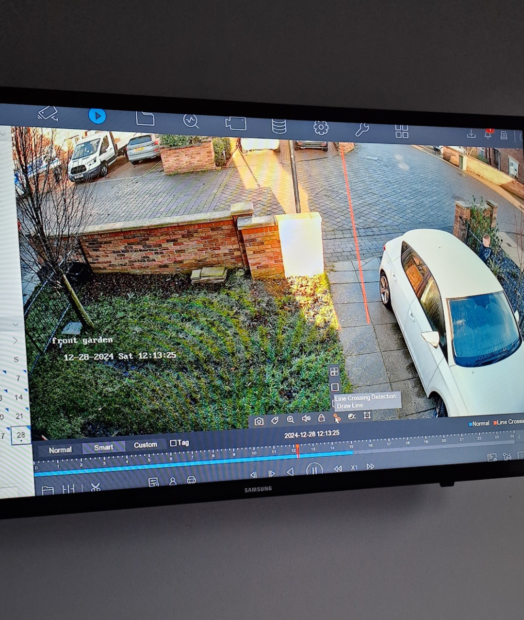

What @Vauxfan should see is similar to you, however when he selects Vehicle/Human, the red markers on the timeline should update/change according to what filters are set in his pre-configured events (as your G1 ColorVu doesn't have AcuSense whereas his G2 [with G5 firmware] does). This statement:@Vauxfan
my firmware is V4.61.030 build 240123.

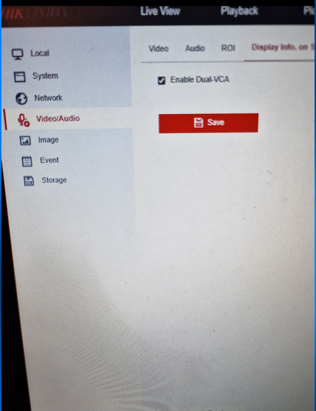

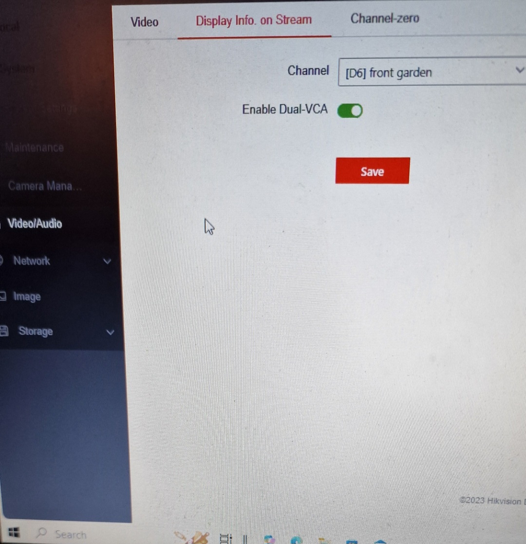

Camera connected to the NVR is a DS-2CD2347G1-LU, firmware V5.6.6 build 210625, set for continuous record, dual VCA box ticked.
playing back at the NVR with smart selected and human / vehicle not selected, I have a continuous blue line with red intrusion events on it. These events are anything that moves in the box. Selecting human or vehicle / human & vehicle the red lines disappear, leaving the continuous blue line.
Does that help?
David
makes me think that it's working similar to yours as it should in playback. The issue is doing a retrospective VCA/motion search where you define a line on screen during playback. It should (using the dual VCA and save camera VCA) display anything that crossed that line, human, animal or otherwise. It's that search that doesn't work for him.normal smart will pick up me crossing the line intrusion but nothing else.
