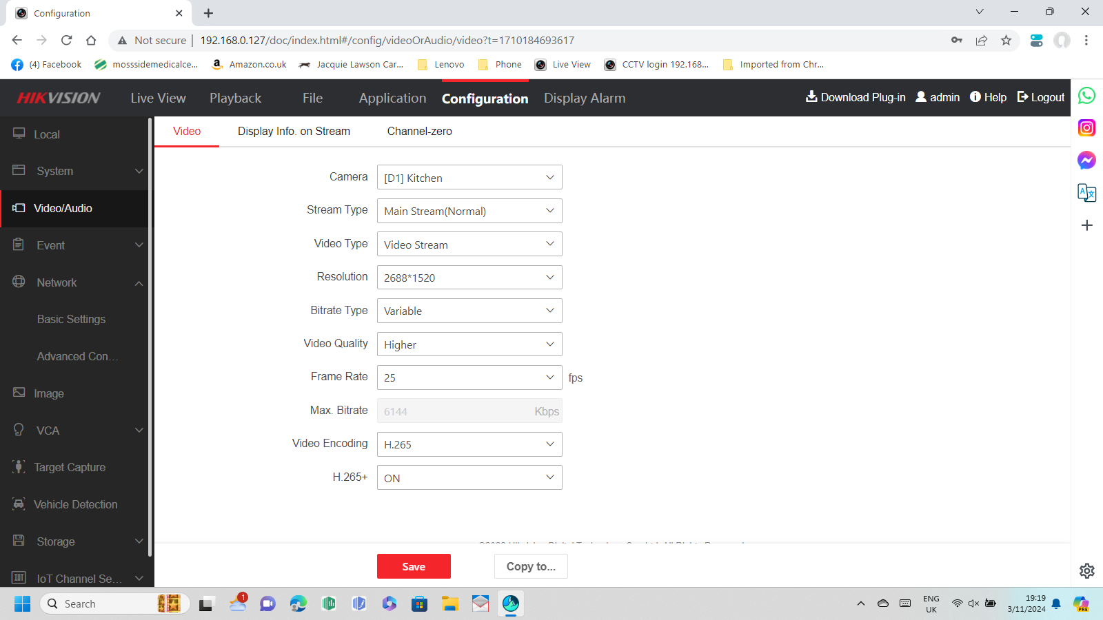

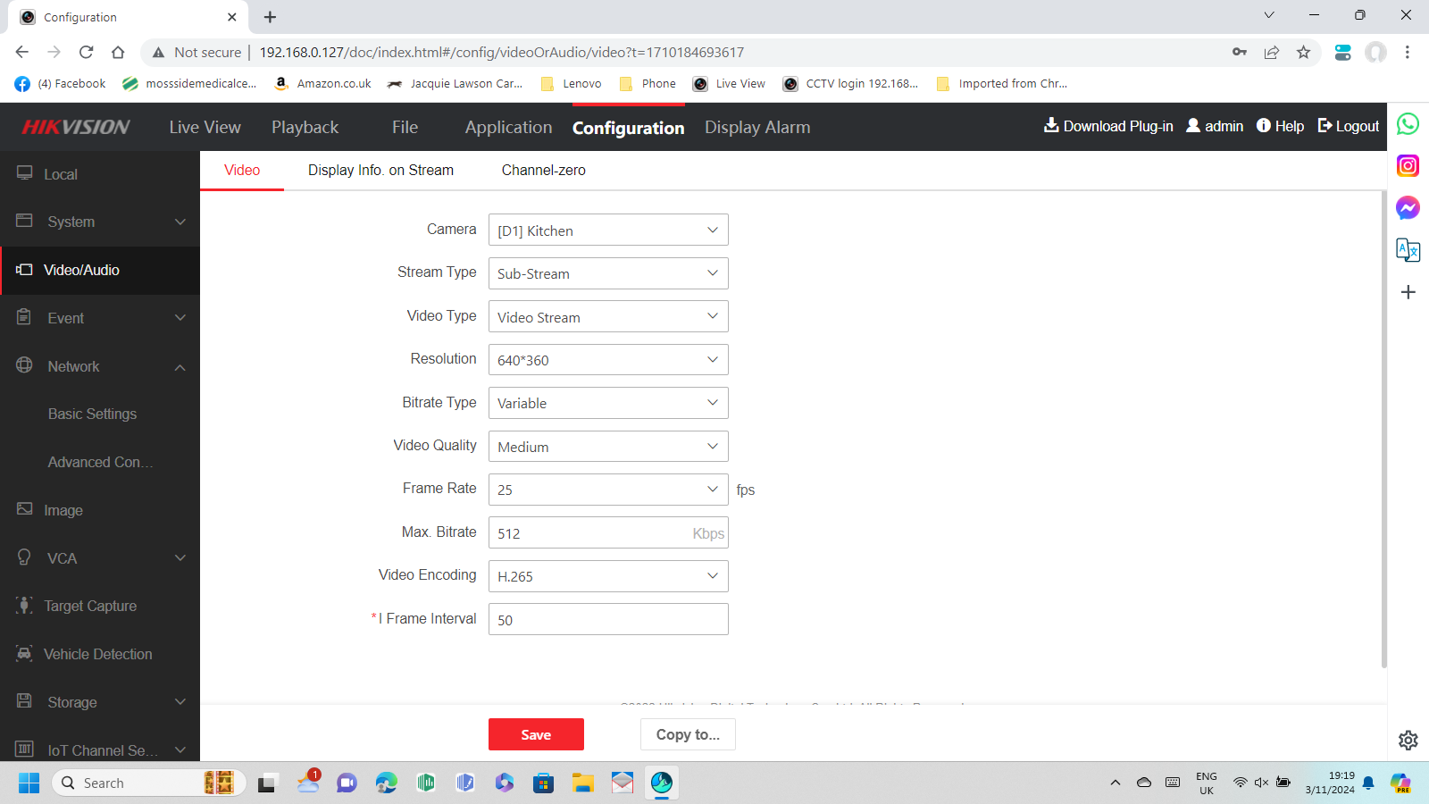

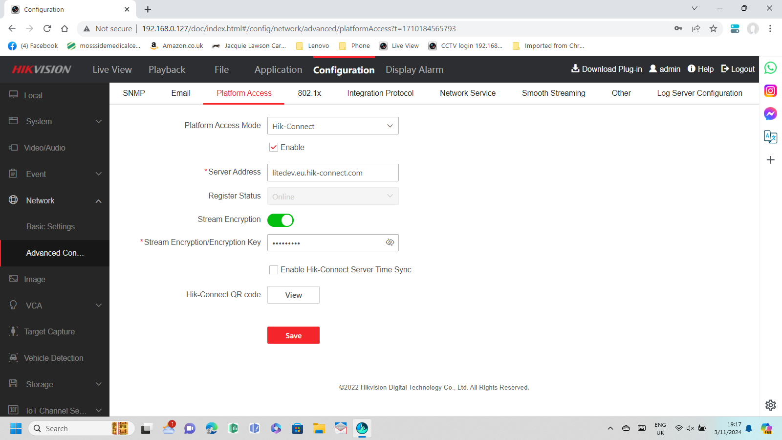

Hi Guru, I have attached my Platform Access screenshot, and my screenshots for both Main screen & Sub screens. This shows the Kitchen, but all the other cameras are the same set up. Is there anything obvious?
There's nothing standout terrible in the settings but a couple of observations:
Hik-Connect - You have Stream Encryption enabled. There's nothing wrong with that, but it will add 'overhead'. The images being encrypted and needing to be decrypted on your device requires additional processing, so that may cause issues from time to time. Many will swear it's essential; personally I never use it. If someone wants to intercept my camera stream and keep an eye on my car for me I'm fine with that :) (though I consider it unlikely)
Main Stream Settings - A couple of points:
  • You mention in your earlier post that this is a 2387 (8MP ColorVu turret). The main stream settings show that it's set to 2680 x 1520, which is 4 megapixels. So either you have an 8MP camera set to 4MP or you've a 4MP model. (8MP would be 3840 x 2160)
  • Secondly you have H265+ turned on which I always advise against. It uses higher compression and while it saves on disk space due to its bit rate management, it takes more processing to encode/decode. It's also been known to cause unwanted artefacts/glitches in images. I would switch off the H265 + so it's standard H265. Match the I Frame to whatever frame rate you choose (the frame rate will then dictate what the max bitrate [currently greyed out in plus] needs to be)
  • You probably don't need 25FPS and sometimes it can be better to use a lower frames per second as then each frame has a higher portion of bitrate available. That said I have most of my cameras at 25FPS....
  • Whatever the Main Stream (normal) is set to, it's important to ensure that Main Stream (event) matches. It usually happens automatically on recent firmware, but if it's different it can cause a mess with motion detection etc, as the bitrate and compression level can be switching whenever there's movement.
Sub Stream Settings - They're fine but I'd usually just use 12FPS. Sub stream is really for mobile phone use so speed of connection and fluidity is more important than quality when the mobile network may be saturated.

I'd first try switching off encryption under 'Platform access' then disable H265 plus
Fantastic. Although the system seems to get it's knickers in a twist during the change, I have turned off the encryption and turned H265 to off on the 4 cameras. After ensuring I could update them in "Smart Event" with "Line crossing" if needed in future I increased the resolution to max. All cameras currently displaying in HD. I will try again after about 10'ish in the morning and let you know if they are still working in HD.
