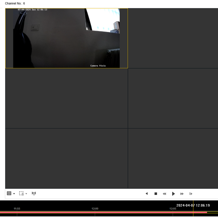

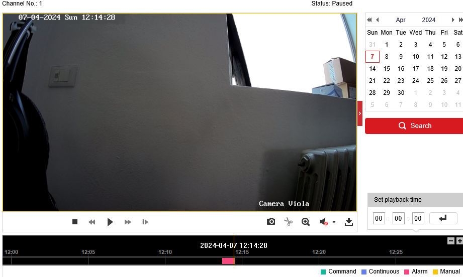

Now I have 2 footages of the same event, one on the HDD (that I can sse from the NVR webpage-->Playback) and one on the SD card (that I can see from the camera webpage-->Playback).
Unluckily, still I cannot see the footage through the iVMS, Remote Playback.

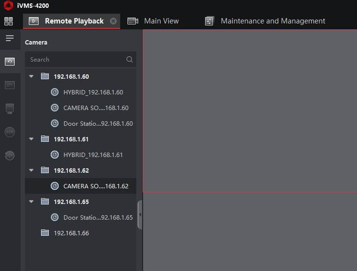

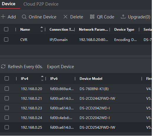

It works like a charm, now! Thanks for all of your support.
