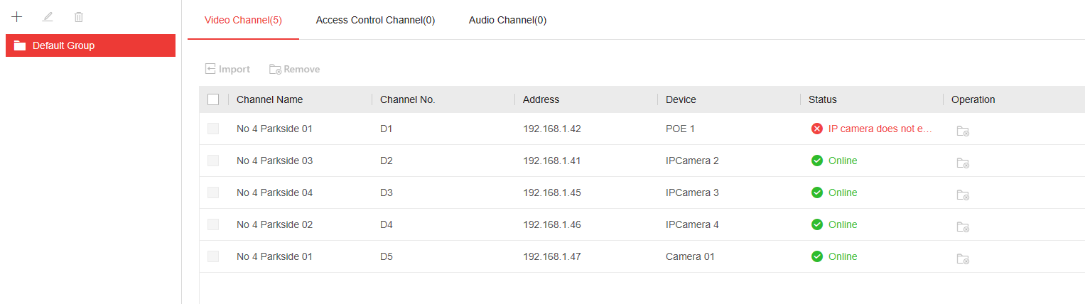

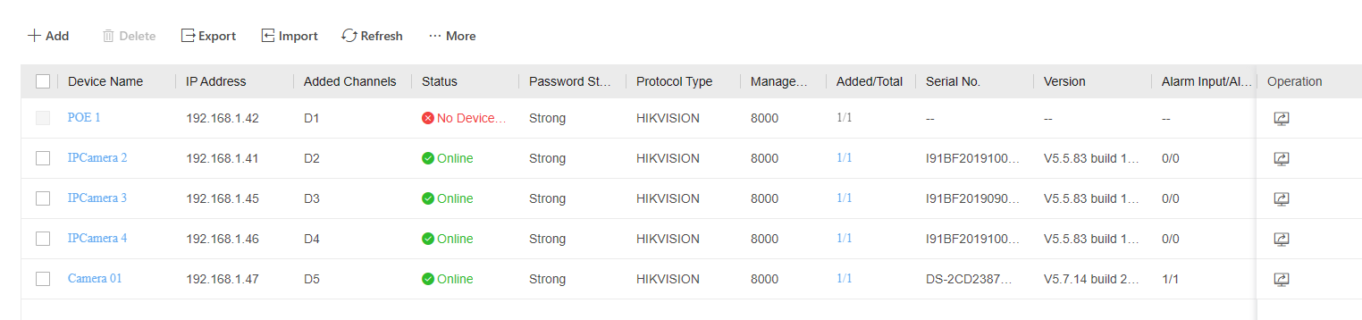

I installed V5.02.000 build 240229 on my DS-7608NI-M2/8P and I have two issues.
1 The NVR did not recognise one of my cameras, saying either No Device or IP camera does not exist. Ironically, the camera is the only Hikvision one that I have so far (DS-2CD2387G2H-LISU/SL). Rebooting it did not work. SADP listed the camera with the correct IP address and gateway. I used SADP to change the IP address but the NVR still did not recognise the camera, although SADP , and my router, did. I was able to add the camera manually but I had to use Remote Configuration to add the DNS server, which had gone missing, before it connected. I can't delete, or edit, the old listing for the camera so I appear to have five cameras but only four of them work.

I reset the NVR to default and all the cameras are connected and properly identified. But when I was connecting them the NVR assumed that cameras 3-4 had the same password as camera 1. So I accessed cameras 3-4 via their IP addresses and changed their passwords to match and everything was OK.
NVR PoE connected cameras and LAN connected cameras are added differently now. Any manually configured camera (not plug and play) whether on the LAN or connected to the NVR PoE ports has to have Plug and Play switched off under:
Device Access > Device Configuration > PoE Settings - 'Network Camera Plug and Play'
(So you can do that for your 'ghost' camera that can't be deleted). Manually configured cameras can be then added in:
Device Access > Device > Video Device using 'Add' or the 'Online Device List'

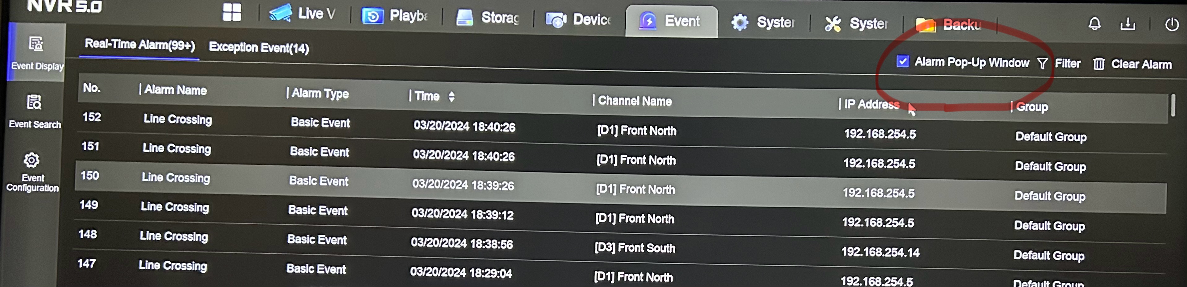

Also looks like the option of full screen on motion has disappeared? Cant see this being a removed feature as its a brilliant feature?
isn't that just a pop up on the corner of the screen saying theres an event? Sorry i might be wrong.
You might be right. Further up this thread or in another I said that when you click the number in the top right corner of the monitor screen, on the old firmware you would have seen a list of the events whereas on V5 there's nothing listed - I though that was a bug - it's not...
It turns out that 'Alarm Pop Up Window' enables the display of that particular event in the event list when you click the bell icon with number indicator. So previously on V4 you could only enable/disable the events that appeared in that list globally by type (motion, line, alarm input etc). On V5 if you want the event to appear in that list (along with a capture of the trigger in the preview pane beneath it), you have to enable 'Alarm Pop Up Window' on the individual event's action.
So yes you're right - it looks as though full screen monitoring got removed (though it may be hidden away in some random menu). My bad.
I wasn't getting any pop-up's until I noticed this checkbox:
I'm rebooting the NVR now... curious to see if it stays checked...

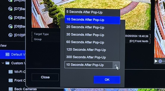

Yes, the "Alarm Pop-Up Window" checkbox stays checked (if it was checked before re-boot) ... when you get a pop-up window, there is an option there to select the number of seconds until the pop-up windows closes automatically:

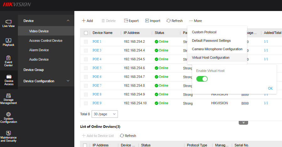

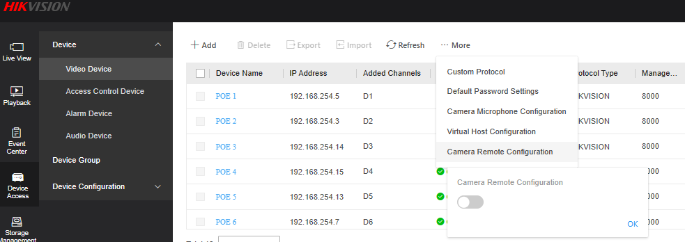

This "Camera Remote Configuration" is a new setting... I'm certain because it was not there when I took a screenshot back in January... I wonder what it's for?
Naturally, I've turned it right on :)

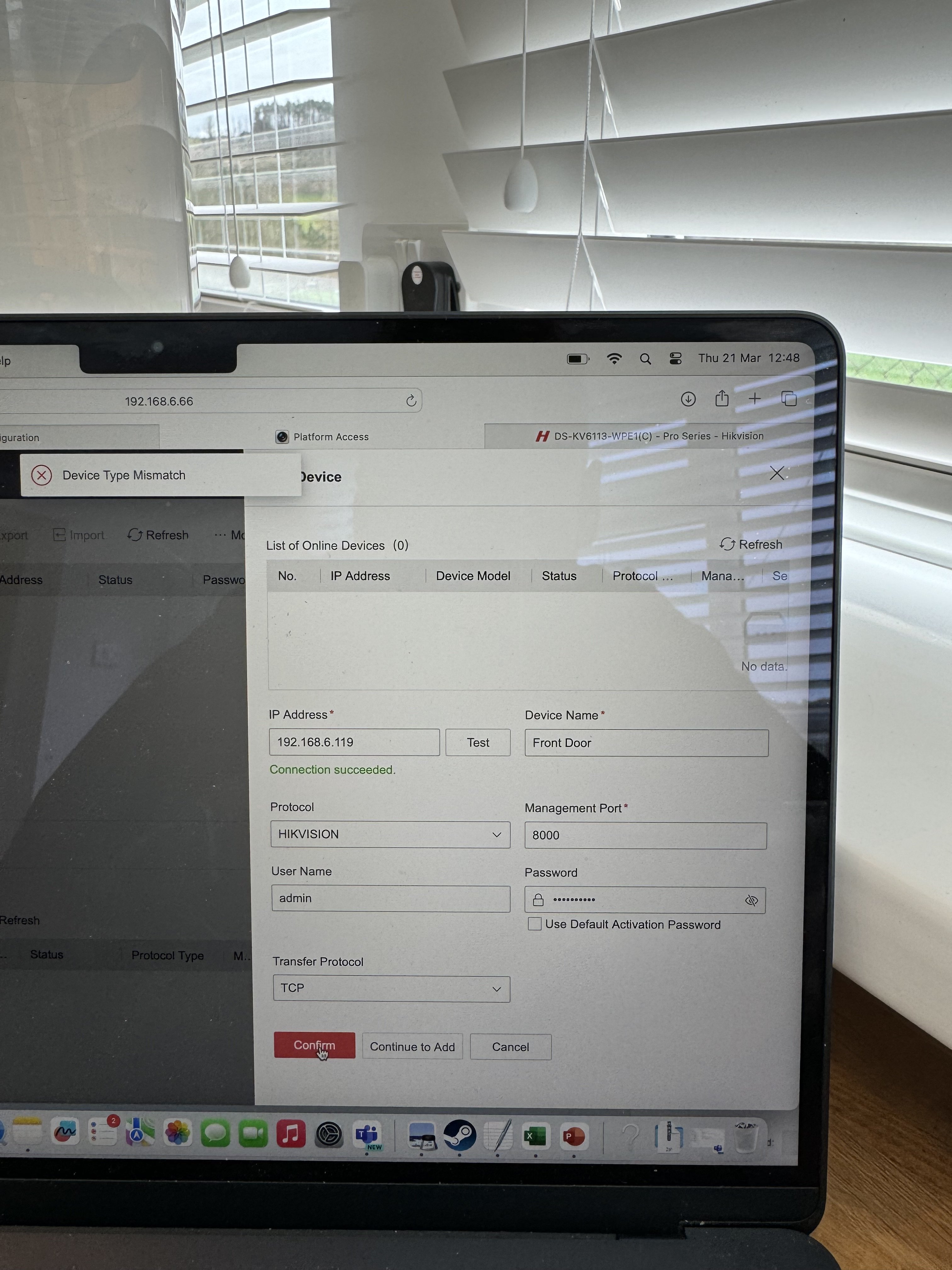

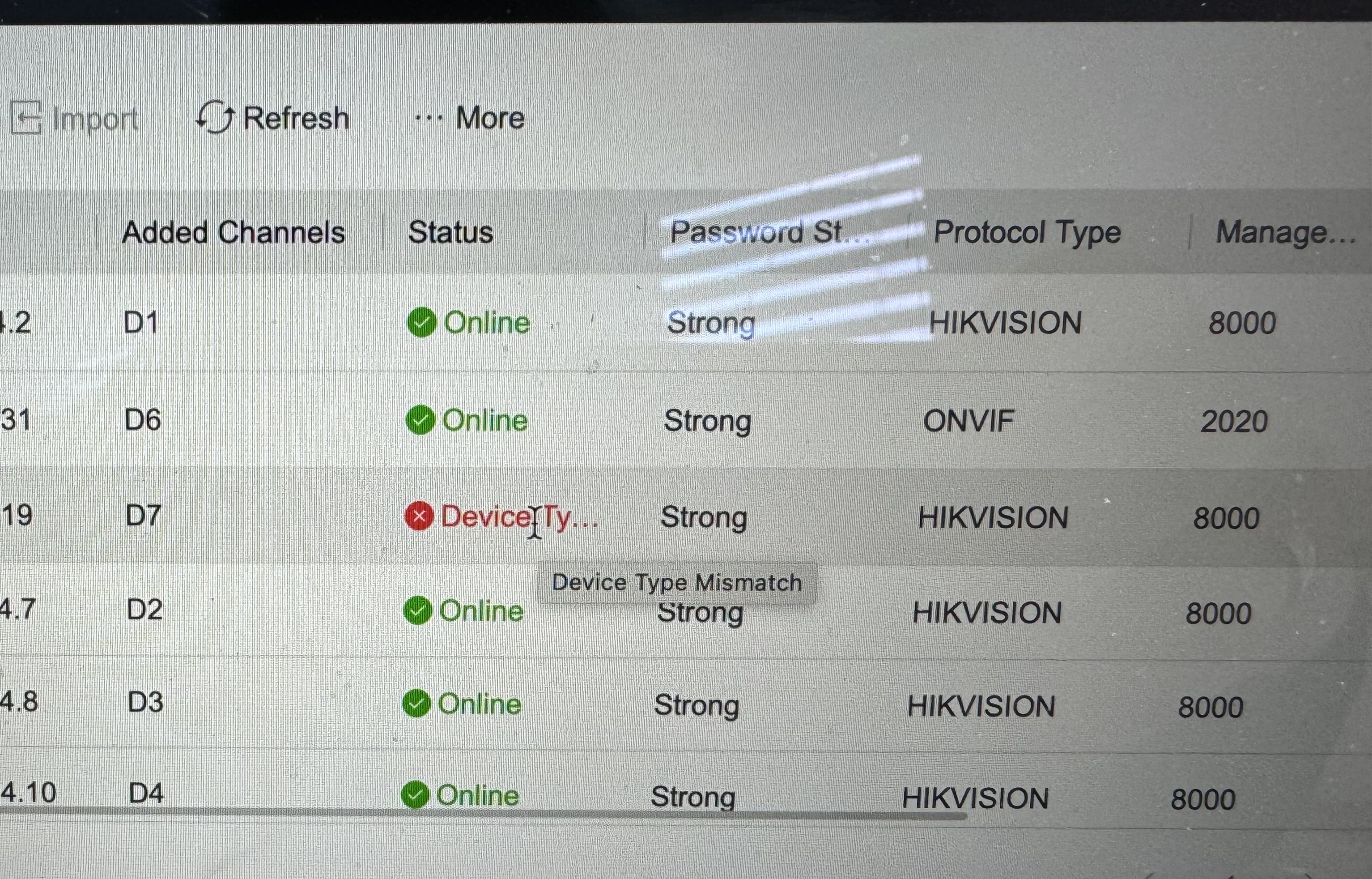

Is anyone else getting this? Doorbell is the WPE1(C)

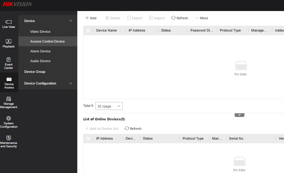

I'm not familiar with these doorbells but until someone qualified comes along... Is there a chance it should be added as an "Access Control Device" rather than a "Video Device"? I wonder if you remove it, would it then show up in the list of "Online Devices" here:
Using an EZVIZ DB1 Pro 5MP on an M2 with 5.02 firmware, it's working fine. The only difference I have in settings is the transfer protocol set to AUTO.
Also noticed, I have an extra button next to the Protocol box with "Protocol Management", are you on the latest firmware ?
Ahhh, you're using the Add screen.
