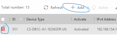

The lower half of the screen shows 3 devices, one being the Door Bell but where do I go from here?
Select the doorbell checkbox and hit the add button:

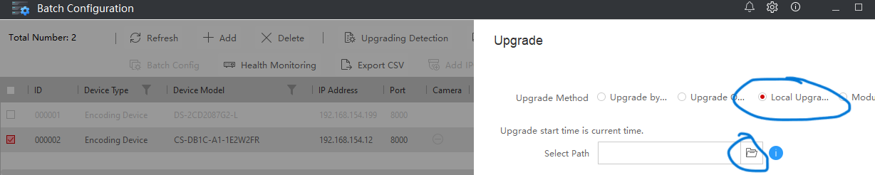

Enter username and password and the doorbell should show up as connected on the list at the top... then select the doorbell there and hit the upgrade button:
Then select local upgrade and chose the .dav firmware file you want to load...
Be careful which firmware you try to load!... I'm going to check now to see what I would try to load if it was mine...
