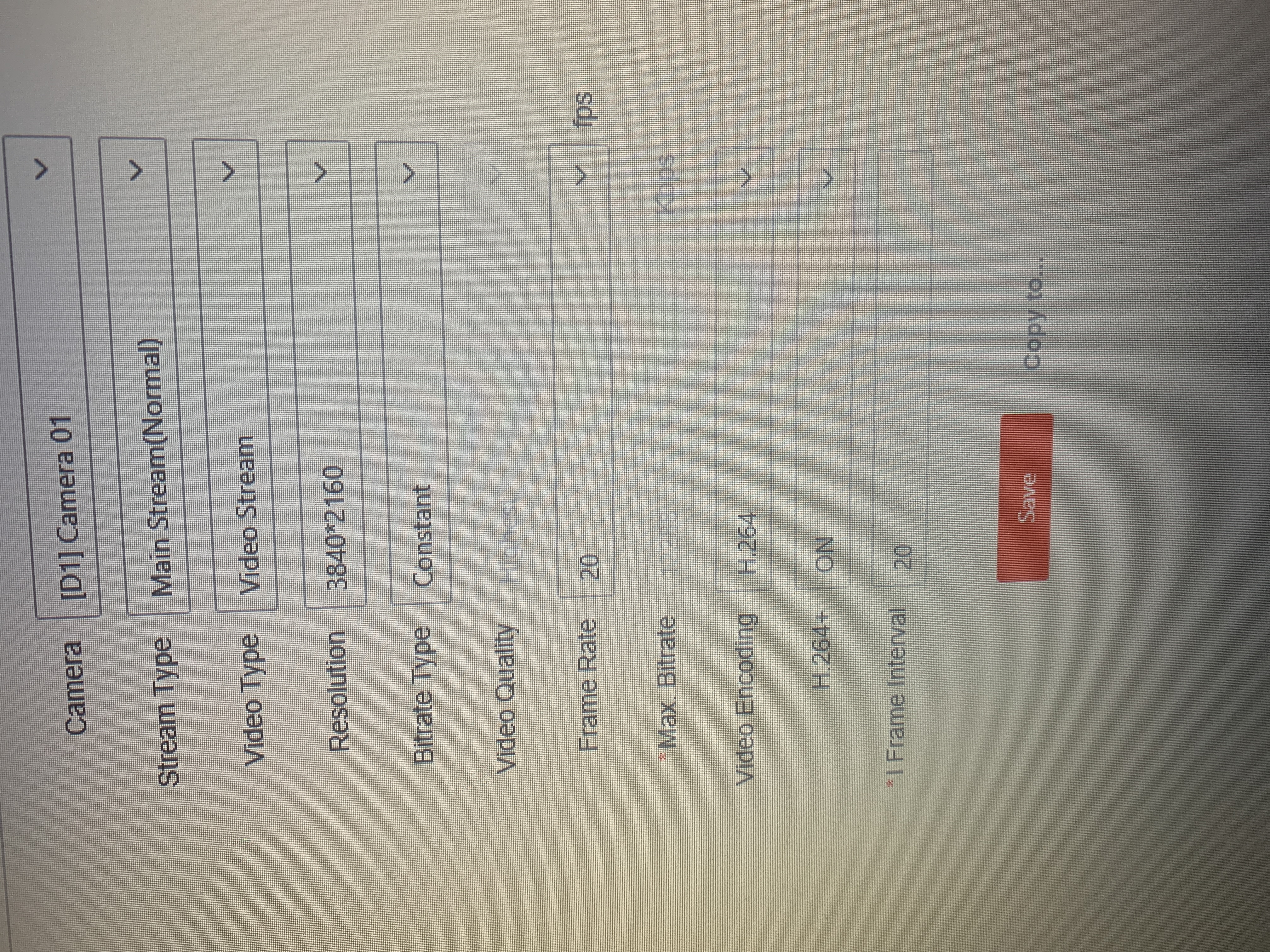

I believe you can download older firmwares from the EU portal but it seems down atm. I’m using these setting which produce no green screen issues.
H264 and H265 is just the compression. The quality should be as good on each

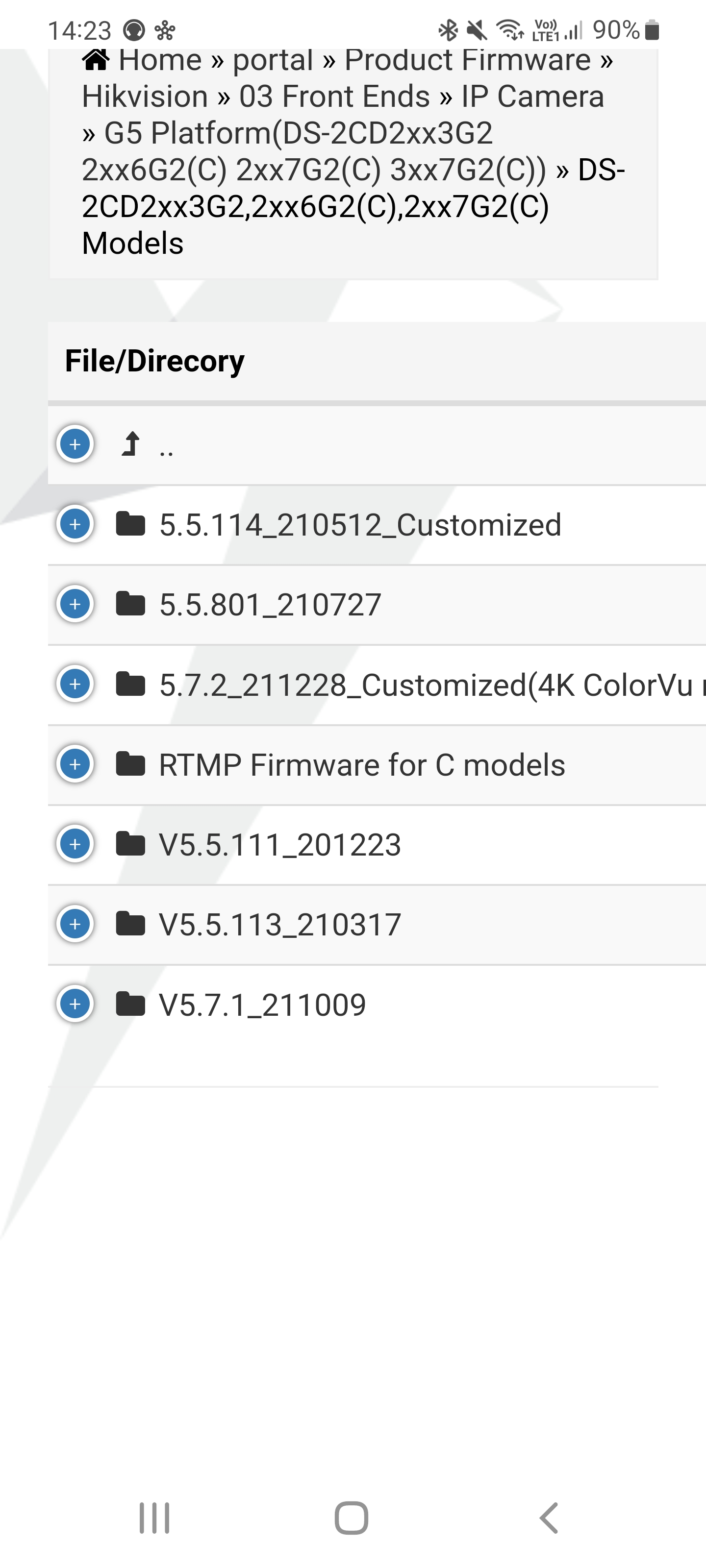

Just realised the cameras are on old firmware, they are on V.5.5.801 210727
Could this be the problem?

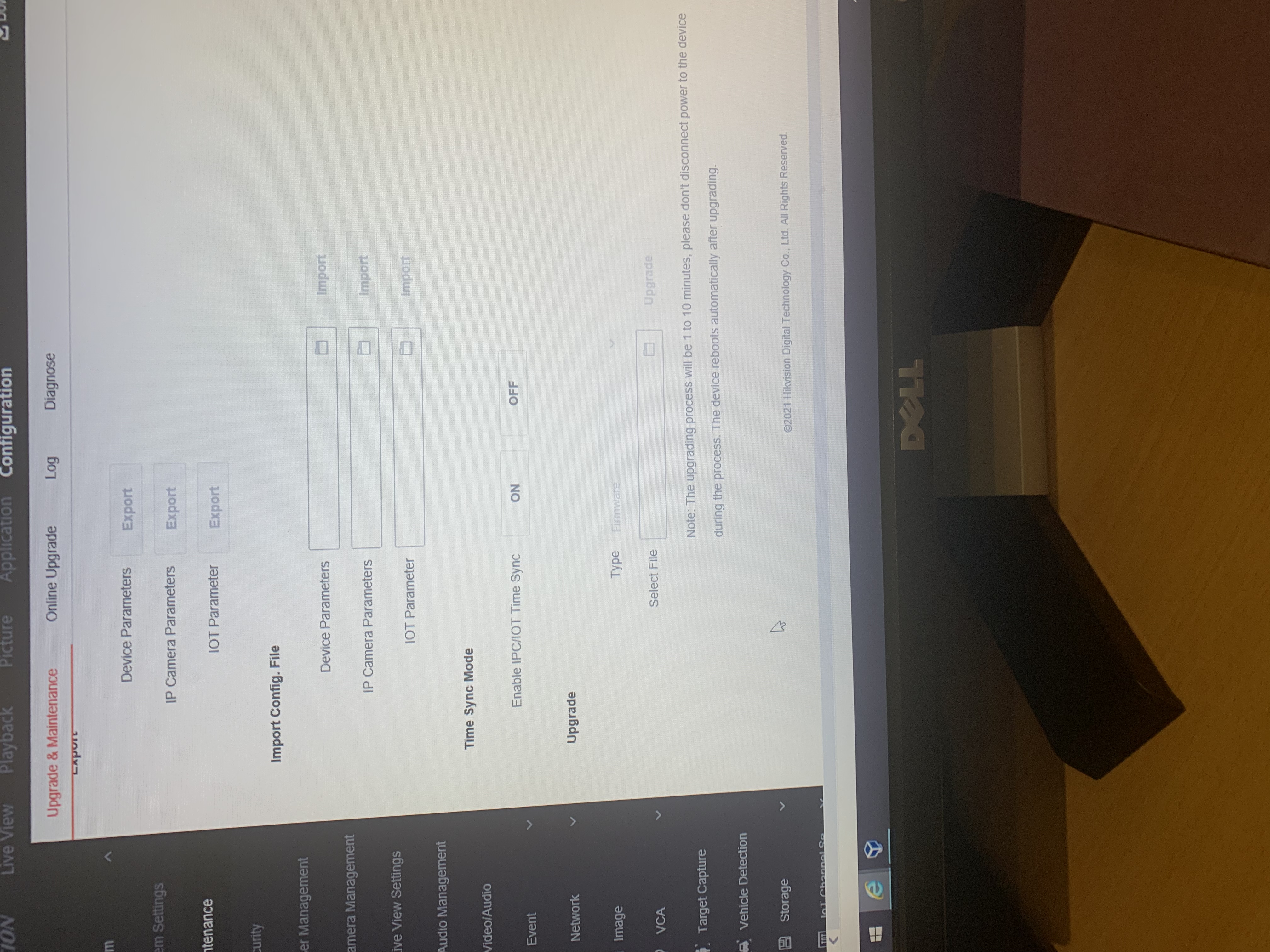

You can get previous versions of firmware here for the 76xx 77xx and 96xx NVR.
You can update as per the attached pic
Let me know if it helps with the issue. At work atm so can’t test it

The camera firmware should be up-to-date, but I would still log in to each and check.
As you have the (C) models the latest firmware should be v5
As you have the (C) models the latest firmware should be v5.7.2
Does this list go top to bottom or bottom to top?
I'm very confused
Current firmware on cameras is V.5.5.801, what do I need?

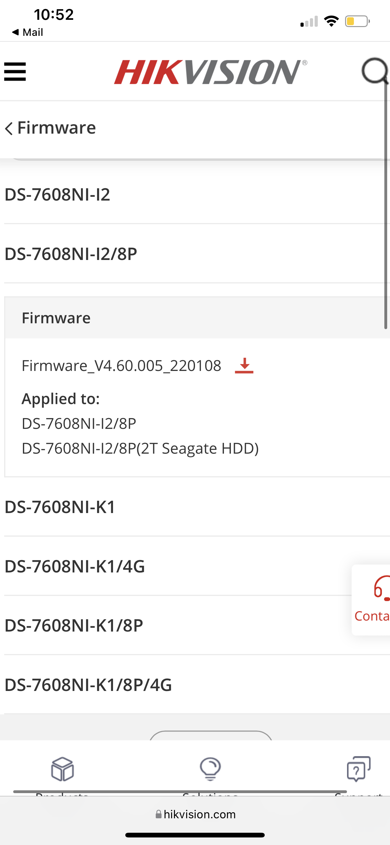

I think hikvision have released a new firmware for the 7608. I had V4.60.000 build 211129 installed but now there’s V4.60.005 build 220108
This is from there europe site I believe
