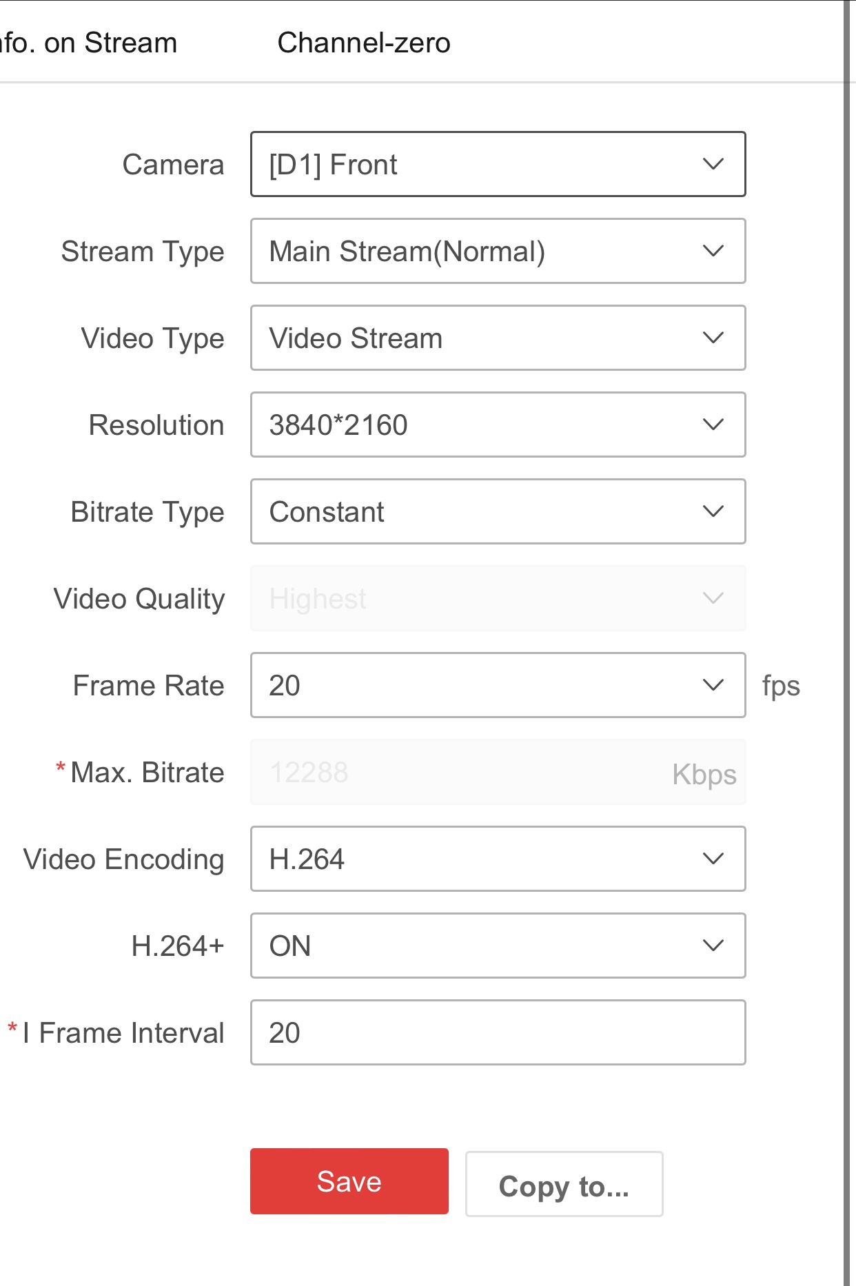

What bitrate and fps are you using?
These setting work well for me. Bummer I can’t get H265 to work on my phone without resorting to basic on the app instead of HD

Yep, same problem here as soon as I enable H265 the live view won't load, it also won't load when I increase the max bitrate to anything higher than 3702 ‍♀️
Do you have an option for H264+?. According to the storage calculator it gives the same sized files as H265. H265+ would give smaller ones which would be ideal
