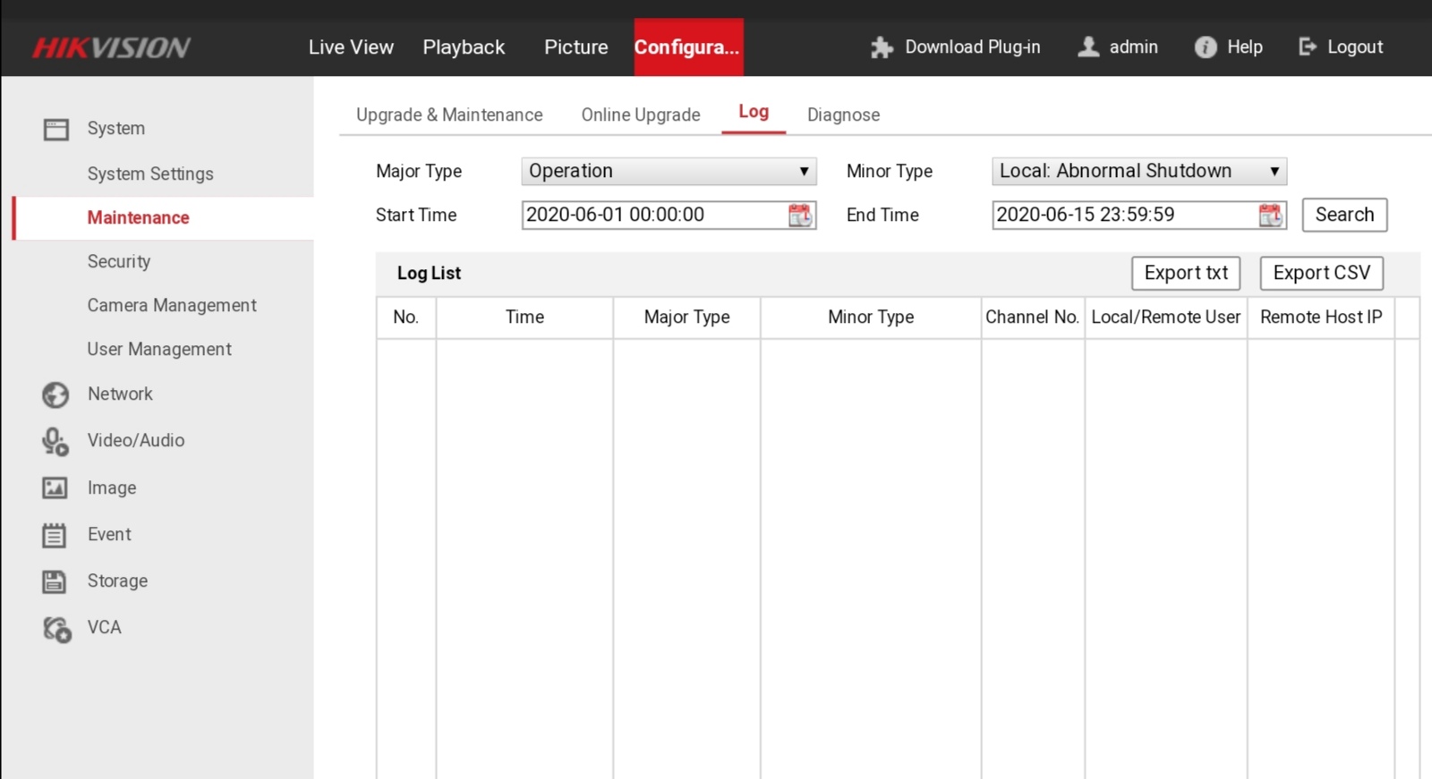

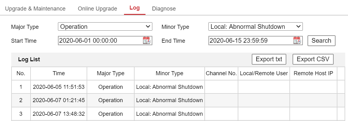

It could also be that people without event notifications are not aware that it's crashing and rebooting. You could check this by searching through you log. Below is an example of me searching for Abnormal shutdowns.
