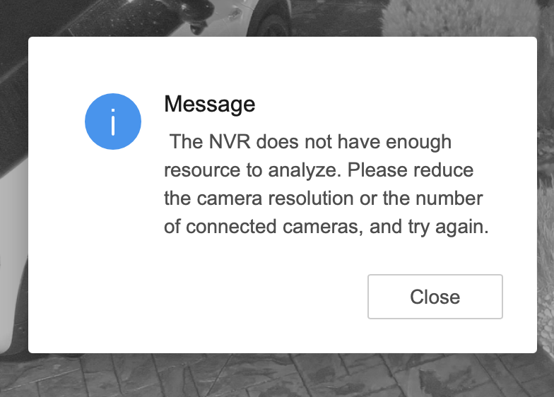

Live view in MacOS Safari is broken however:
  • Live view main stream loads ok but soon displays a message that the M series does not have enough resources. That's just for a single camera.
  • Live view transcoded stream ok
  • Live view sub stream - loads the current image and immediately freezes
  • Playback - loads the image and immediately freezes. You can drag to a new position in the timeline and that's repeated.
Then you get this in Safari:
I'm hardly going to reduce the camera resolution and can't reduce the number of connected (streaming) cameras to less than one!
