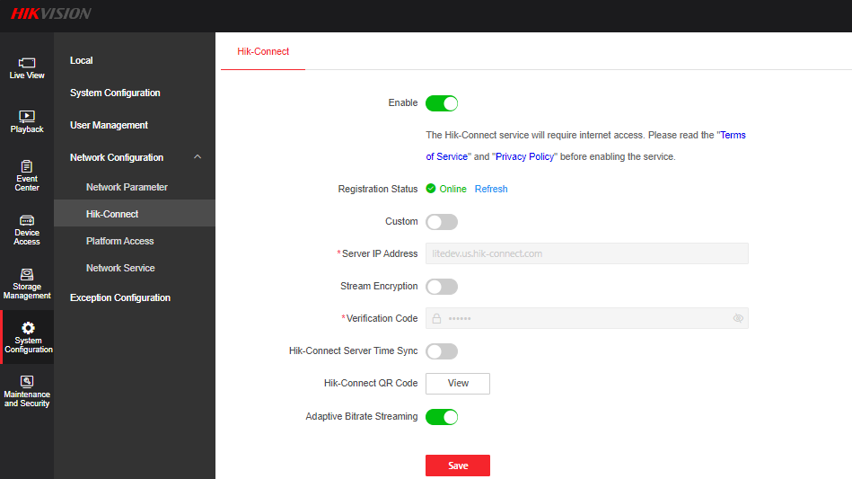

Note that the juddering playback does not only affect event clip playback in Hik-Connect. It affects playback of all footage via Hik-Connect app where the footage has been recorded after the update. Historical event clips and historical regular recordings aren't affected.
A couple of more notes on the juddering playback issue:
1. I use iVMS-4200 and playback is still ok there (I log into the NVR locally in iVMS-4200... I'm thinking someone who uses iVMS-4200 but logs into Hik-Connect will probably experience this playback juddering?)
2. I tried changing the "Adaptive Bitrate Streaming" setting, no fix there...

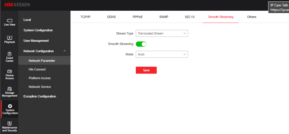

3. I tried changing the "Smooth Streaming" setting, no fix there...

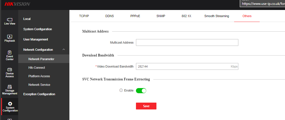

4. I noticed a new SVC setting on the NVR and tried enabling it along with setting camera's SVC setting to "AUTO", no fix there...
So, no fix found :(
So, no fix found :(
Yeah I had a click around with those settings also a few days ago to no avail. I guess we'll just have to hope for the best and await an update. Previously the update was only showing for the 7732 M4 model. As Phil posted a few days ago it had been added for the 7616 M2 model on the global site; I just checked and it's also now the linked file for the 7616 M2 on the UK site. More unhappy customers....
