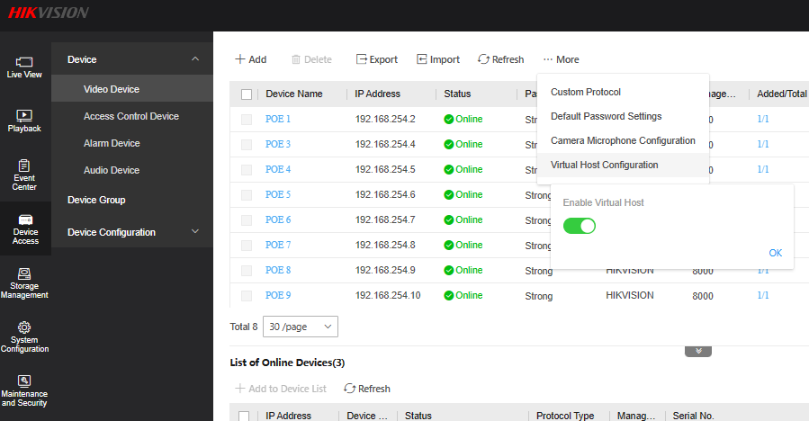

Just did "Factory Defaults" and formatted the drives... don't really think it will change anything but figure this way I know that's ruled out... had a bit of trouble finding "Enable Virtual Host"... it moved...

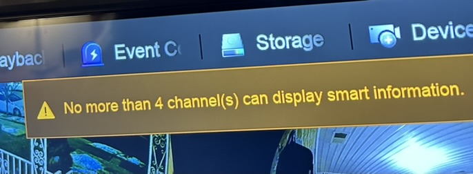

In the Live View screen on the NVR... if you select "Display VCA Info" from the pop-up menu at the bottom of the screen only the first 4 windows (I have 3 x 3 on my default view) will show VCA lines/information... if you go to another individual window say 7 and from its pop-up menu select "More/Show VCA Info" the following message appears...
I'm certain this was not the case in the 4.0 GUI... I've never used an AcuSense series NVR, but this seems like a limitation it might have? Confused...
It used to show it for all channels in the multiscreen, there was no limit. I don't use it but have confirmed I see the same on my DS-7616NI-M2/16P.

Another issue. It doesn't appear to be possible to edit a channel:
Go to Device Access > Video Device then double click a channel 'POE 1' for example. All fields are populated but greyed out. I would be unable to change from Plug and Play to Manual in order to enter an IP address manually.

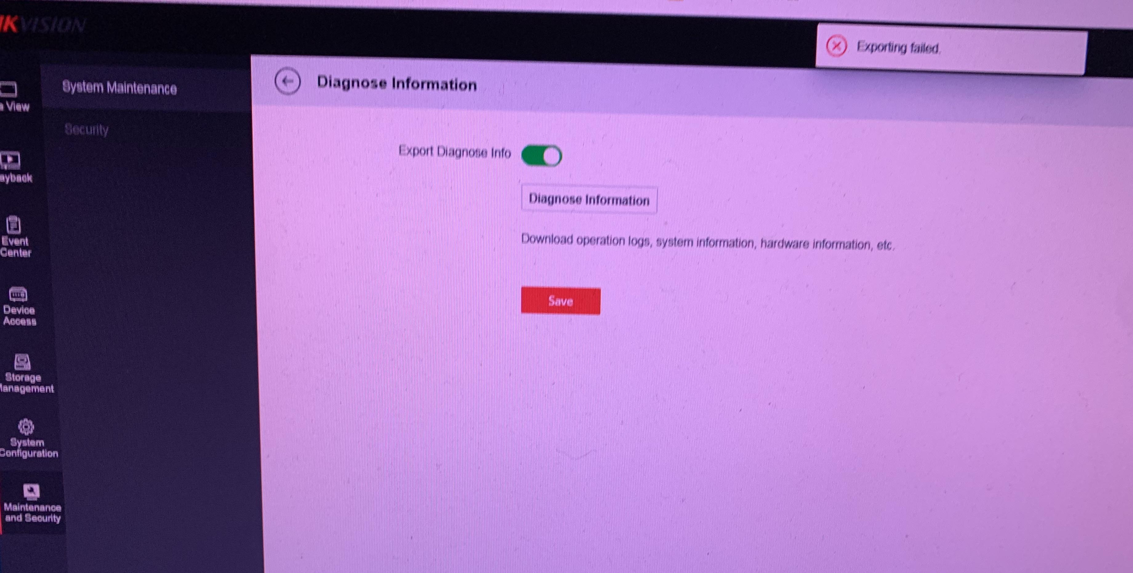

While troubleshooting a HDD #2 problem, I attempted to use the NVR's Diagnostic Facility. It didn't help. Attempts at exporting the diagnostic information failed as per the attached screen shot. I assume the facility would have downloaded / exported "something" vs failed. Anyway, just a heads up.

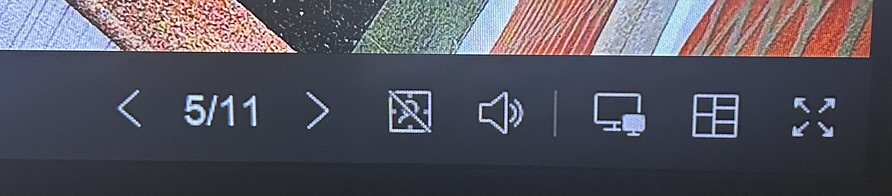

On the 4.0 GUI live view screen you could use the mouse wheel to go through the camera pages (or cycle through each individual camera if in single screen) ... this has been removed in the 5.0 GUI... now you have to use the arrows on the bottom pop-up menu to navigate through the cameras/pages...
