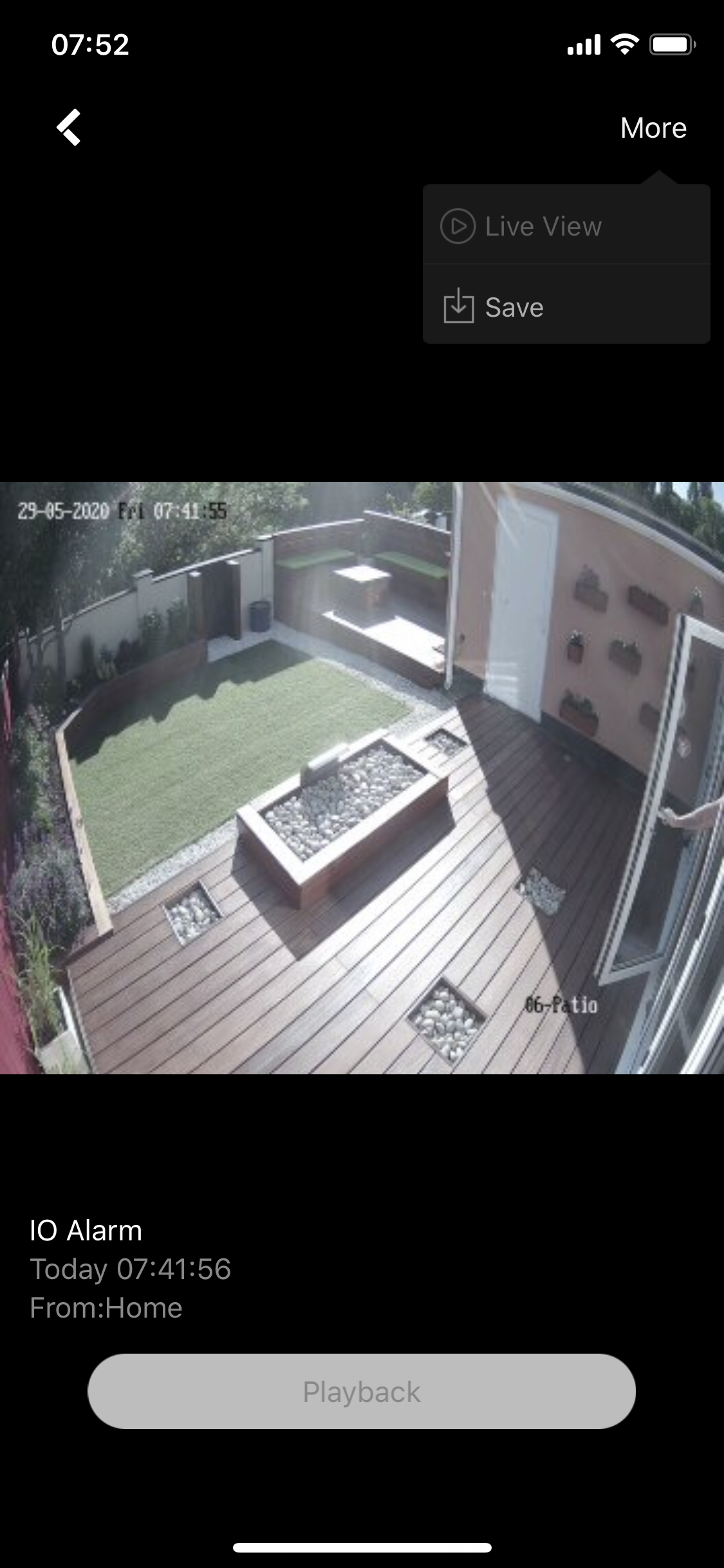

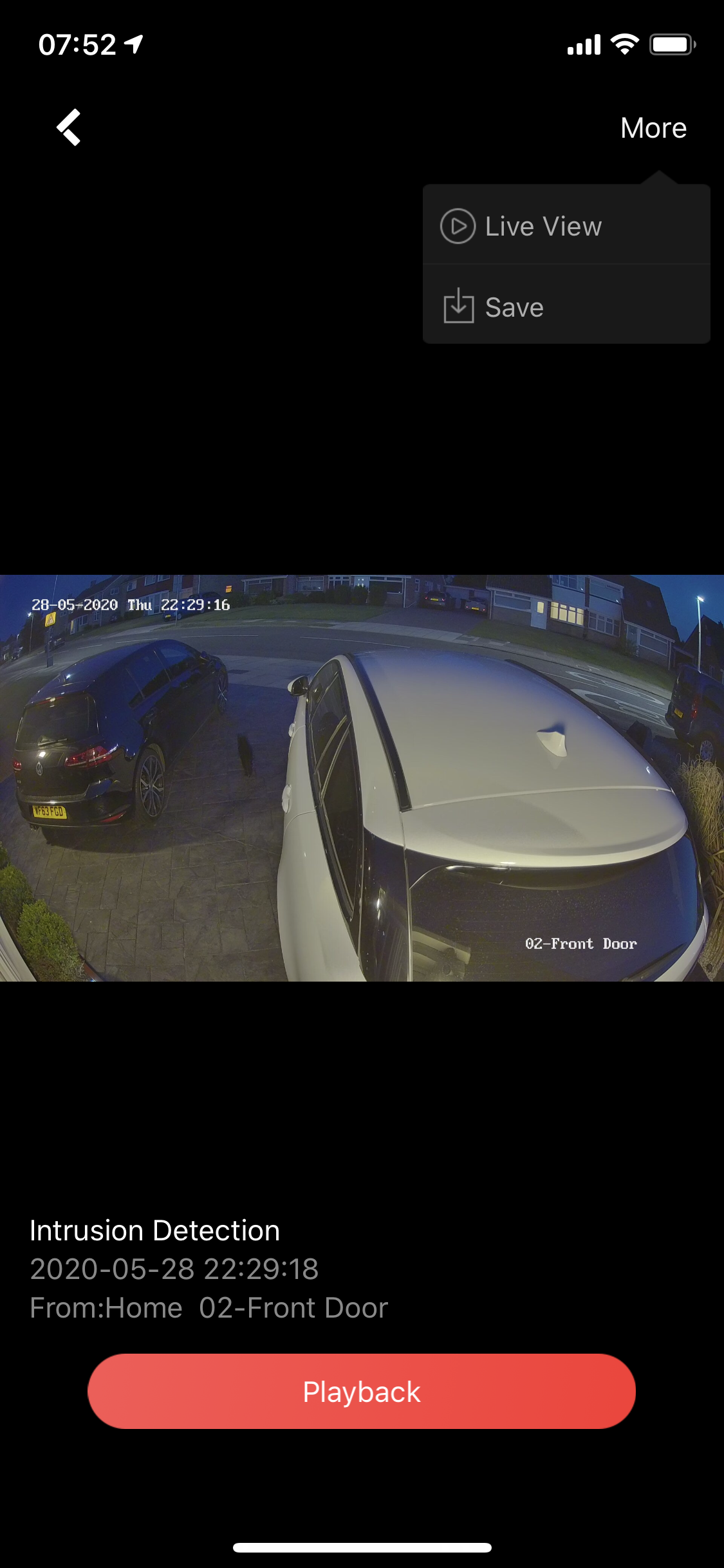

The new issue that may be this firmware or the Hik Connect app is the inability to play back or live view alarm input events from the notifications list which was always previously possible. I've attached screenshots of a smart event and an alarm input event so you can see that the link to the triggered camera has been broken. I'll put up a separate post about this at some point as it may solely be a Hik Connect issue that has nothing to do with the specific NVR firmware detailed in this thread.
All of my event notifications look like your top one, but I've never seen one that says "IO Alarm" - what is that?
They are the wired alarm inputs on the rear of the NVR. When you get sick and tired of constantly tweaking line crossing and intrusion to avoid false alerts you eventually revert to using a good old PIR wired in to provide a bit more reliability
