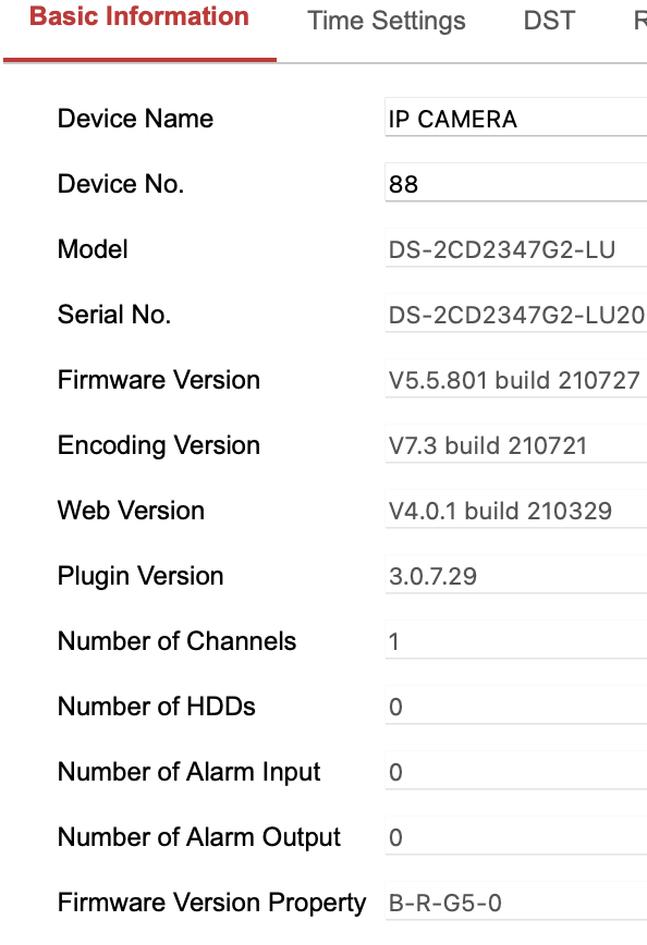

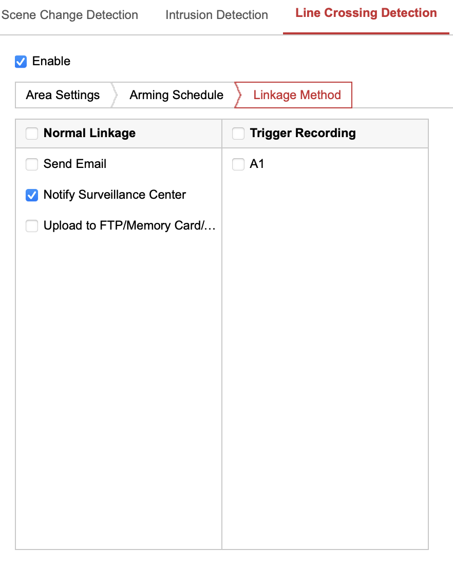

@venturis - as I mentioned in another post it's not there unless I'm missing something. Ive only seen it to date on version 5.5.114 on G5 and missing in all other versions:

I think the reason your not seeing the option is because your camera is the “-I” variant whilst you need to have the “-ISU/SL” version which has the integrated white light.

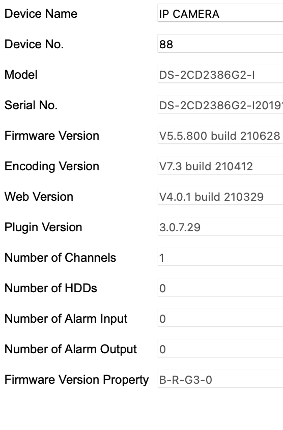

There are two portals - EU and UK. The firmware files are the same (although the UK seems to be more up to date and the EU has more of the older files if needed). The path to the relevant files is different - in the UK "Front End" leads to the Camera files and "Back End" leads to NVR and DVR files, whereas in the EU portal the files are nested beneath "Technical Materials"
To be confident which camera platform you have - G3 vs G5 (or any other). Just look in the System Settings page under Firmware Version Property at the bottom. One of mine is shown in the image and shows it as G5 platform:

Thank you so much for clearing up the UK vs EU download specifics. I know my cameras were supplied from the Netherlands so that is that.
I also checked the Camera Plattform and it is G3

I now downloaded the 5.5.160 from the EU-Portal (Link) and the update is now in progress - great! Again, thanks!! Still not got my head around if 5.5.800 should work as well but I will try after successfully upgrading to 5.5.160 first.
