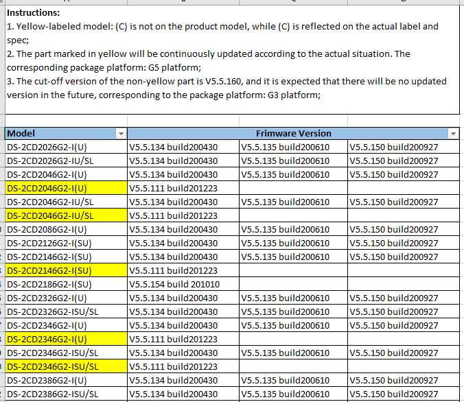

Can anyone shed light on why Hikvision have declared the G3 firmware as no long under development?
Documents on Hikvision's download portal state that there will be no further firmware updates for G3 series cams beyond v5.5.160. Specifically, the statement on line 3 which reads "the cut-off version of the non-yellow part is V5.5.160, and it is expected that there will be no updated version in future, corresponding to the package platform: G3 platform"
Hikvision even went to the trouble of releasing an update to v5.5.160 without changing the firmware revision which suggests they are sticking to that announcement.
What does this mean for all cams based on the G3 firmware, some of which are only relatively new products? Are they now end-of-life?
I've been wanting to upgrade some cameras but holding off to be sure I'm not buying end-of-life products.
We had seen this document briefly but not looked into it in detail.
We also find it very confusing so have contacted Hikvision Support and asked them to explain exactly what is happening here.
I decided to put the question to a local Hikvision reseller who forwarded the query to Hikvision.
The response was as follows;
"Currently we are evolving all G3 platform cameras to G5 platform, so the DS-2CD2386G2 model will be replaced with the DS-2CD2386G2(C)."
So in short, if you consider the end of firmware development to be end-of-life then any hardware based on the G3 platform is technically already end-of-life product, just that it may be a little while before it's replacement is announced.
This begs the question, is the G5 platform hardware a technical improvement on the G3 platform. Will the G5 platform equivalent replacements perform better or worse than the G3 platform hardware they replace?

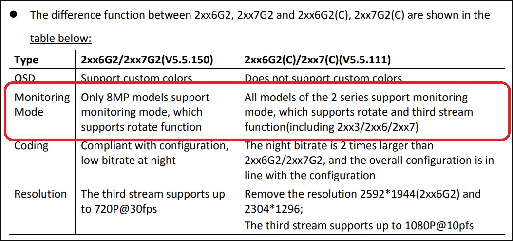

One small piece of information from Hikvision that comparing the functionality and performance of G3 vs G5 cams is shown in the table below.
I can't remember where i found this information. I think it was in one of the firmware release notes.
On paper it looks like the G5 performs better than the equivalent G3. I'm not entirely sure what is meant by "The night bitrate is 2 times larger......"?
We know that Hivksion have already started to release G5 replacement cams. The 2CD2347G2 is available in both the G3 and G5 variants. If someone had access to a pair of 2CD2347G2's, one on each platform, it would make an interesting post if they were directly compared.
Really - I think they explained it very clearly "the overall configuration is in line with the configuration" :confused::D

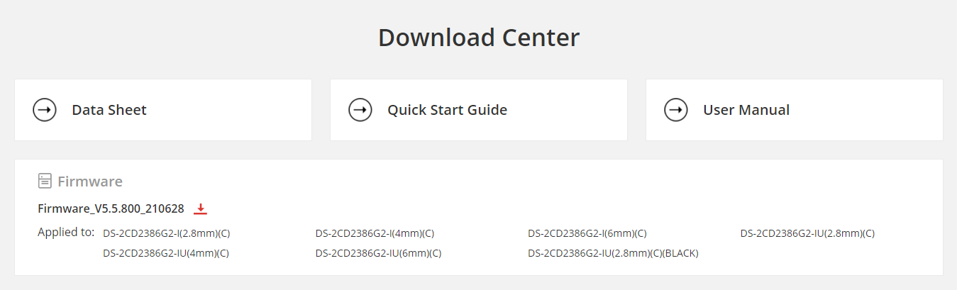

Hikvision has just released a new firmware V5.5.800 dated 28 June 2021 for the 2cd2386G2(C) and other variants based on the G5 platform only.
The new firmware release jumps toV5.5.800 which I assume was done to prevent confusion between the G3 and G5 firmware releases since the G5 platform releases had a lessor numeric designator.
You cannot apply this firmware to the G3 platform cameras since we now know there are significant hardware changes between the G3 and G5 platforms.
Thanks @venturis
We were aware of this firmware listed on the Hikvision website, but strangely this firmware is not available on the download portal and it is rare that new firmware appears on the main website before the portal.
I have asked Hikvision support for release notes and more information about this latest version, I think you are probably right that they have made this big jump in versions just to try and avoid the version numbers of the G3 & G5 firmware getting mixed up.
I have used Hikvision cam's for many years. A few weeks ago I bought the 2386 non-C version. They worked great, everyting was fast and easy, no problems. But then I realized that these was no going to be updated anymore, I returned them to the shop and bought several of the 2386 (C) versions. These cam's are terrible! Or to be more precise: he firmware is buggy and lots of functions that are available on the non-C version are NOT present on the C version yet! I am talking here about resent firmware versions for both versions.
Just as an example: when the 2386 (C) is running as smart-event unit (this is the default setting) it only provides 2 streams. Third stream is missing. Only if the unit is set to monitoring mode, the third stream appears and can here also tun up to 1080p. BUT the "old" 2386 non-C version have all three streams available as standard in the smart-event mode.
And worse: The 2386 (C) can't record to SD card. I just can't get it to work. The non-C version was set up in a few minutes, and everything was working including motion detection and recording. But the (C) camera just can't.... I don't understand it.
I think Hikvision developer team are pretty busy these days porting all the functions to the G5 platform for the C versions of these cameras, and therefor lots of functions are still missing, lots of bugs are found, and the camera don't run as smooth as the non-C version. The firmware for the new C-version is also 10MB smaller than for the non-C version!
Tomorrow I will try to downgrade the firmware to see if I can get the recordings to work.
Please post your experience with the 2386 (C) and the 5.5.800 firmware.
