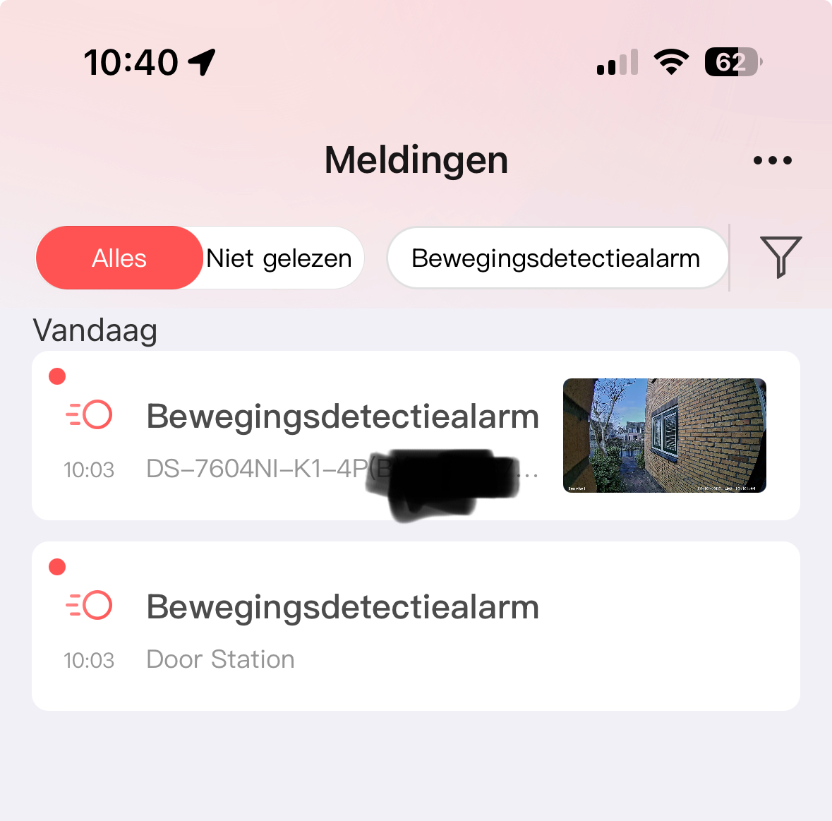

I have the doorbell connected to nvr as well. So doorbell notifies with single photo and nvr with the corresponding video.

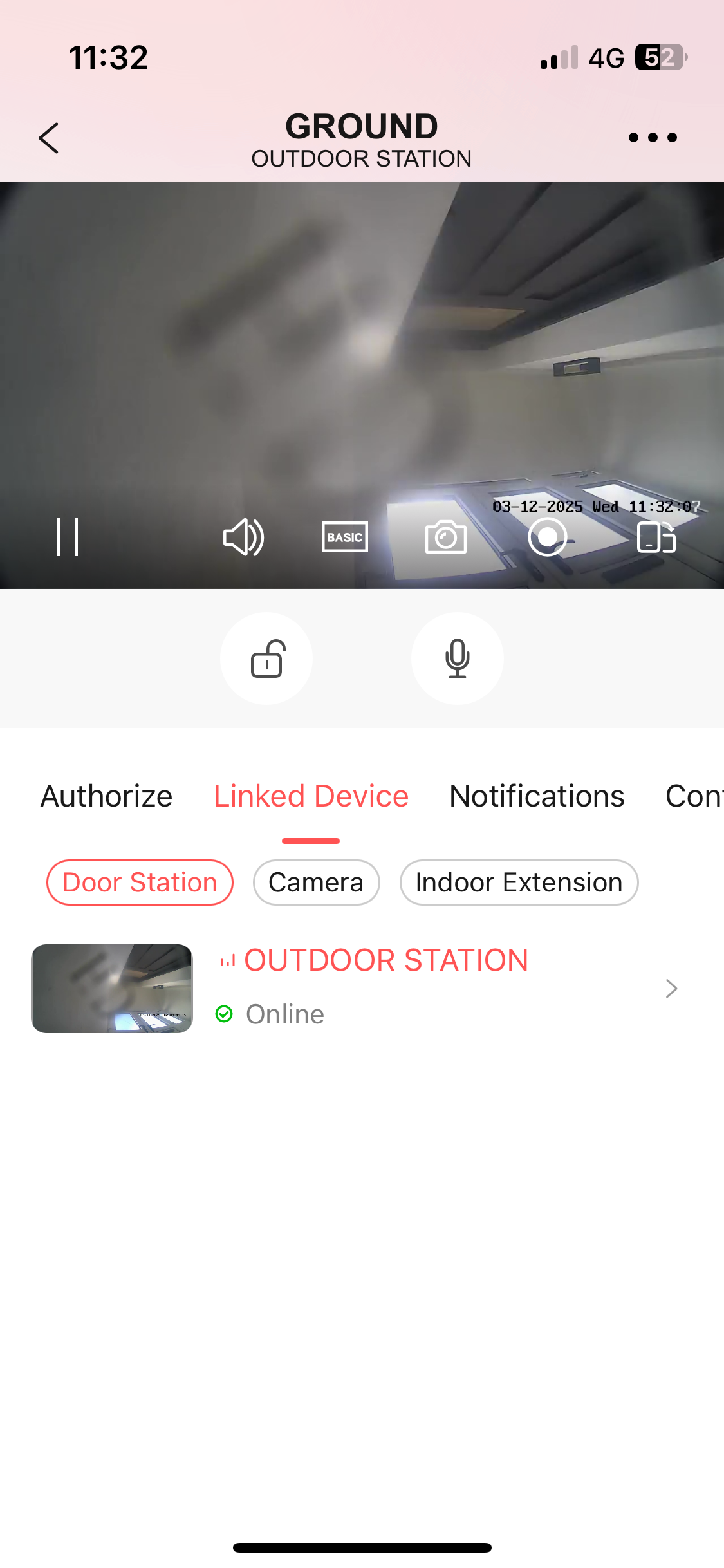

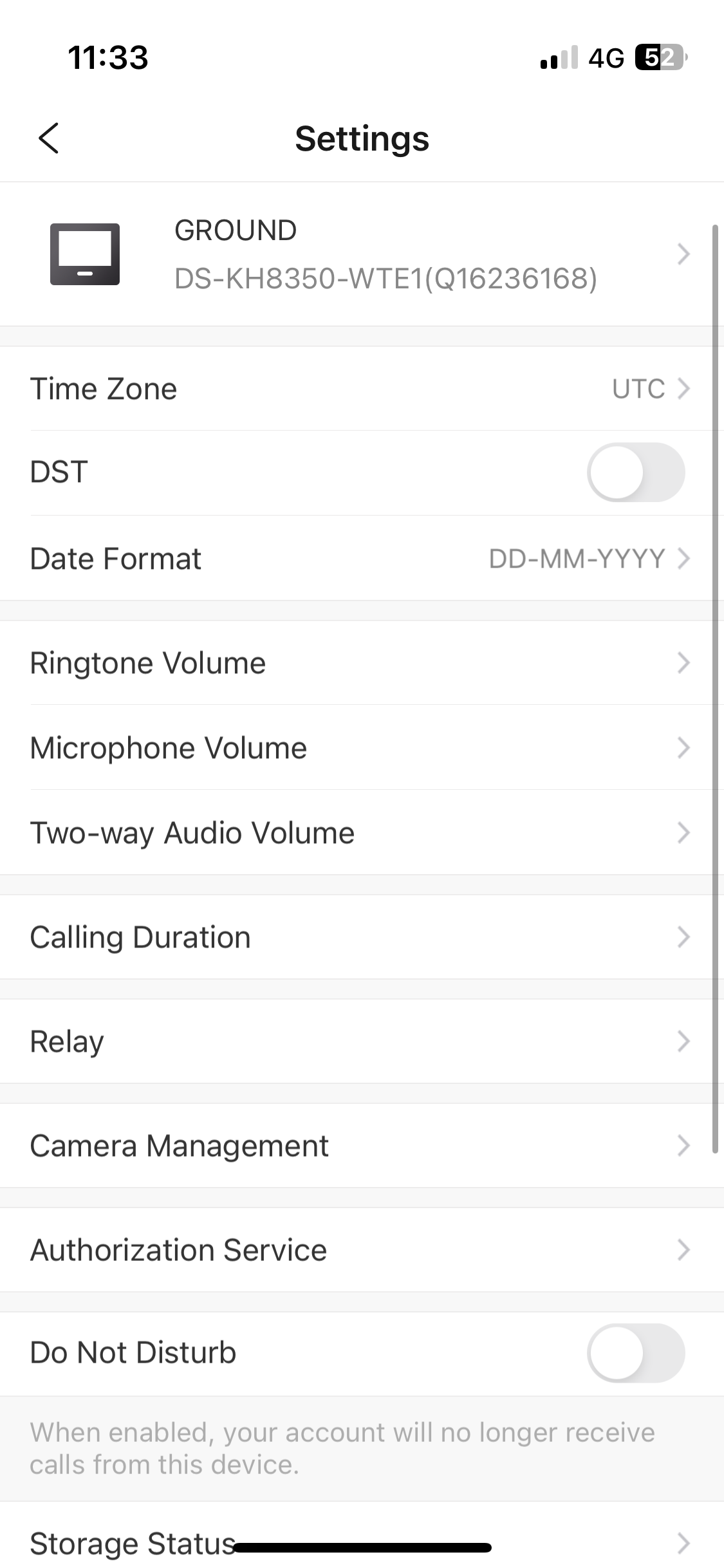

It does have enable and notifications set under Me -> Settings -> Noticiations, as for device settings on the app, there is no option you mentioned under the outdoor station (see attached) ,although was there if and when I add the doorbell into the app - When door bell is pressed, I do get a pop up notification (The first image i sent), but without a still single photo.

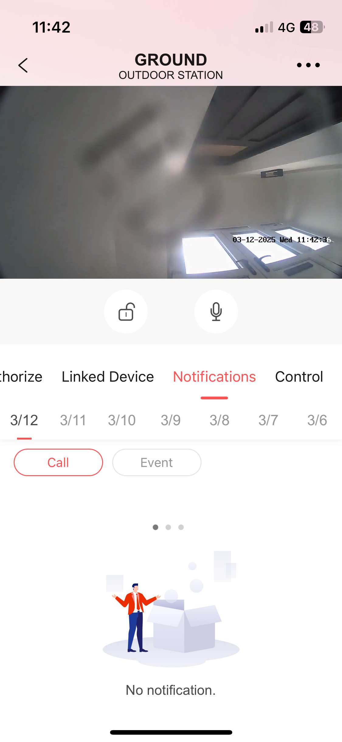

Also interesting, I made a call, answered, then under the notification tab, it doesnt show anything under call or event, the 3 dots keep cycling around and around, see attached

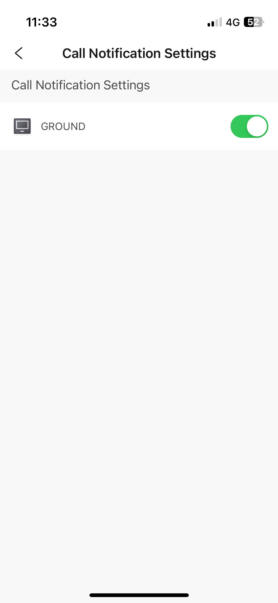

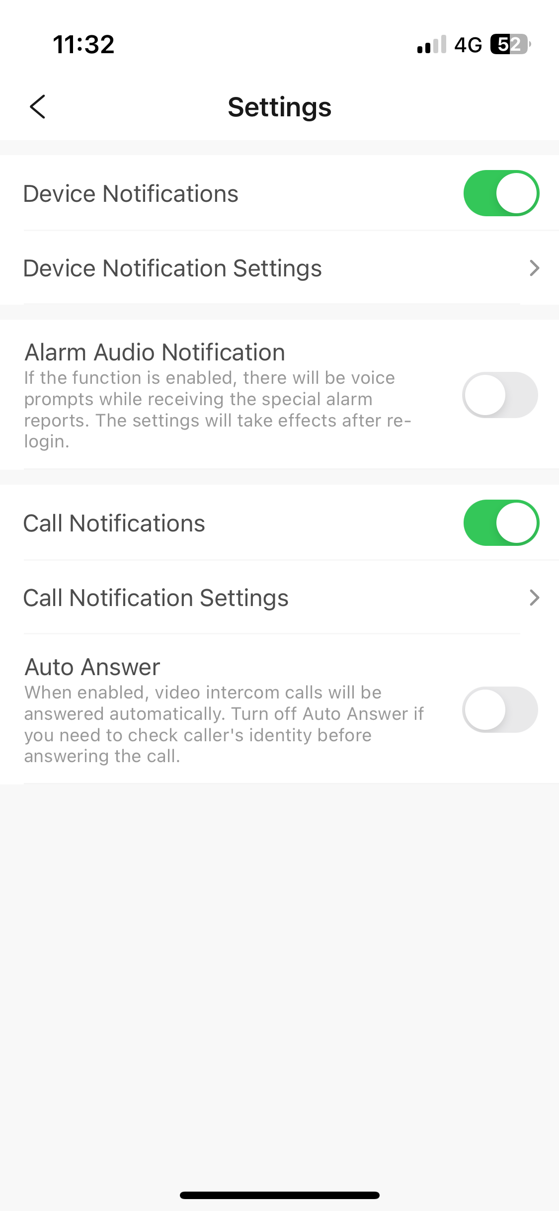

I think that only applies to motion notifications. My 6113 has Notification set to 'Disable' and Report Events is turned off and yet I still receive calls directly to Hik-Connect. To receive calls and call notifications including the snapshot, all you need to have is 'Call Notifications' set to on and 'Call Notification Settings' > Doorbell turned on in Me > Settings
