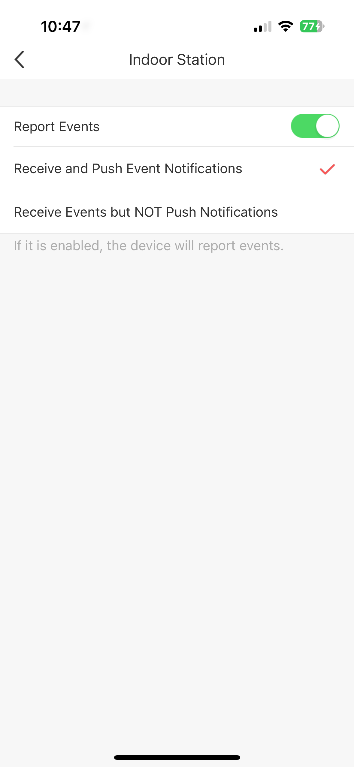

1: i cannot get motion notifications on my monitor or even my hikconnect phone

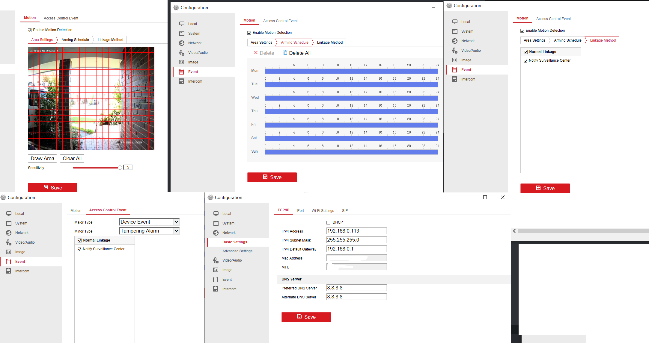

On doorbell settings in IVMS
I have selected the whole grid in red square boxes,
schedule for 24/7
linkage enabled to normal linkage and notify surveillance center
access control - device event: major, tampering alarm: minor
sensitivity on 5 (just for testing)

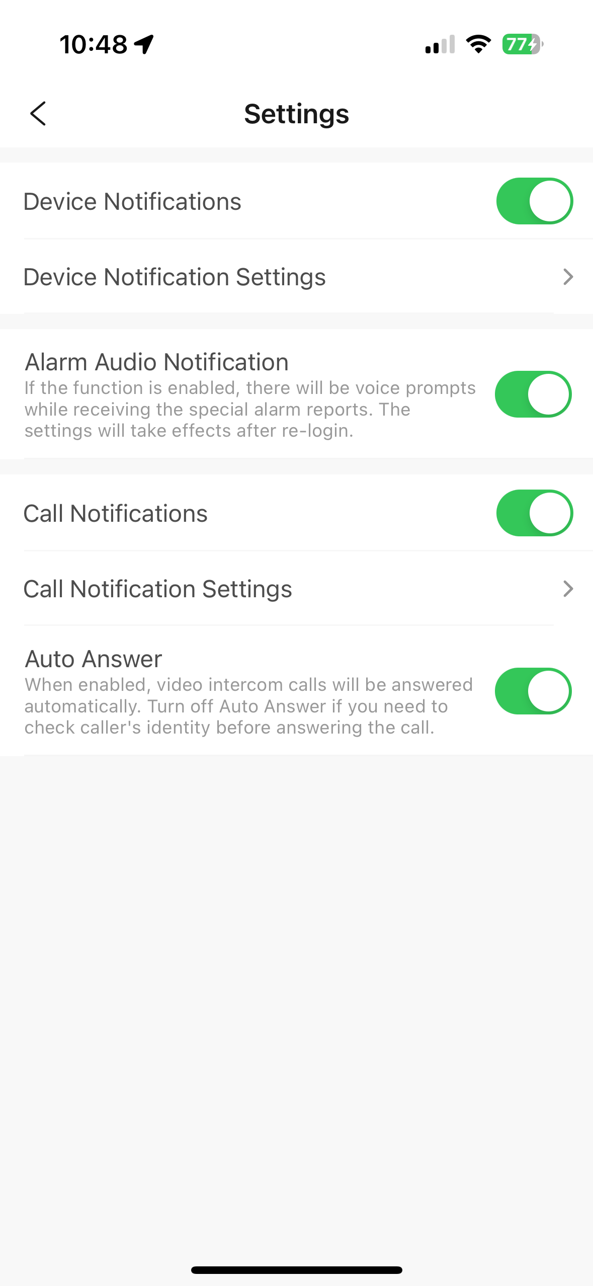

Hikconnect has been set up with notifications enabled for the doorbell

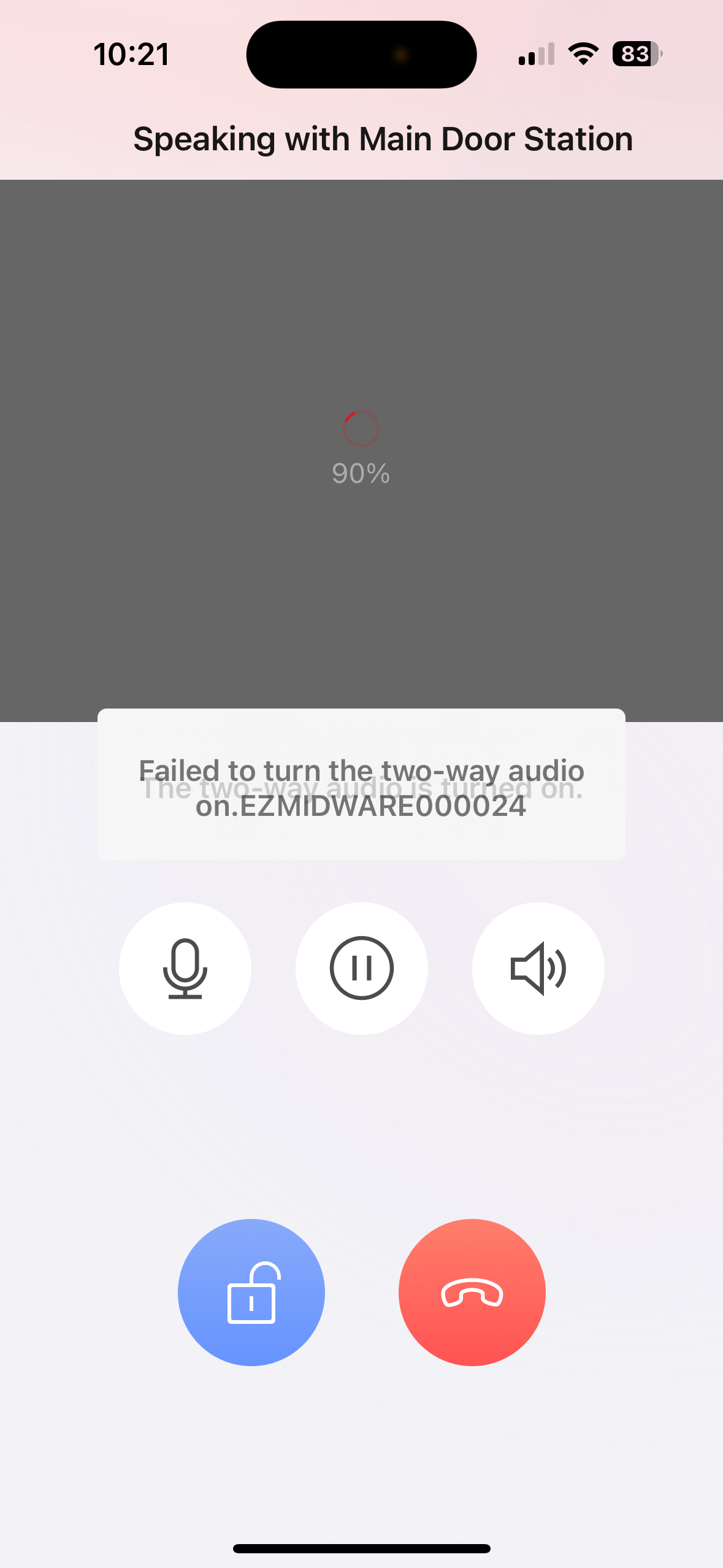

2: when i press the doorbell, and answer via my phone the two way audio fails.

On hik connect, i have added the monitor but not the doorbell.. im not sure if that is correct?
My doorbell is not setup as wifi (it has poe via lan) Same as my monitor

Does DNS settings have a play in this
