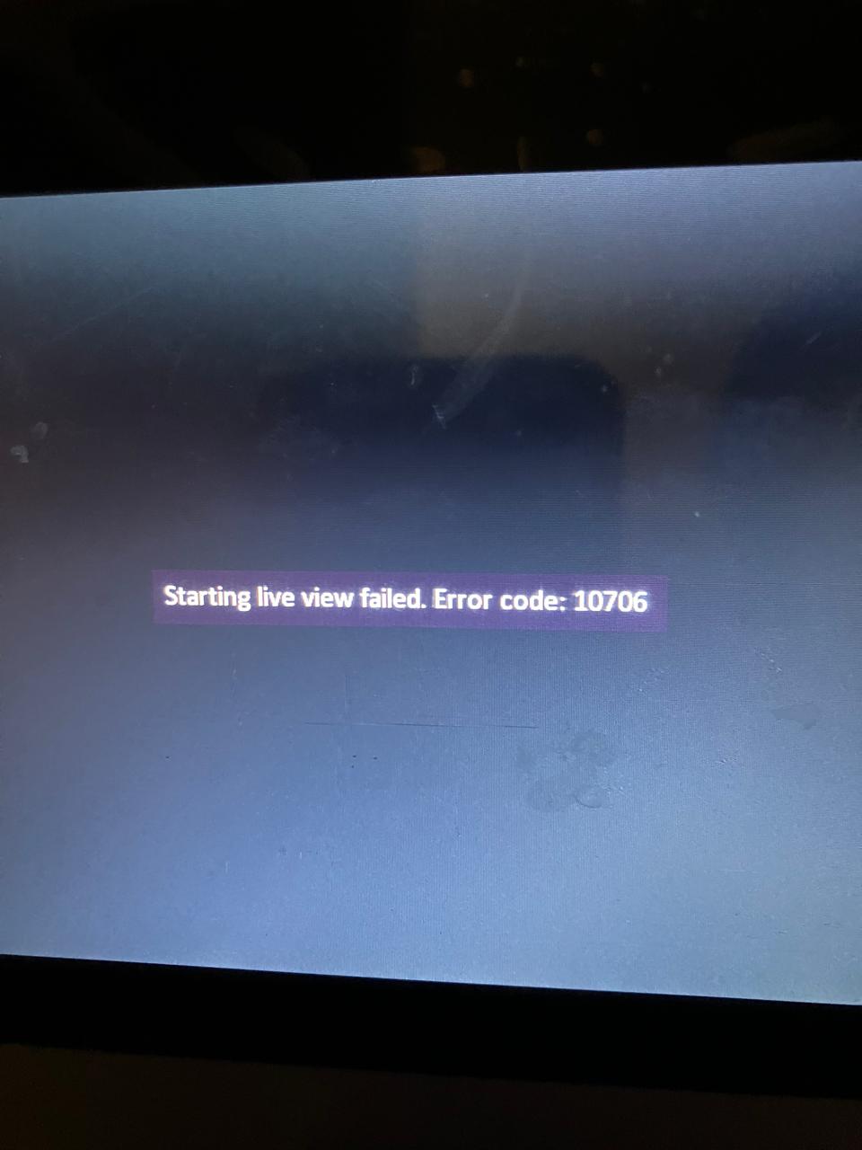

I then added a third camera DS-2CV2026G0-IDW but this one I am unable to get it to view.
I get error: "Starting live view failed. Error code: 10706"
Any advice?
I am sure I did everything the same on all 3 cams.

Are you just seeing the error message with the 3rd camera? Can you still see the live images from the first 2 cameras?
The DS-KH6320-WTE1 is on the latest as I have it (V2.2.24_240115) The wifi cams are all 3 on the latest as I have it (V5.5.820_231120)
I can see the first 2 cams. Error message is just on third camera

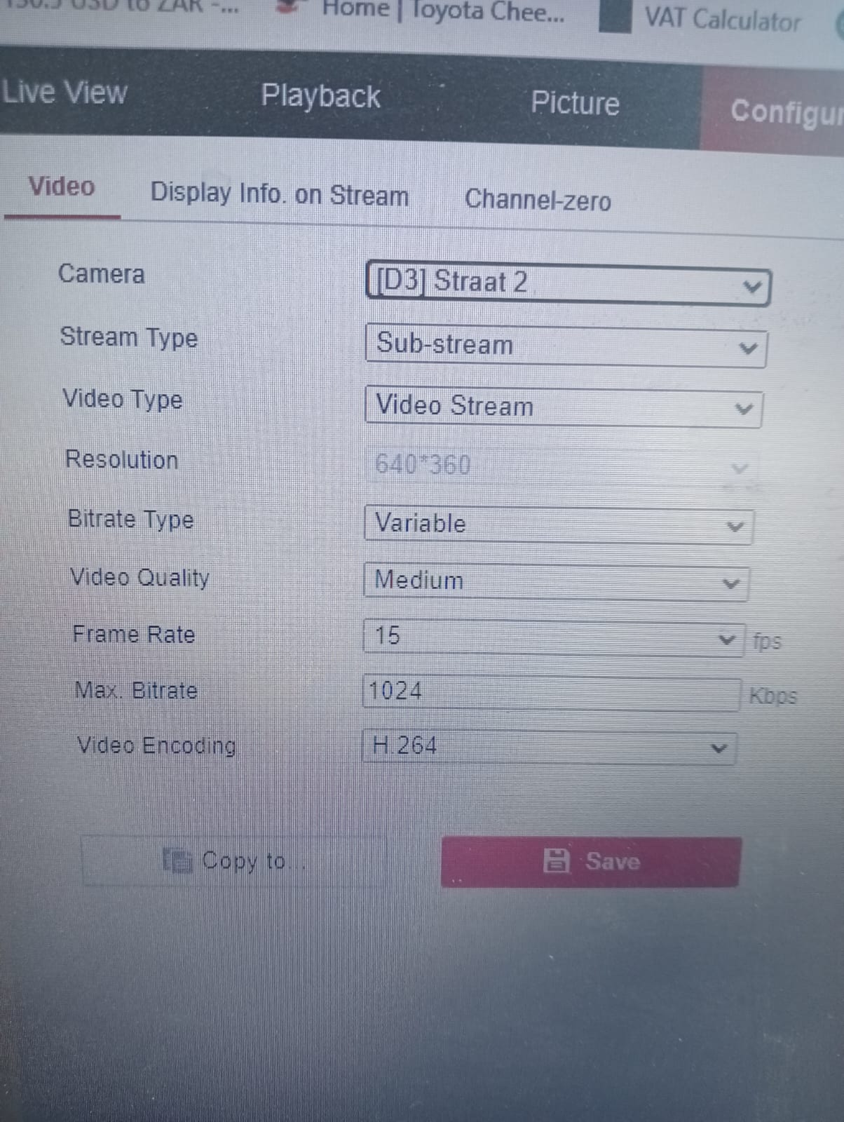

I should maybe add that I connected the 3 cams to the indoor station and they are also connected to a DVR. (iDS-7216HQHI-M2/s) Viewing on DVR is fine for all 3 cams
Check the sub stream settings on the DVR for the camera that isn't working. It has to be H264 as that's all the indoor station supports; if it's H265 it won't work.
Main and Sub stream is on H264
