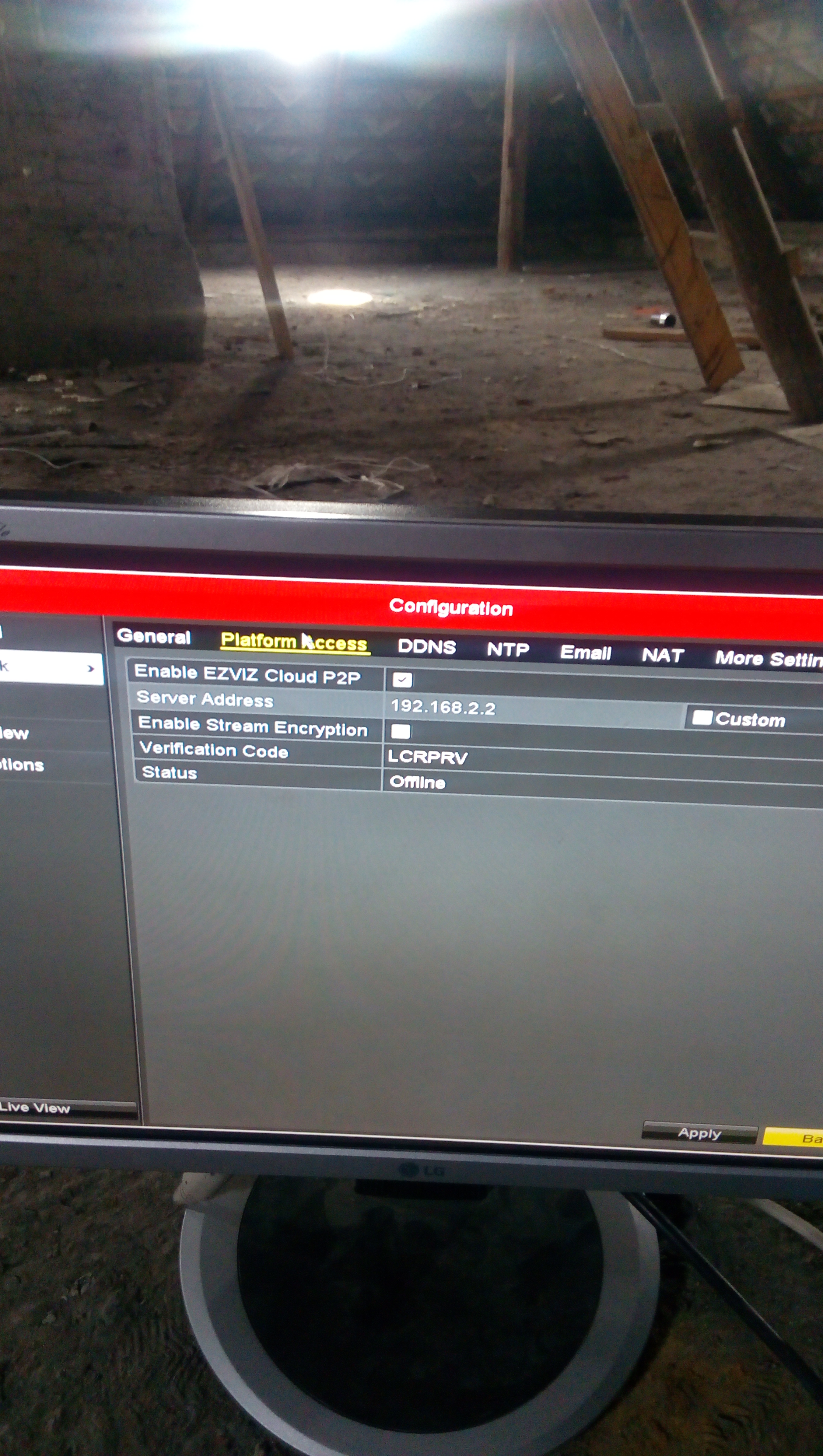

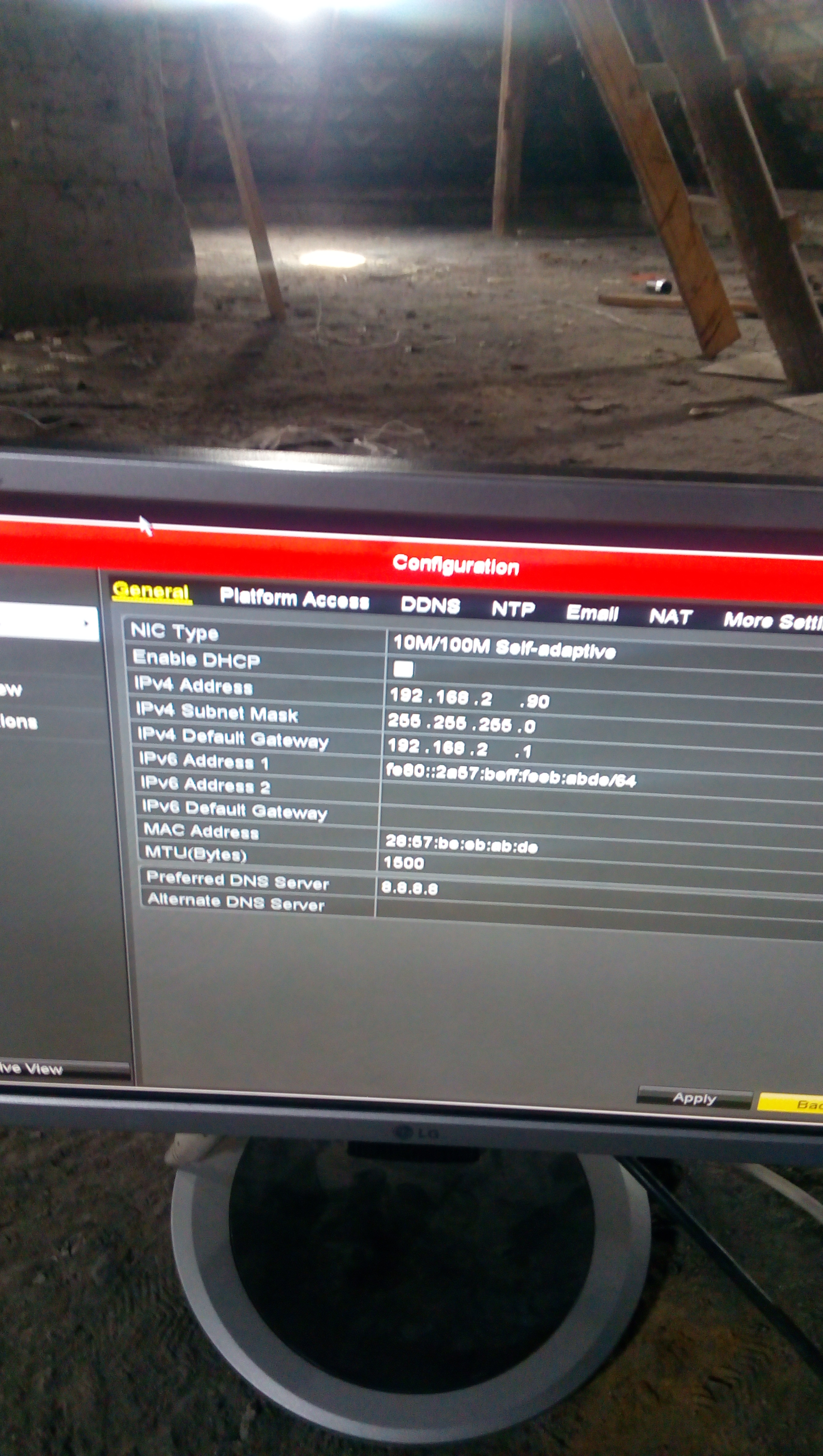

Hi. Why my connection is offline, what is wrong?
Your EZVIZ Server Address setting is incorrect. It shouldn't be a LAN IP.
Don't enter a custom value and instead leave it default.
If you're in Europe, that should be dev.eu.hik-connect.com
Also double-check that your IPv4 Default Gateway is correctly set as your router's LAN IP
