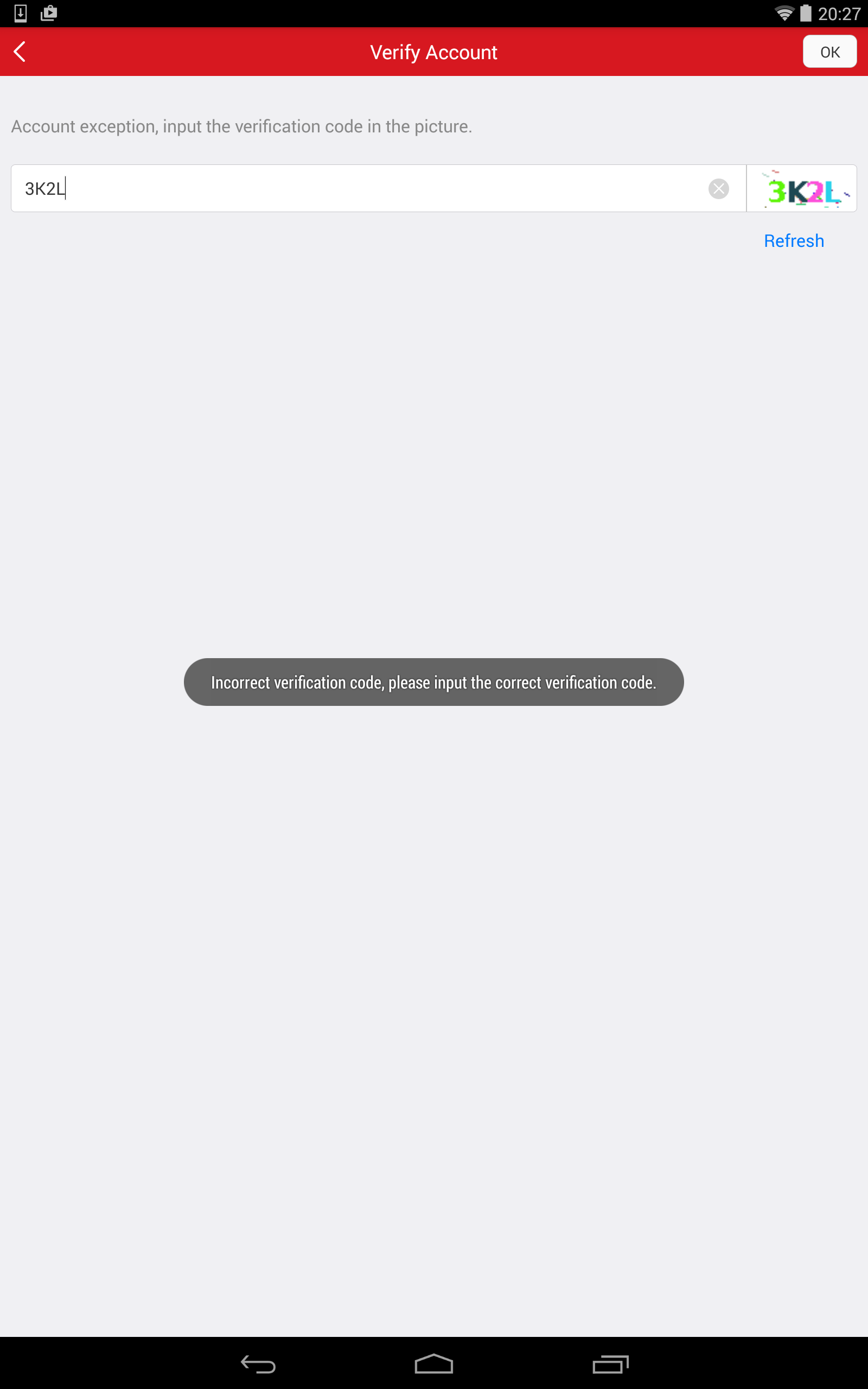

I've been using either app for long time no issues but yesterday on 2 android devices I'm now asked to enter an account verification code ( 4 figure code ) and it will not accept. You can refresh the picture to get a new code but keeps saying incorrect , I've tried upper and lower case to no avail ! ?????
Did you try to remove the two devices
Did you try to login on ezvizlife.com in Explorer and try it there? And just to be sure: you aren't mixing up verfication code of the camera with the code voor the EVIZ account itself? (Because via the app you can only type the first one....)
No I didnt try to remove them I hadn't made any changes . strangely trying 10-12 attempts at the 4 figure verification it finely accepted but again today after 6 hours of working its gone back to enter verification.!
Screen grab below and I'm accessing a NVR not camera directly
