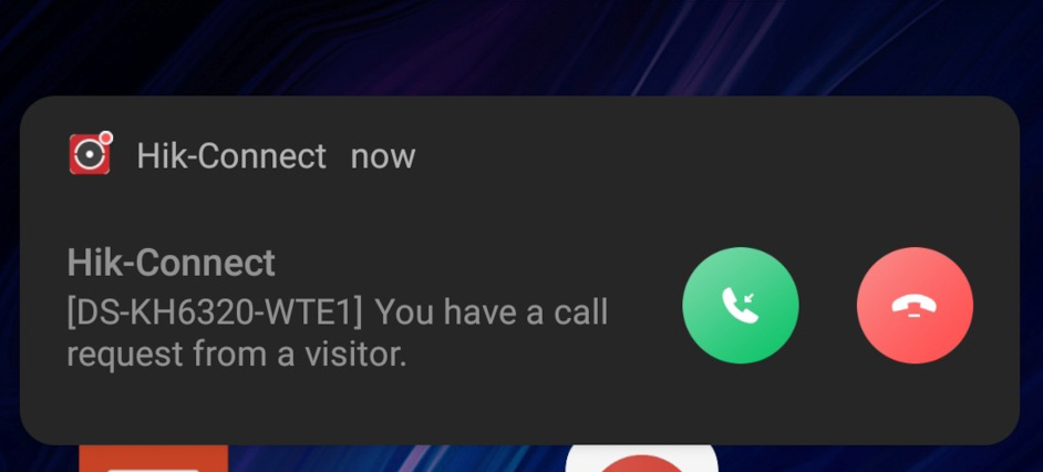

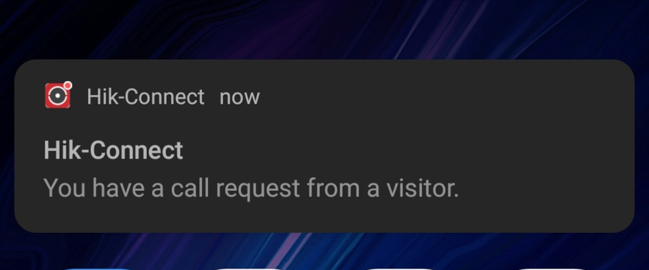

its clear now that they mess around with the notification system of the call system... see the notification banner style 4.14.1 vs 4.16.0
4.14.1
4.16.0

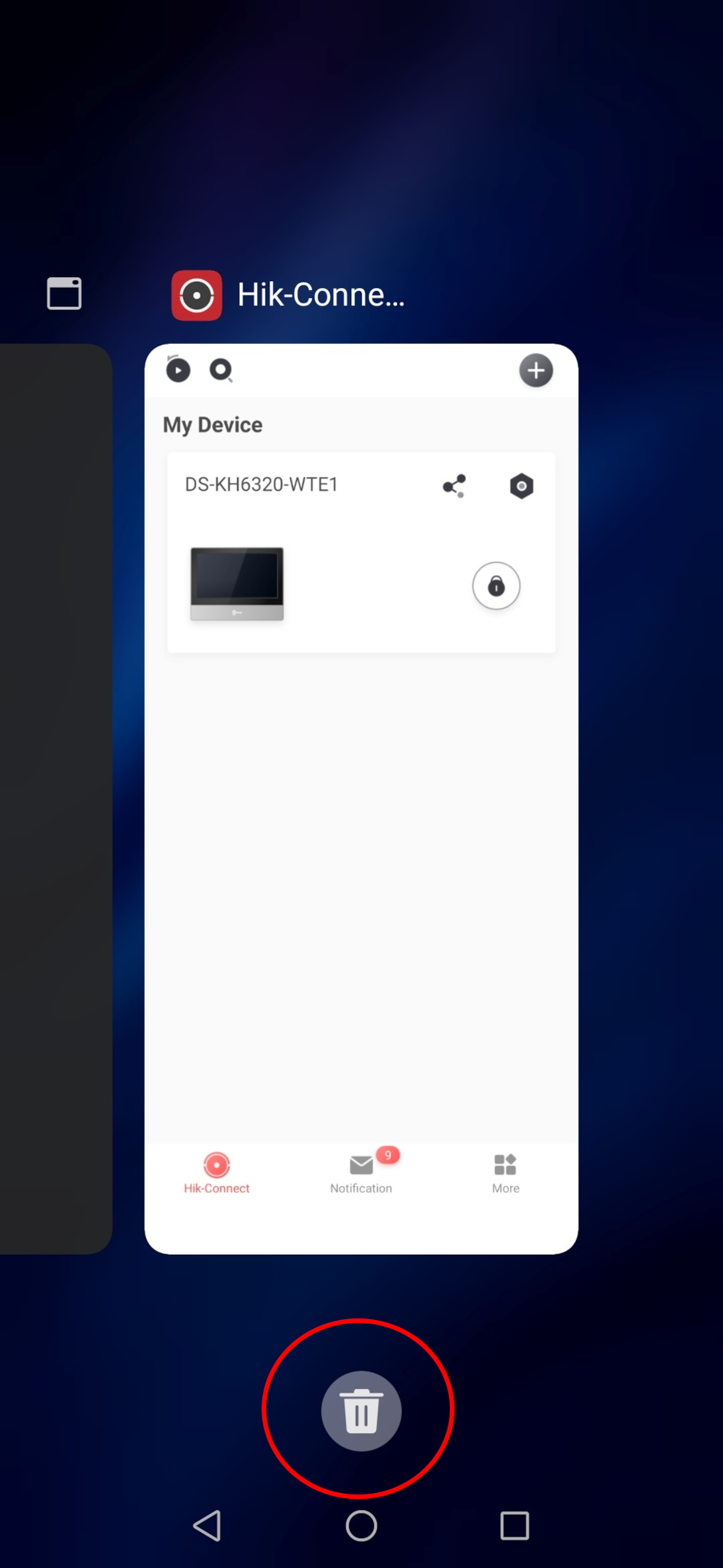

i found an easy way how to test if notification works or not... just close the backround apps ! on version 4.14.1 you still get push notifications if there are no background apps, on version 4.15.1 and 4.16.0 you will never receive a call until you open hik connect again manual (and run it in background). this is not normal. any app should send notifications even if you stop them.... and its working like that on 4.14.1. this is what i love about hikvision. they always mess around, do not test anything and send out updates. best way is not to update if you need your system.

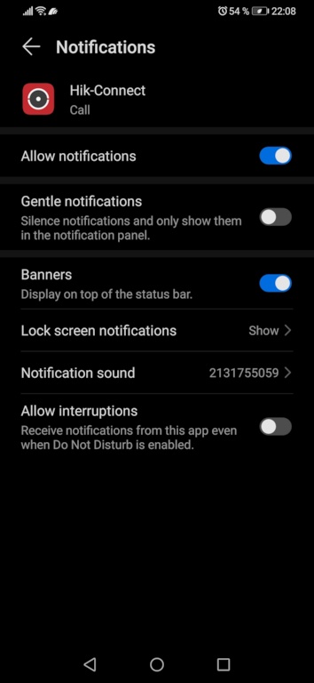

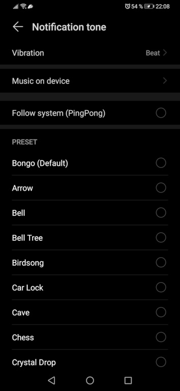

Hey, how do you change that ringtone anyway?
You said:
- change ringtone in system settings (its "2131755059" which is not related to anything on the storage)
For me , i always have the same hikvision ringtone

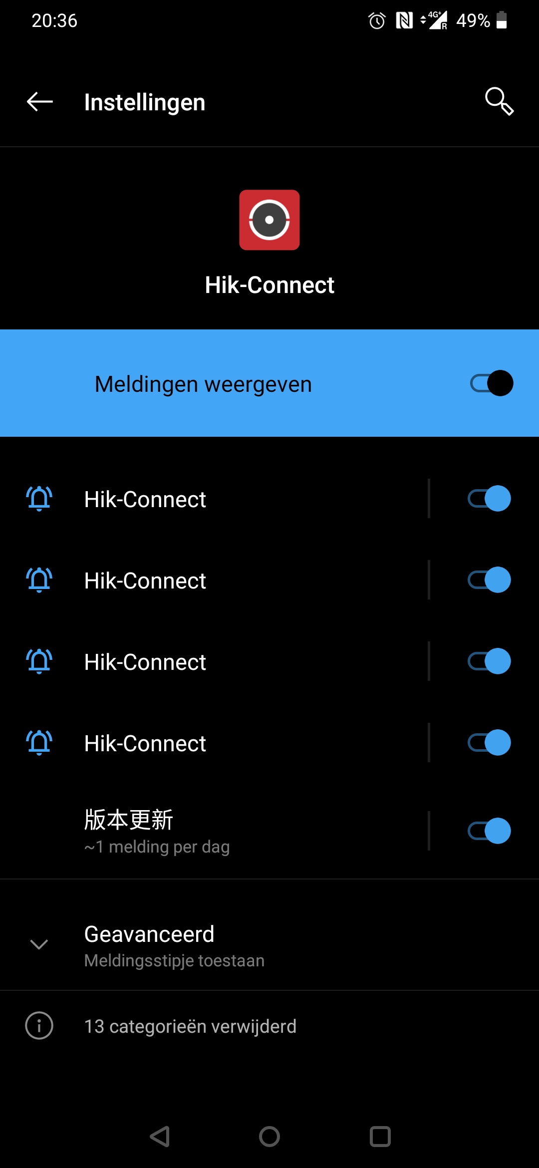

If i look in your screenshot , you can setup different kind of notifications for each category... For me they all look the same, i don't have ringtone there and banner settings
Using OnePlus 6t phone here
Have a look at my screenshot, it's in dutch, but that doesn't mather
Upvote 0

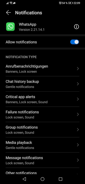

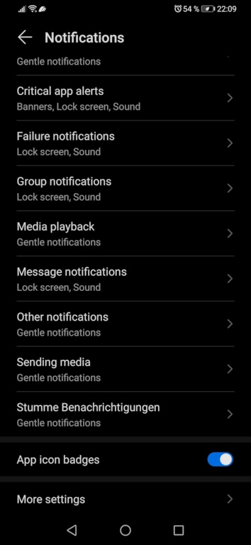

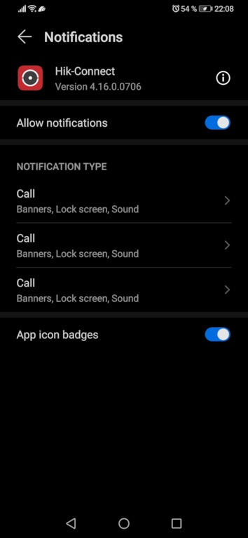

on huawei phone you can change notification behaviour for all apps different. so you can set tone, vibrate (on/off/scheme), if you want banner , lockscreen .... and you can do it for each different type ... there could be many ... see screens and the example of whatsapp (which have MANY types of different notifications).
its also possible on any ios device..
if you are able to root your phone, you may find "2131755059". i dont have access to it, because root not possible on huawei phone since 2020.. i tried via adb shell, but no luck because many folders has permission denied ;)
but hikconnect is really bad developed. it always override the settings with a new notification type (thats why you have so many ,,, i only see 3) .. i think you mention it somewhere here earlier.

Ah ok, it's phone specific, didn't know that.
Yeah, i started a thread about this earlier, indeed , it creates a new notification each time...
Anyway, back to the issue, i also contacted our supplier with this issue on 4.15 and 4.16, they have close contact to r&d, let's hope they don't get default answers from hikvision
