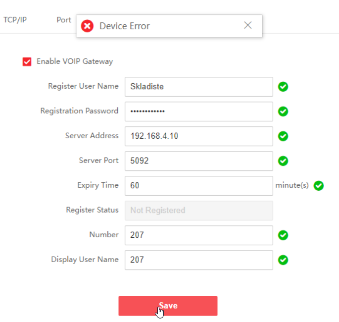

Hi all,
having problems with KD8003-IME1 fw v2.2.52.
I enter all right config into VOIP gateway but always get "Device error".
Same config worked in fw 2.0.8.
I'm using FreePBX.
Any advise. I did factory default few times, can't downgrade to older version.
latest version from beginning, 3.7.0.5.
I could downgrade but don't see the point in that
nope, not possible to downgrade anymore once above 2.2.50

I did all of that multiple times, i even installed several versions of IVMS but all the time same thing.
I get success call only on 2.0.8 version but if I answer from my phone intercom doesn't seems to figure out and keeps calling.
