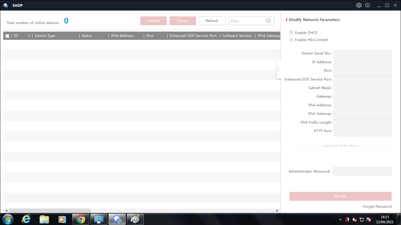

However, having downloaded the SADP tool (and being connected to the local network) I cannot see any devices at all (including the working ones)
I have tried multiple different laptops which run different operating software. I have tried turning off the antivirus software and have also uninstalled and reinstalled it several times, but to no avail…. Any suggestions? I suspect I’m doing something wrong (clearly) but can’t figure out what!

Hi @Chip
The PC/Laptop you are running SADP on, is that hard-wired to the local network (e.g. plugged into the router or a switch on the network) or are you connected via WiFi?
Yes, an Ethernet-connected device is best for scanning with SADP because when connected with WiFi the laptop is not exactly on the same IP range as the hard-wired cameras.
I've tried connecting to the router / network via ethernet and I'm still getting a blank SADP....
As that’s still not working for me, Dan, is there anything else I can / should try?

I come bearing good news!! I’ve spent the last 4 hours trying and retrying to get this sorted. I’m still not entirely sure how I did it (I managed to find the cameras and the inactive one after connecting my laptop directly into a random port on the remote PoE switch, rather than the router) but after a lot of shouting and swearing all cameras are now working.
