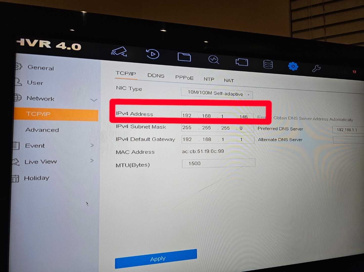

Go into the menu of the NVR into Network Settings. If you select DHCP and click Save/Apply it should populate the IP address and Gateway from your router automatically. If DHCP is already on - turn it off, enter a random IP address in the box 10.10.10.10 and save it, then turn DHCP back on and save it. If it doesn't repopulate the IP address it would seem there's no connection to the router.

I tried entering the random IP address as suggested , but wasn't sure which IP address box to use as there were a few so just entered it in the first one as per screenshot. The dchp box was ticked already so I unticked it and followed your instructions.
It DID repopulate the IP address as per screenshot
What does that mean?

That means it’s connected to your router, as it has assigned the NVR an IP address.

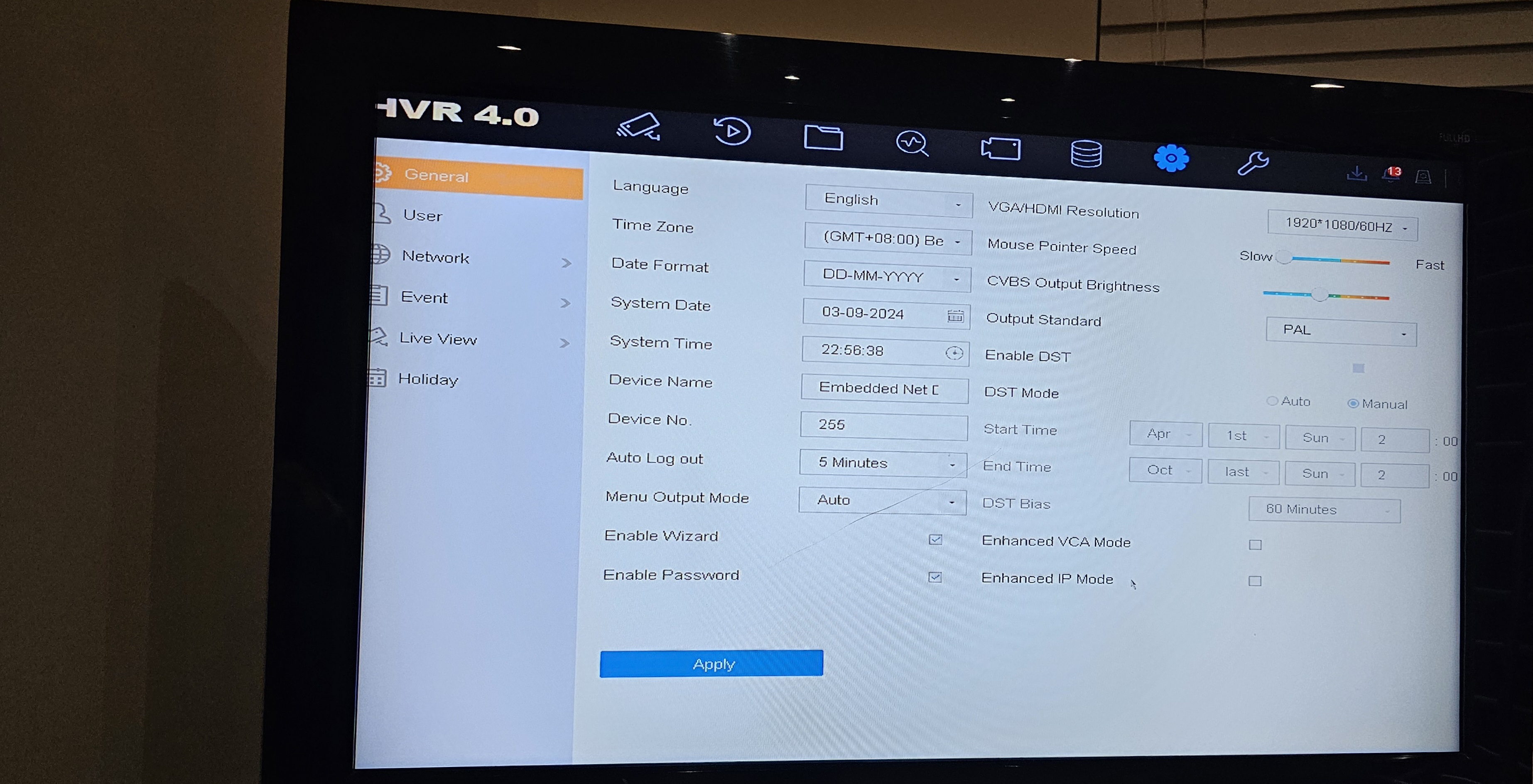

You only showed the ‘easy’ menu, switch to ‘expert’ and set the DNS server 1 address to 8.8.8.8 and the second DNS address to 192.168.1.1. Then go into ‘Platform Access’ and make sure Hik-Connect is enabled. It should show ‘online’ on that page once enabled (you might need to click out of the page and back in to see it refresh it’s status) If you’ve previously added this NVR to your account the ‘Bind Status’ should show that. If it’s ‘online’ but unbound you’ll need to add it to your account (there are guides on this forum)
Thanks. Silly question. How do i show 'expert' menu?
