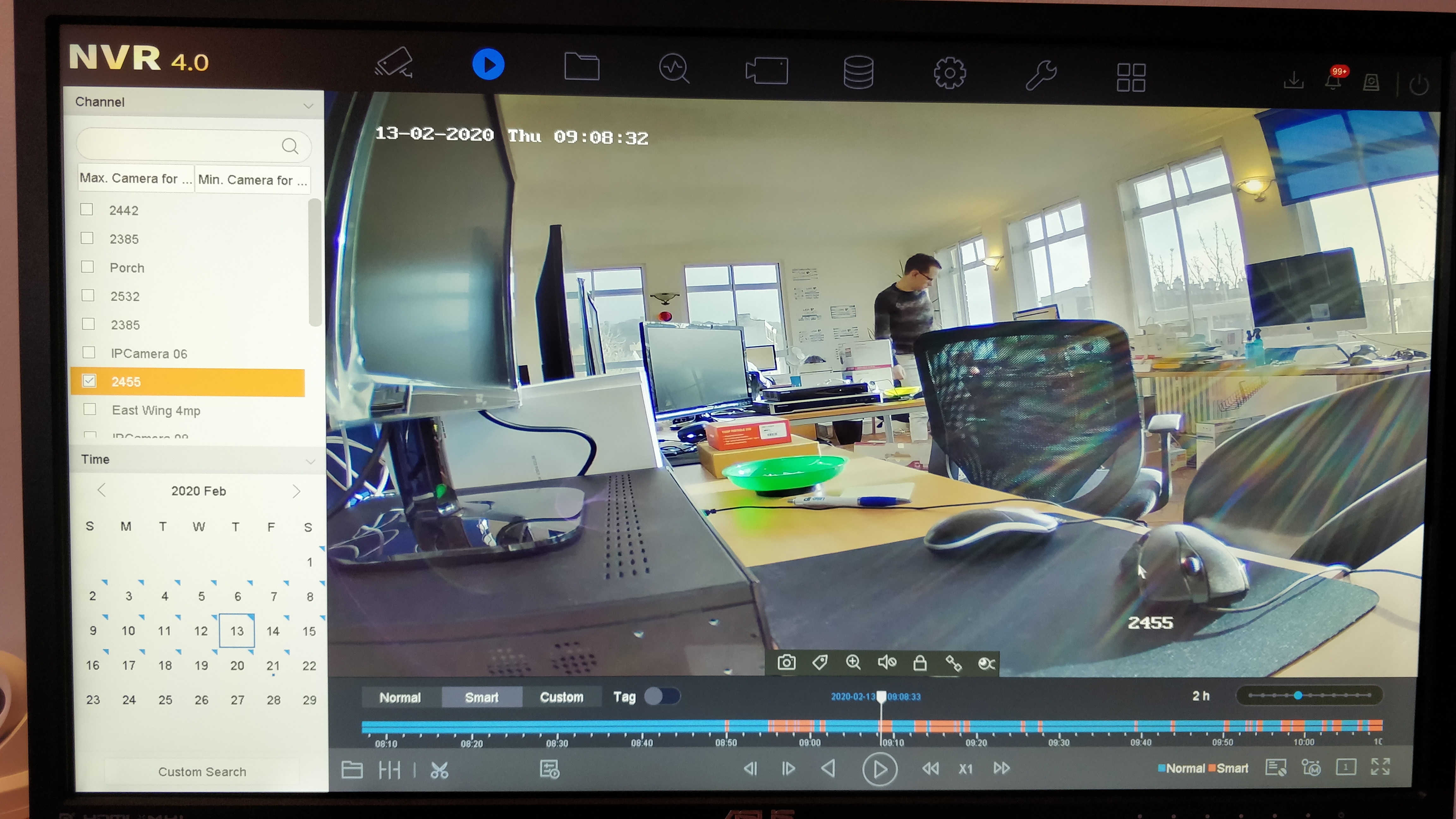

Thank you for explaining your further testing, but from our own testing I can confirm that you will find the event markers of basic & smart events you have set for each camera under the Smart Playback option. If you look at the screenshot below you will see the motion detection markers for a 2455 Cube camera and this is with motion set to cover the whole scene and dual-VCA enabled.

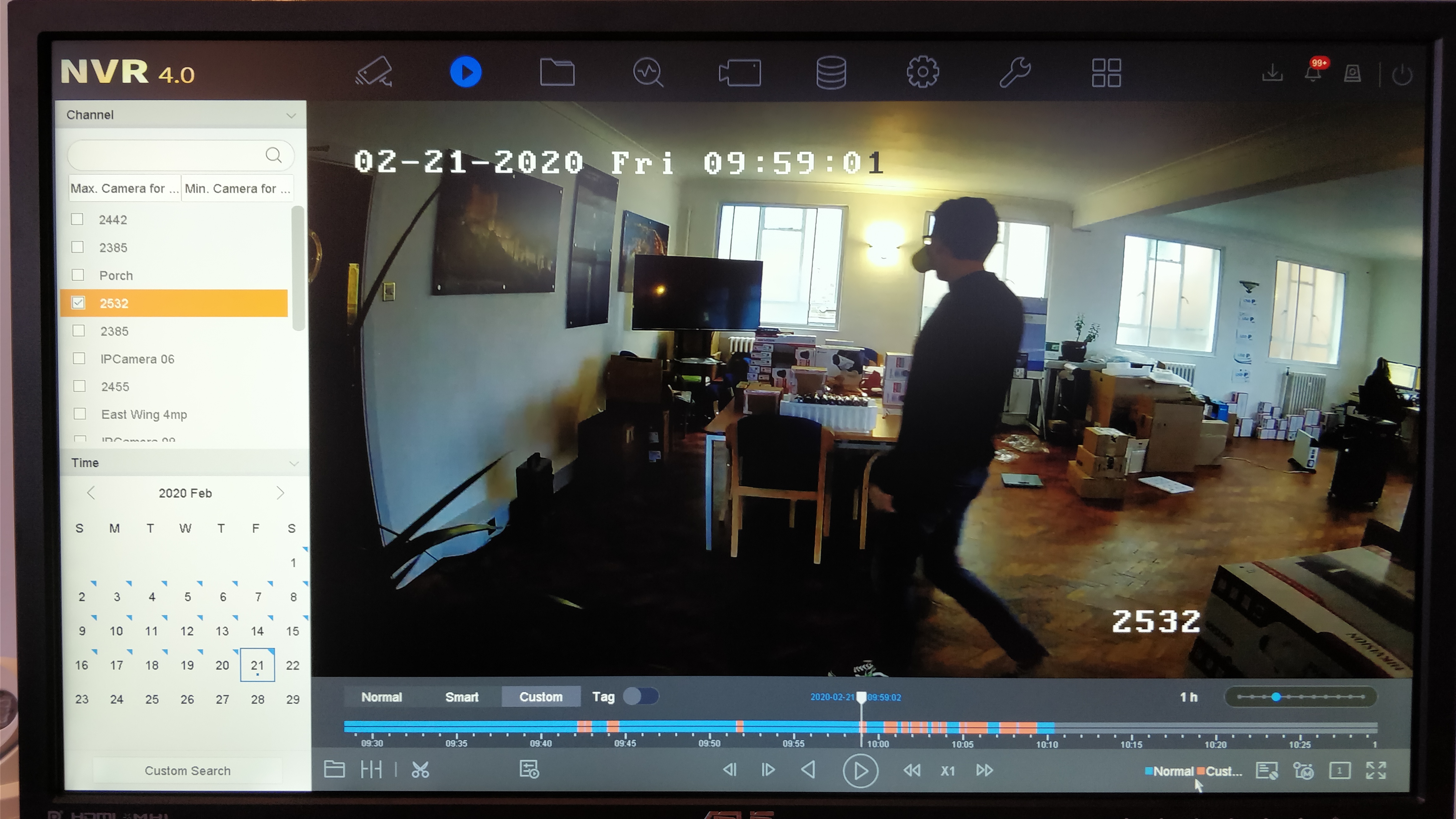

The only time we saw any issue with Event markers in Smart Playback was when trying to view events from older generation cameras (2532, 4A25, 4A85, etc...) which I think is simply a compatibility issue between the old software of these models and the new NVR firmware, but it is still possible to display the events of these models on the timeline using Custom Search/Playback. (see below line crossing markers from a 2532 using Custom Search)
